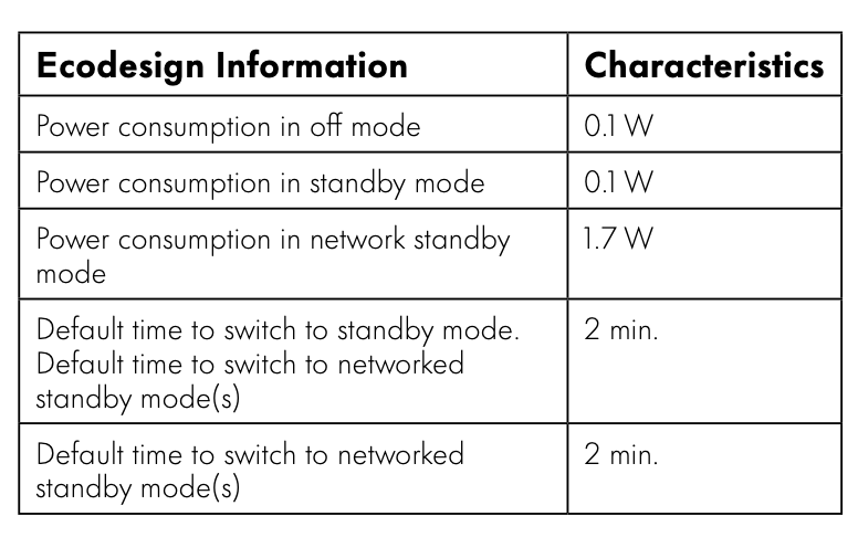

Been digging into M11-D power behavior (Same as regular M11) and a few things worth knowing:
Leica's published Ecodesign numbers show standby draws 0.1W and network standby (Wi-Fi active) draws 1.7W, about 17x more just to keep Wi-Fi alive while idle. Full "on" draw isn't published anywhere, though the manual does note the power supply must be able to deliver at least 8.5W when the camera is on (vs. 4.5W when off), for charging purposes. That's not a confirmed draw figure, but if it's any indication of scale, "on" power is likely several watts, well above either standby state. So the real battery cost of a session probably comes mostly from how long the camera sits fully "on" between shots before Camera Standby kicks in.
Camera Standby options go up to 60 minutes, but longer isn't automatically better. Since standby draw itself is tiny regardless of when it triggers, a shorter delay means less time spent at full "on" power during real pauses.
For geotagging, Leica's Eco Mode keeps Bluetooth on whenever the camera is on, with Wi-Fi only firing up when you actually connect through FOTOS. Geotagging itself only needs that Bluetooth link, confirmed in Leica's own firmware release notes, so it shouldn't require Wi-Fi at all if you're in Eco mode. This matters since Bluetooth LE draws very little power compared to Wi-Fi. Curious whether the M11-D's "Con" setting maps directly to this Eco/Performance split, or if it's controlling something else entirely.
I'm currently running Wi-Fi off, Camera Standby at 10 min. For reference, I ran the M-D Typ 262 at 10 min for years with zero missed shots. On the M-D this can't be changed.
Curious what you guys come up with and why: What Camera Standby time are you running, and why did you land there? Do you leave FOTOS connectivity on all the time or only when needed? Any real battery numbers from your own testing would be great too, since Leica doesn't publish much beyond the basics.

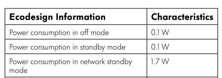

Thanks! I think Leica defaults to 2 minutes, but it can definitely get annoying while shooting.
If you keep standby enabled, you don't even need to switch the camera off to conserve power. According to Leica, both modes draw essentially the same negligible amount of battery (around 0.1W).
Network standby mode (wireless communication On) takes about 17 times more power than standby according to Leica. See below:
