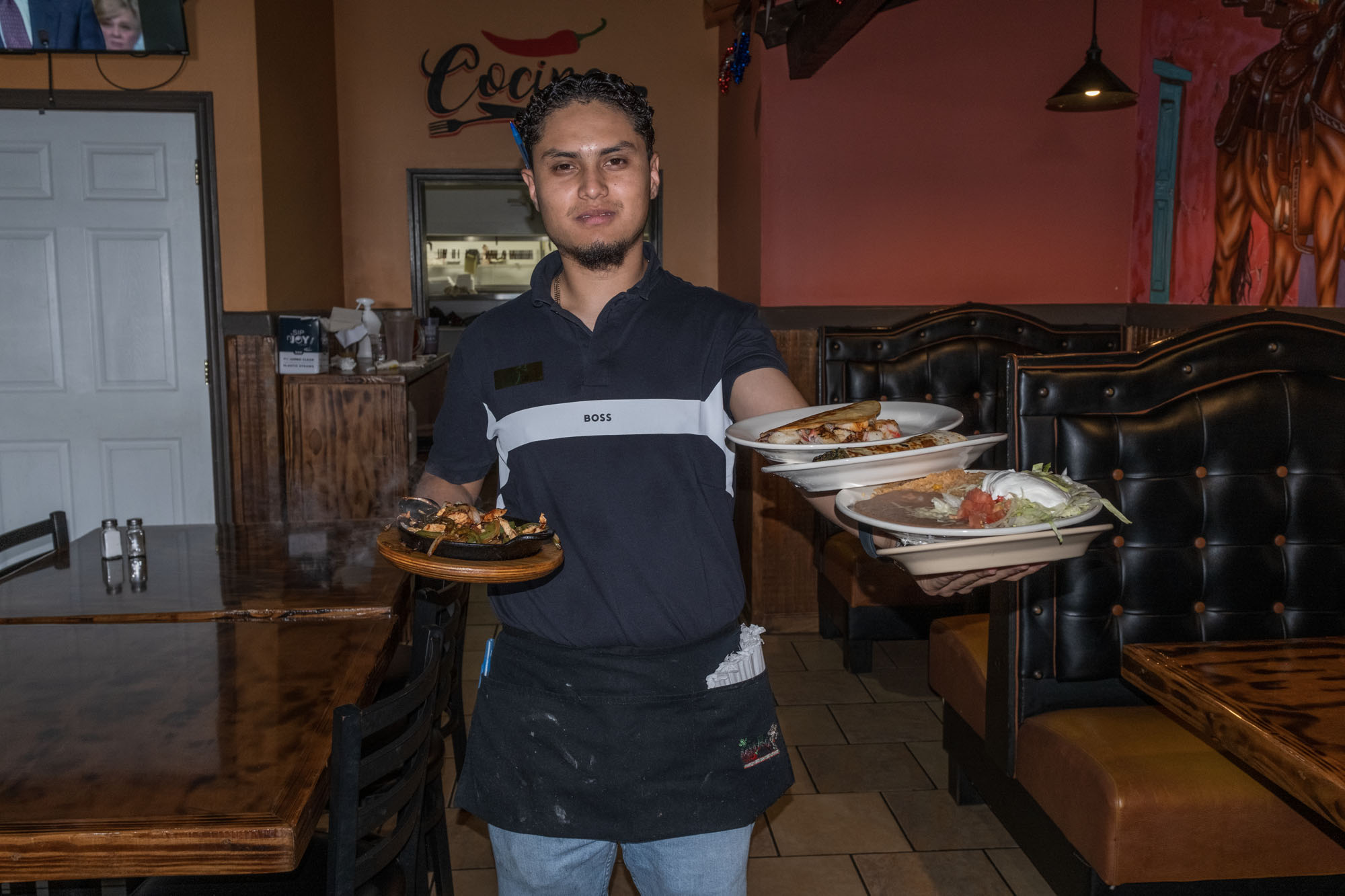

Today at lunch at our favorite Mexican restaurant I got this photo of our favorite server. I always ask, and if I have permission, take a photo of our servers and then take them a 4x6 print on our next visit. I'm known in our small town as the old man who always carries a camera. Those of you in big cities may not have the same opportunities I have.

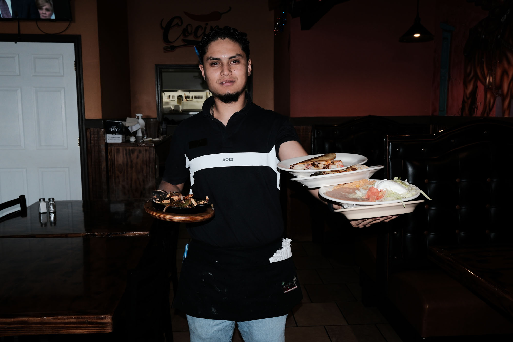

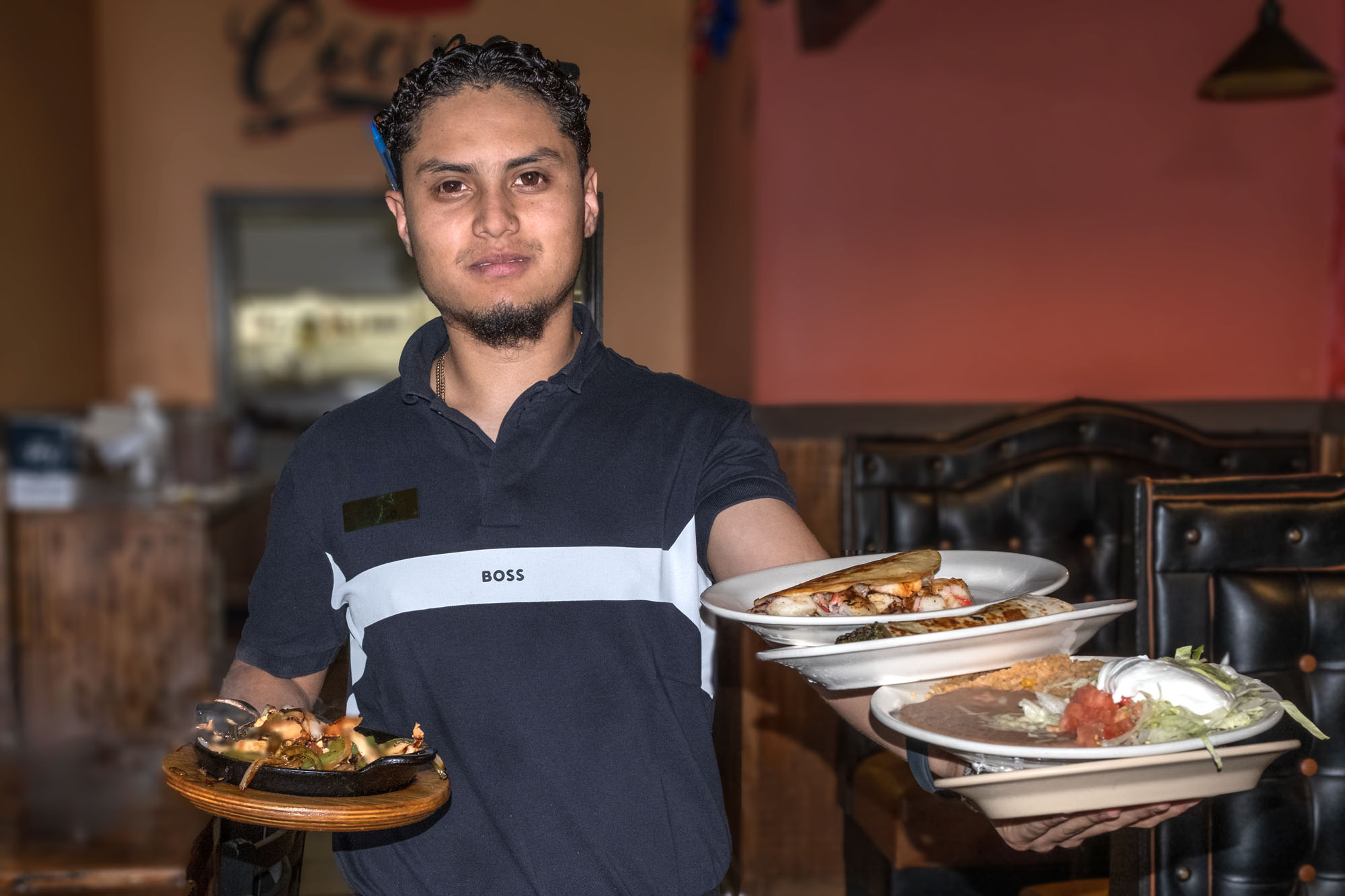

I had my X-T50 set to ISO 800, f 5.6, 1/60th sec and TTL for the flash. The first image is the jpeg image straight out of the camera. The second one is the RAW conversion using PhotoShop Elements 2025 straight out of the camera. The third image is the RAW image sized to 4x6 and post processed.
I honestly think you're lifting shadows too much here. You can get something way more natural looking by either bumping up the iso more or losing like a stop on the aperture. Also my shutter speed usually isn't this low unless I'm in a theater. What lens are you using? gaopa wrote:
JadedSriter said: I honestly think you're lifting shadows too much here. You can get something way more natural looking by either bumping up the iso more or losing like a stop on the aperture. Also my shutter speed usually isn't this low unless I'm in a theater. What lens are you using?
Thanks for your suggestion. I'm using the 16-50 kit lens.
Yeah definitely look for a more balanced middle ground. I do this type of stuff a lot and I'd feel I'd run into some complaints delivering this. I normally use either one of the 1.4 primes or the Sigma 17-40 for indoor flash work just to have leeway regarding exposure:
Yeah it takes years of experience just working in god awful rooms to get the flow of it. gaopa wrote:
