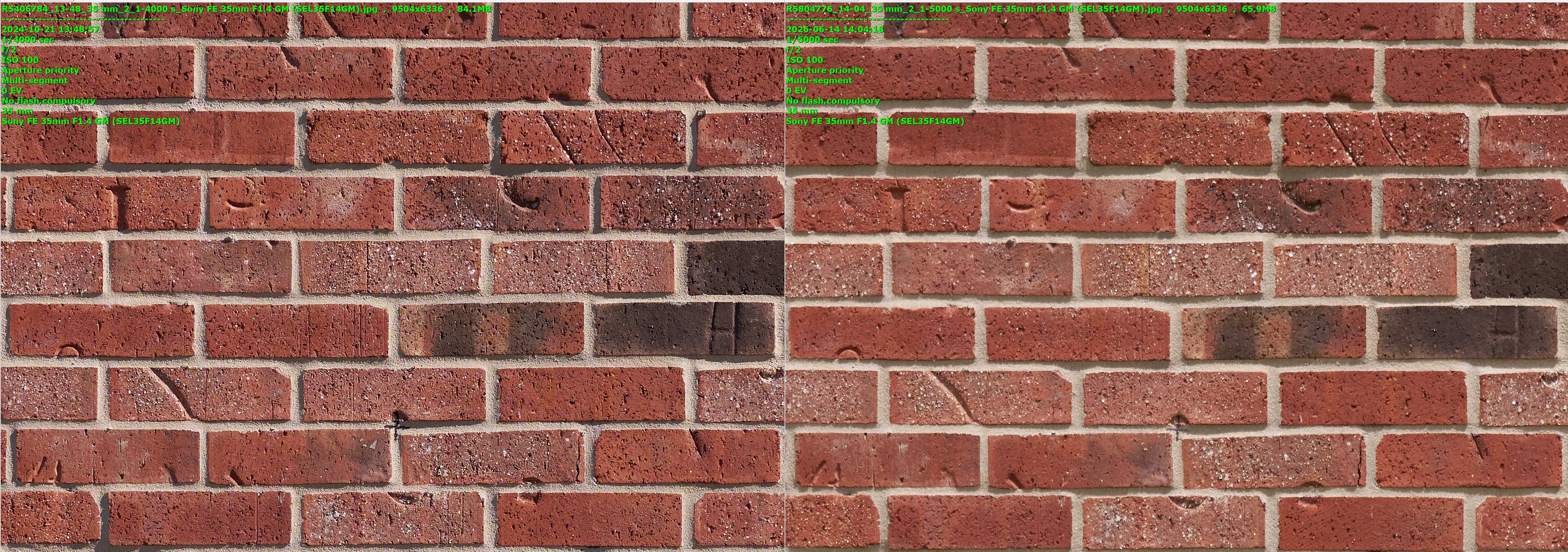

I was shooting the 35GM wide open today and noticed it looked a bit soft. Stopping down improved significantly, but this lens has always been a razor wide open. Doing a search raised a question about if the lens had been dropped. I did drop the camera with I think the 35GM from about a foot onto concrete this winter. It all looked fine at the time, not even a scuff. I will have to review my shots to see if this is the first time I have used it wide open since. That day I was shooting landscapes at f/5.6 or higher.
Assuming this is from a bump. Where would I send it for repair?

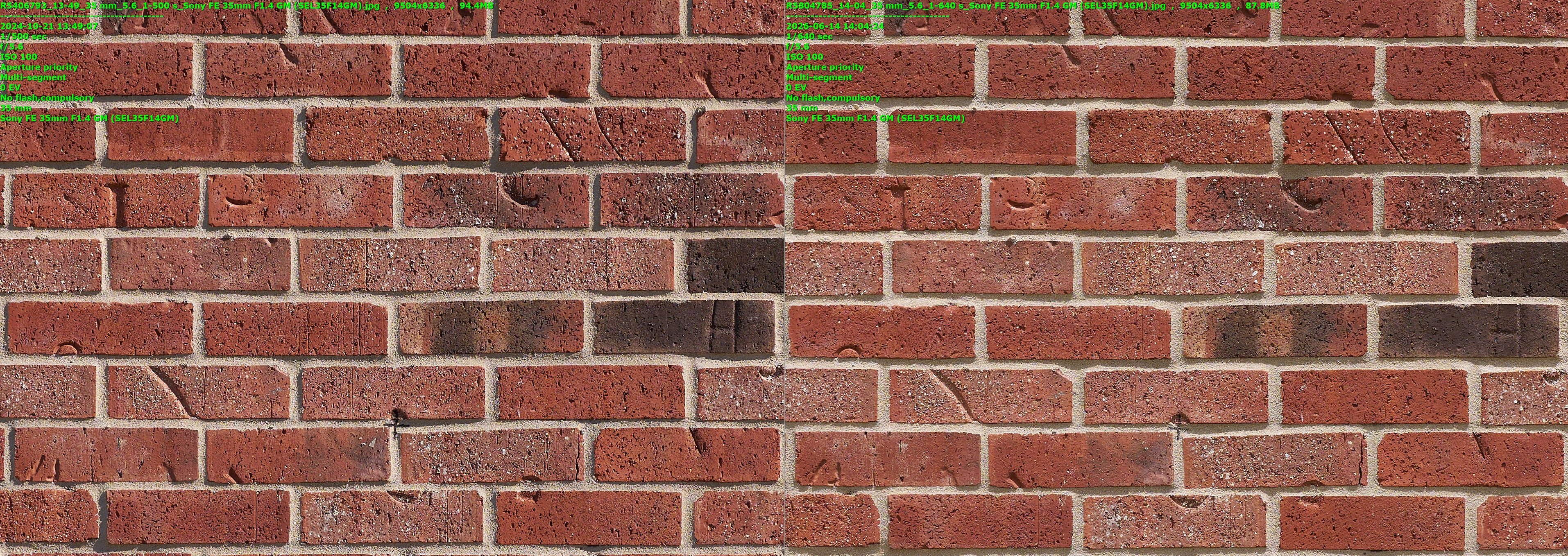

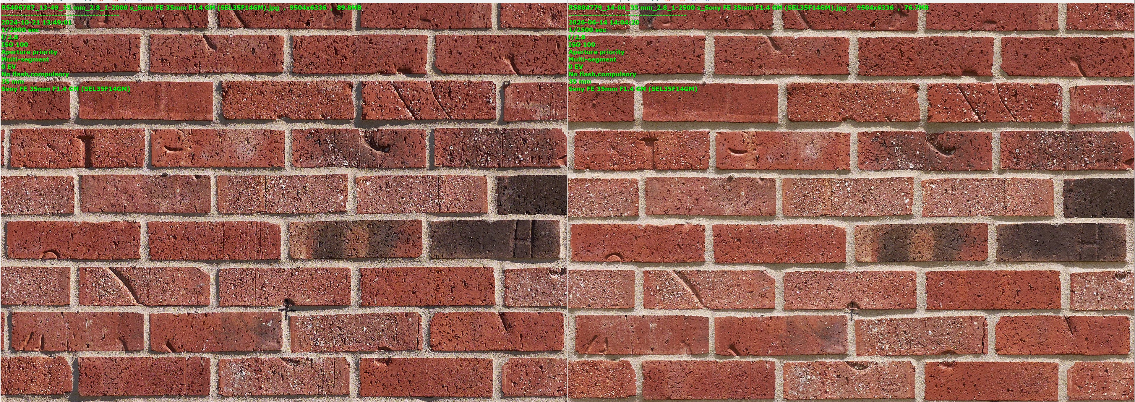

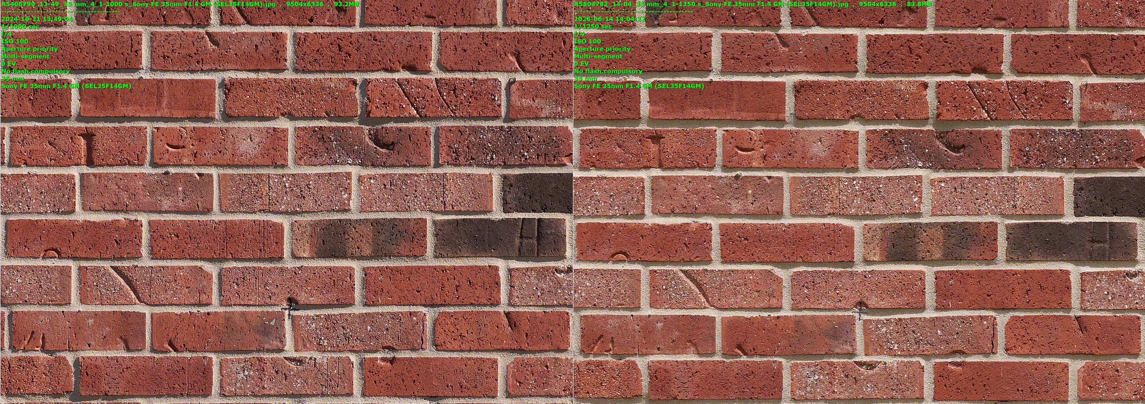

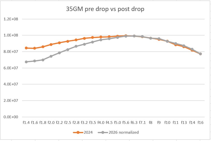

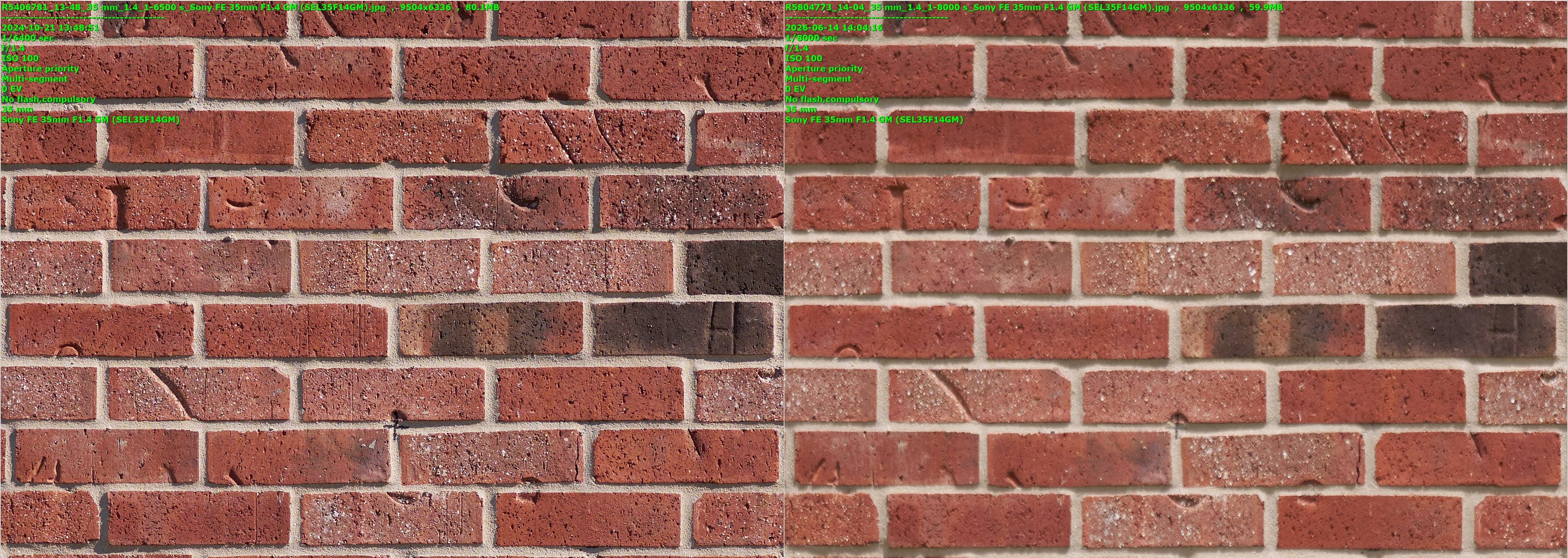

Update: had a chance to take some test shots. Clearly something happened to the lens. By f/5.6 I think it is pretty close to original. The reference shots were taken in Oct 2024 on an extreme clear sunny day. The angle of the sun increases the length of shadows. Post drop shots from today, sun was between clouds. Bright clouds reduce contrast and shadows are shorter, but otherwise same setup. The + on the wall is the center of the frame, this is a 100% crop on 60MP.
quantitative sharpness data from the files
f/1.4
f/2.0
f/2.8
f/4
f/5.6

do you have any examples ? I have this lens too, mine is quite sharp wide open

Samples will help us to answer. The 35 GM is extremely sharp wide open.

I’m traveling till the weekend. Will post some examples when I return. I also have some brick wall photos I shot when the lens was new.
It was soft enough I was trying to figure out if the focus was off or a smear on the lens.

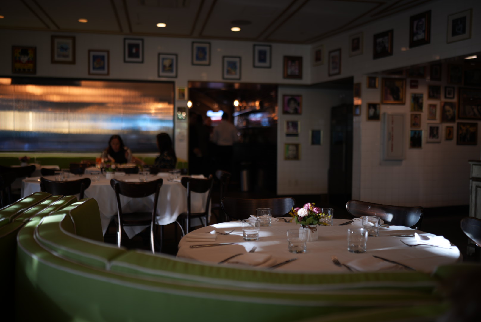

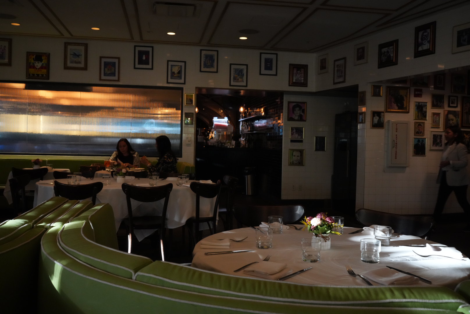

Low res photos from imaging edge.
Focus on the far glass nearest table
  ILCE-7RM5    FE 35mm F1.4 GM lens    65535 lens    35mm    f/1.4    1/30s    100 ISO    +0.7 EV
Focus far glass nearest table.
  ILCE-7RM5    FE 35mm F1.4 GM lens    65535 lens    35mm    f/8.0    1/80s    5000 ISO    +0.7 EV

A faster shutter speed may be needed. 1/30 sec at f1.4 might cause a little blur considering the other one you shot at f8 at 1/80 sec. is a safer shutter speed. I would start there.

The background in the top half of the f1.4 picture seems more out-of-focus than it should be, like an element is tipped. Can you see anything going on with the elements when you look into the lens?

To test the sharpness of your lens, if at all possible I would want to be shooting at least 1/200s shutter at ISO 100 with IBIS turned off. I am not saying you cannot test in less light than that (especially if using a tripod), but if the point is to test the sharpness of the lens, I would want to try to make sure I had removed as many other potential causes of a non-sharp image as possible. I would not be quick to conclude anything from a shot taken at 1/30s shutter (although if it was taken on a very stable tripod then I guess I might).

I second this, I would do a controlled test and also provide a close crop of the focus area so we can see better

I don’t see anything wrong looking in the lens.

I first noticed the issue outside at high shutter speed. At first I was thinking the focus was off. I’ve had the lens for years and this seems like a noticeable change. I will take a series of shots of a brick wall on a tripod. That will tell for sure. I have images of that wall shot when the lens was new. That will have to wait till I get back this weekend.
