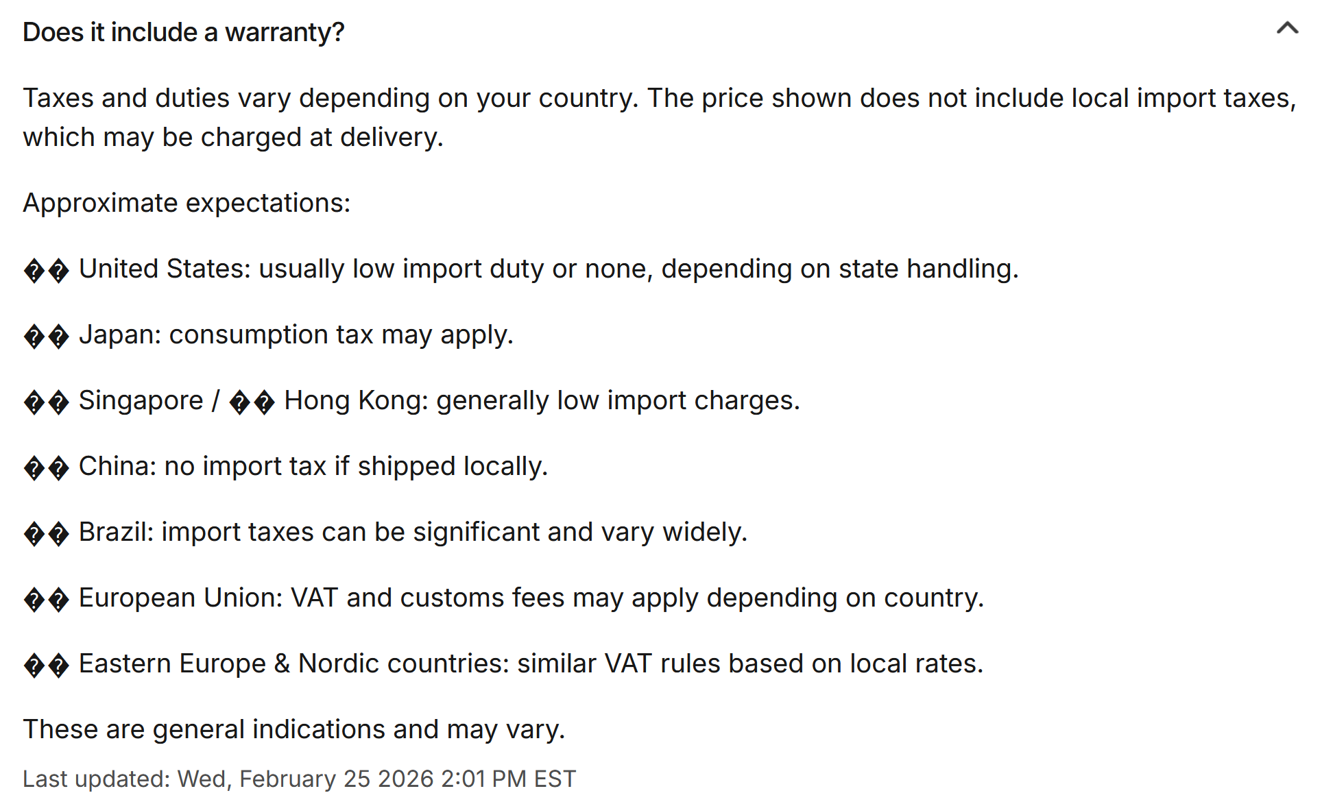

If they can connect the physical shutter mechanism to the back, it would be a great way to swap out the haptics side of the experience with whatever film bodies.
But their warranty section is sketch so probably won't get this.
