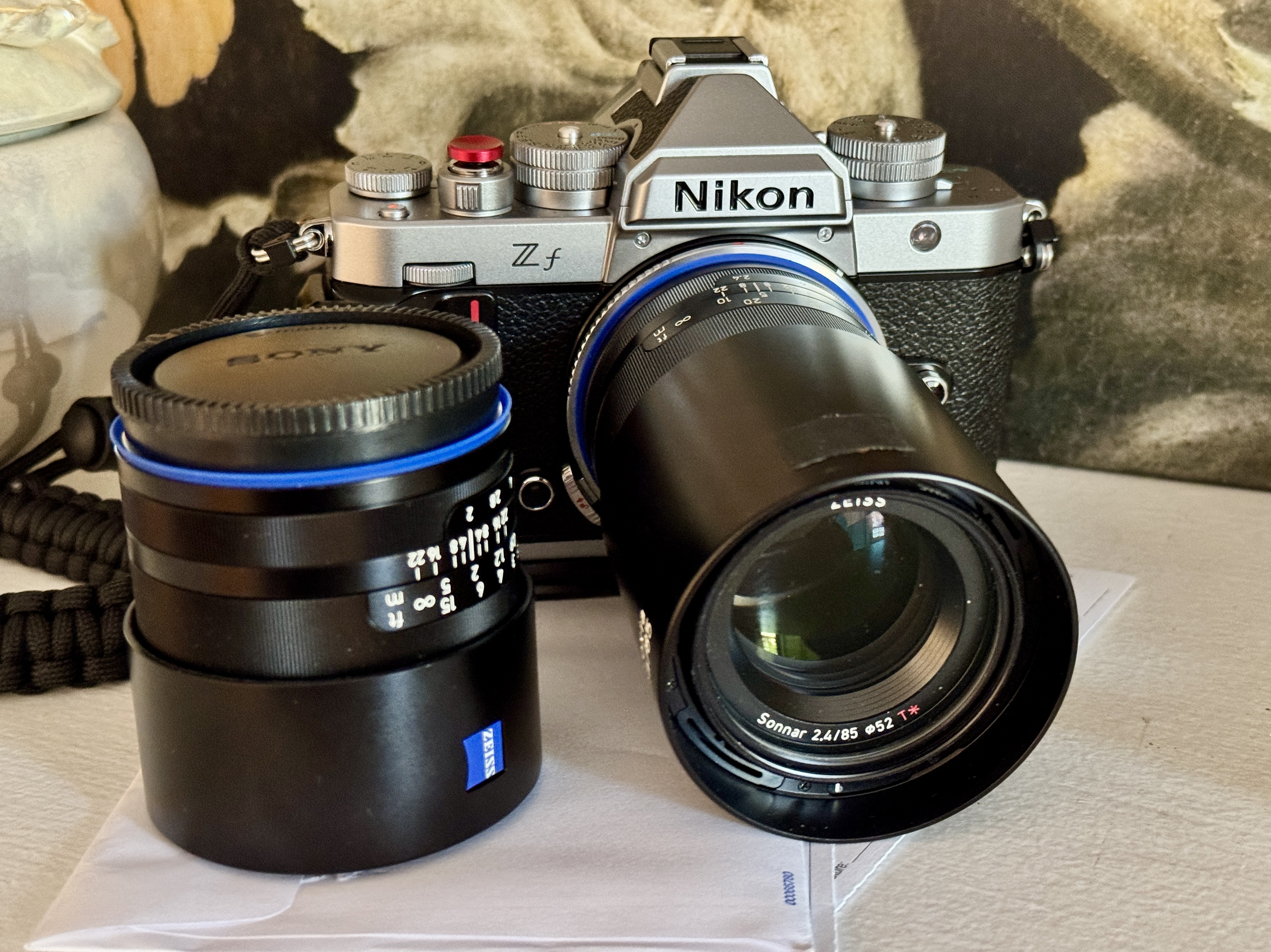

Manual focus lenses work extremely well on the Zf. The green focus box is a great aid and it has made manual focus genuinely enjoyable for me. I still need to do more testing during the day, but at night the green box can get a little jittery with the Loxia lenses when the scene has low contrast.
The only Loxia that gave me noticeable trouble was the Loxia 50. The green weather seal on that lens feels thicker and more substantial than the others, and when the lens is mounted it looks like the seal is getting slightly pinched. It also makes the lens harder to mount compared to the rest of the Loxia lineup.
Adjusting to Nikon’s mounting direction is another learning curve. After years of using Sony, the clockwise motion to unmount and the counterclockwise motion to mount still feels reversed to me. I am sure I will get used to it, but for now it takes a moment of conscious effort each time.
Nonetheless, Loxia lenses feel well balanced and visually great on Zf, including the oddly long 85.
