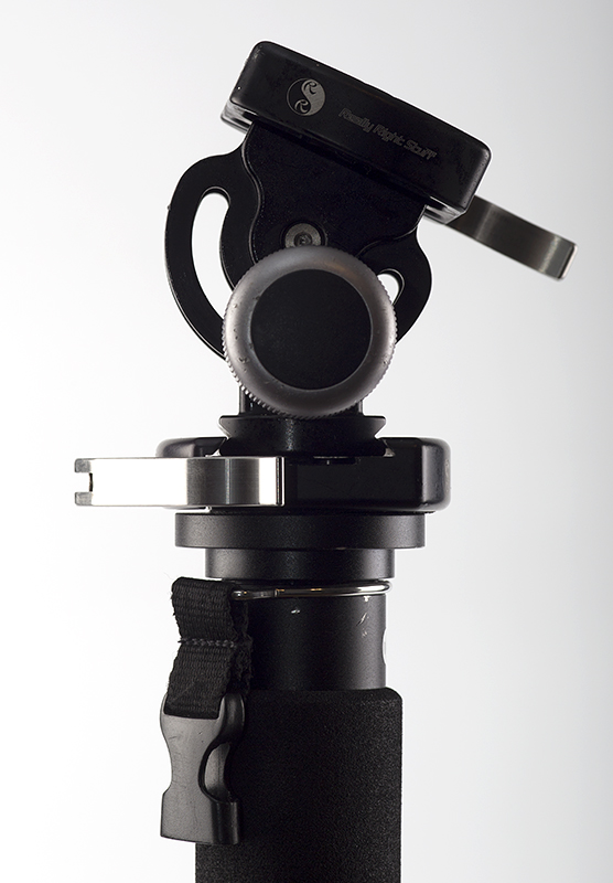

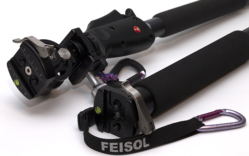

p.1 #5 · Monopod head
I have the MH-1 with an A-S plate on the bottom. It mounts on either my Manfrotto Neo-Tec monopod (one-handed action, but long & heavy) or my Feisol CT-3441S (light & strong). Both of these monopods have A-S clamps on top, so I can mix & match.
© jcolwell 2004-2026
RRS MH-1 monopod head clamped on Neo-Tec monopod, beside Feisol CT-3441S with A-S clamp
RRS MH-1 monopod head on Feisol CT-3441S

You can mount most anything on the MH-01 or MH-02. I use the screw A-S though.
