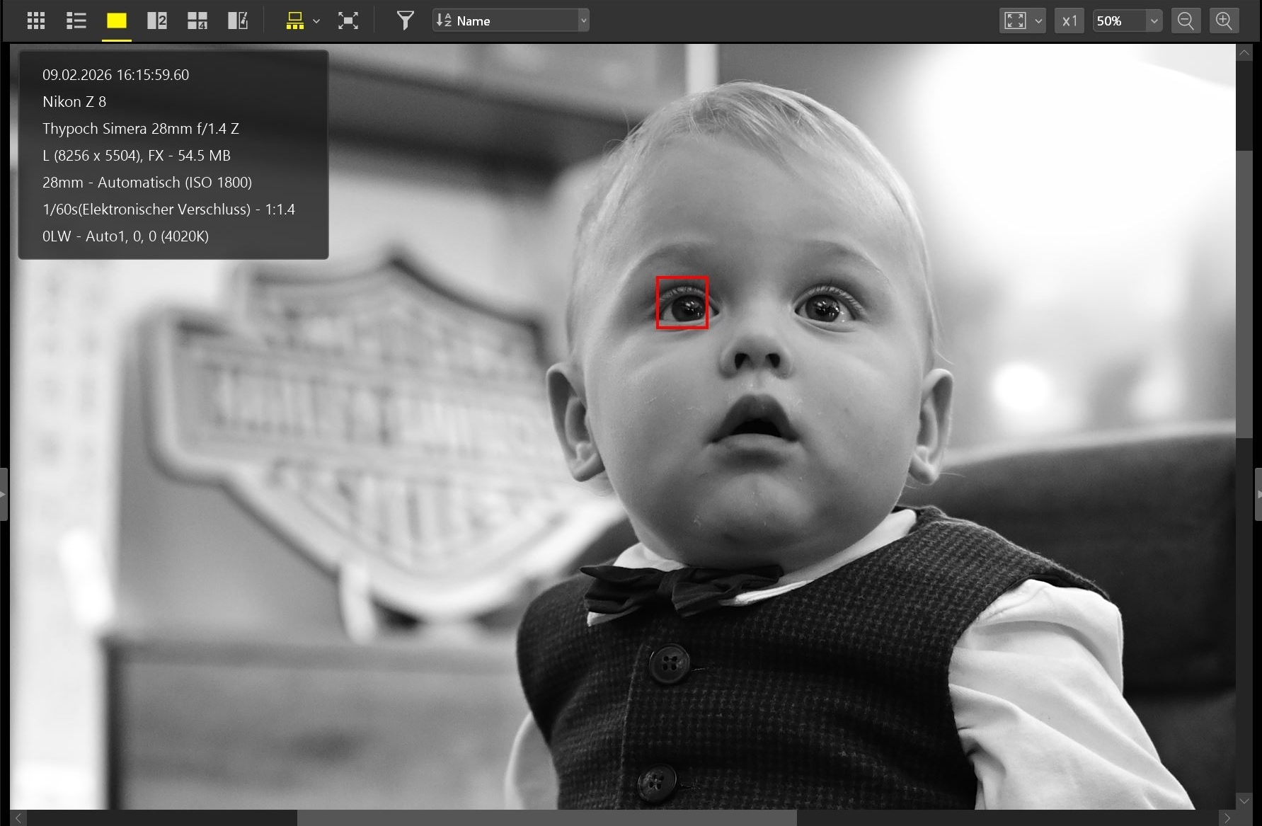

Vento
p.1 #5 · MF lenses - Subject Detection function?
To better specify focus aids, as these encompass more than just focus confirmation.
Manual focus subject/face/eye detection also works with non-CPU lenses.
Magnification also zooms directly onto the subject/face/eye when it is detected.
So there are no differences between chipped and non-CPU vintage lenses regarding mf subject detection, except for focus confirmation, which requires chipped lenses or certain smart adapter solutions.
The magnification modes and focus peaking also work the same way with non CPU.
Only focusing aid which remains inactive with non-CPU/dumb adapter solutions, is the focus confirmation via green frame, green dot.
This is what it looks like when MF subject detection has found an eye.
You can choose between three fields in which MF subject detection is active: Wide S, Wide L, and All.
This means you can selectively set MF subject detection to a smaller field, direct it, or have it scan the entire image area.
In this example, All was selected and the eye was easily found, framed by the eye detection, and magnification (when activated) was aligned to the eye.
The focus box frame remains red when not CPU-controlled, as in this case with a Thypoch Simera.
Edited on Mar 04, 2026 at 03:39 PM · View previous versions
Mar 04, 2026 at 03:30 PM

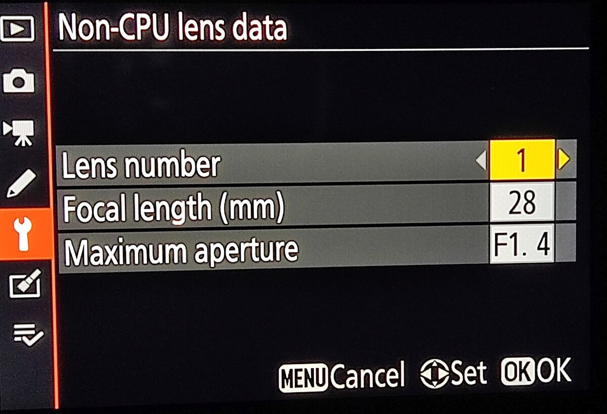

Vento
p.1 #7 · MF lenses - Subject Detection function?
All Z-bodys, including the first Gen, do have a option called "Non-CPU lens data" in the Setup Menu with the following input fields.
Here you can enter the specifications of adapted non-CPU lenses, which activates 3-axis IBIS.
After that, you simply select the appropriate lens/lens-number from the list, the one you've adapted.
As long as the lens data has been entered correctly and the correct number/lens has been selected, 3-axis IBIS works with any lens/dumb adapter.
It will then also be displayed in the EVF/LCD, provided the information has been selected for display.
Nikon Recall Shooting Function (Z8, Z9, Z6III) allows instant switching to pre-configured camera settings—such as mode, aperture, shutter speed, and ISO—using a custom button.
This would allow you, for example, to assign a hotkey to an action emergency setting, where pressing the hotkey recalls a pre-configured setting.
This is rather unimportant in manual focus photography with non-CPU lenses, so you're not missing much.
These are mostly minor details.
For example, with the Z8, spot metering or other exposure modes cannot be assigned to a hotkey.
You can assign exposure measurement to a hotkey in general, but then you still have to select it using the dial.
If you want to activate spot metering or another metering method instant via hotkey, you can only do so via RSF/RSFH.
This functionality is then unavailable with non-CPU lenses.
Mar 04, 2026 at 03:45 PM
