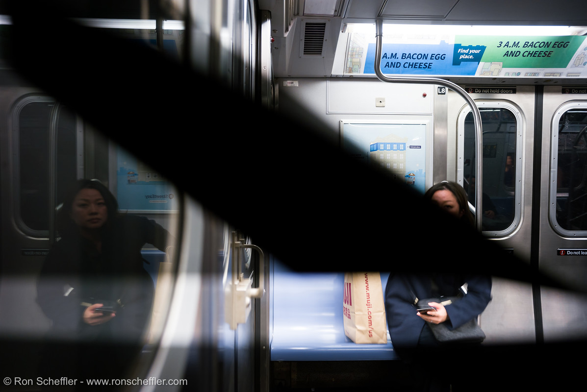

p.1 #5 · Need help diagnosing one-sided vignetting on Leica M262
OffTrail wrote:
This looks like shutter capping. Is that a thing on digital M's?
Yes, but the shutter failure of my M240 was sudden and obvious:
