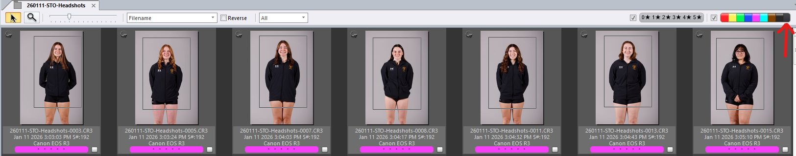

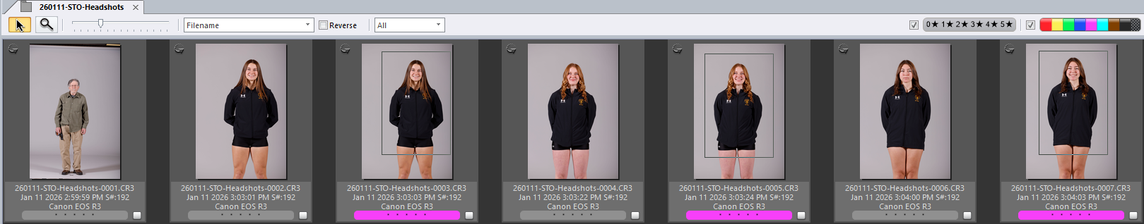

If you are using PhotoMechanic to browse the card, you can use a color to tag those images you want to upload. I use the color that hitting the "1" gives me. When done making the selections, go to the top right of the contact sheet window and click the far right square in the color bar. Only those image will show. Select all of them and upload. Click the far right square again will show all the images.
