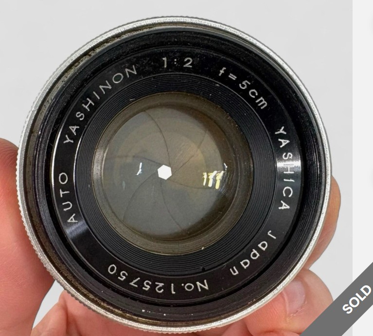

p.1 #1Fixing messed up infinity focus in a vintage lens
Experts/Gurus, I bought a vintage lens (Yashica Yashinon 5cm f2) and only to find that somebody had messed up it's infinity focus. I am assuming they tried to "service" the lens and as part of that messed up the infinity focus.
Is there anyway to recalibrate the infinity focus. I understand the lens need to be ripped apart to do that, but my question is how difficult is that process? I have done this with another vintage lens (not recalibrating, but taking it apart and cleaning) and would not mind taking that road again, but this one seems to be a completely different beast with a cocking lever etc. and with the aperture ring in the front.
Any help, if somebody had been through this path in the past is highly appreciated. I am attacking a photo for reference.
Sreedhar.

Id try looking at the back and see if maybe someone took a rear element out putting it back in upside down. A lot of times you can see marks on the screws if people took it apart and didn't really know what they're doing

Steve, thank you for your response and an interesting thought. I was only thinking from the incorrect repositioning of the focus helicoid, but you provided another perspective. The lens has definitely been serviced based on the markings. It appears that it is in the correct way (the element closest to the sensor). However, you have a very valid point. What I am thinking is there are some adapters that come with helicoids. I want to try one of them (after a mod on them by somehow reducing it's thickness by 1mm or so by filing it) and see if it solves the issue. I am hopeful that should work as it makes it that much closer to the sensor. I have ordered an adaptor and waiting for it now, so that I can do a mod on that rather than the lens itself.

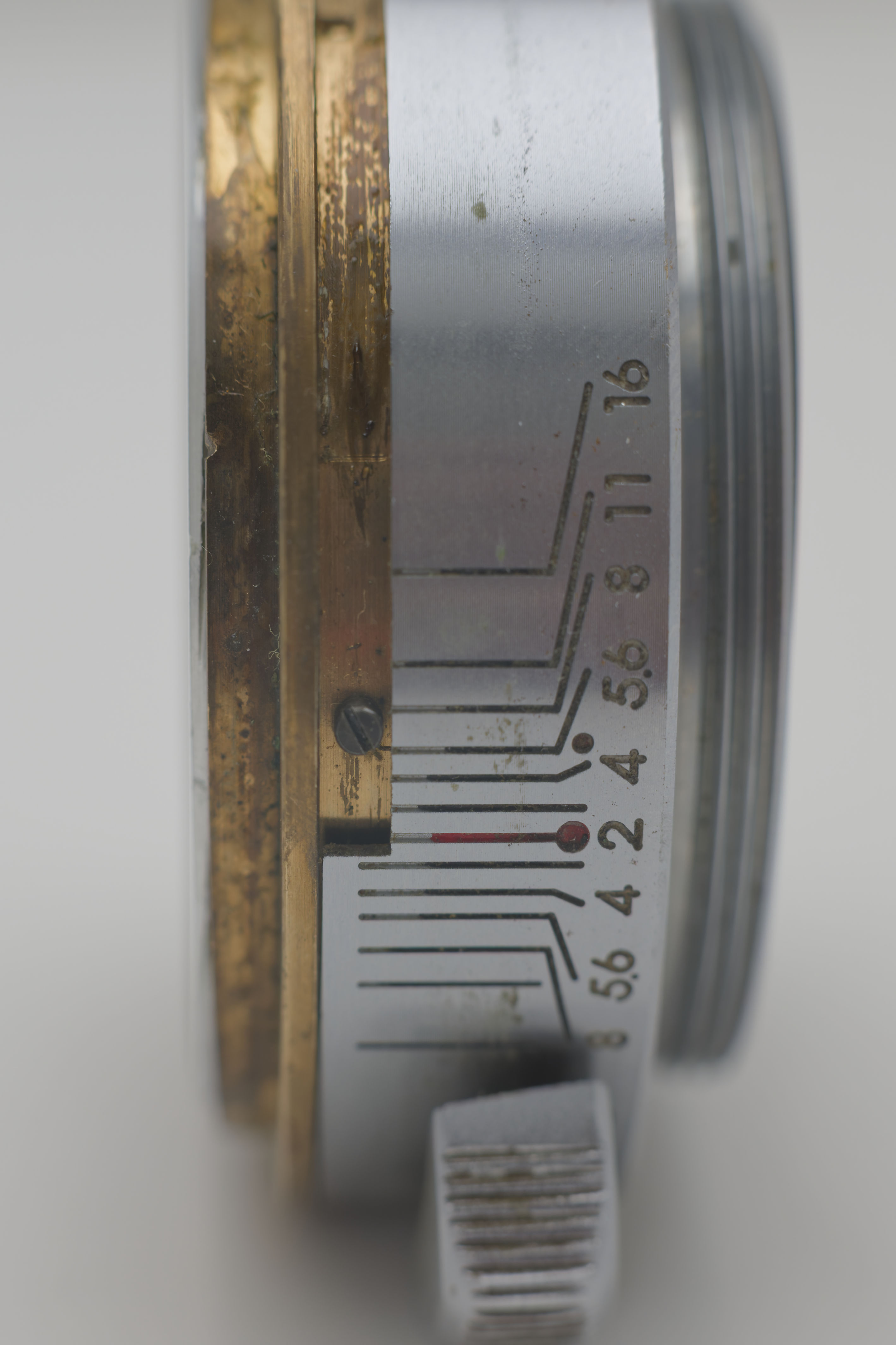

First, I ripped it apart to figure out what kind of mechanism it uses. Its a single screw stopper for infinity. So, I did not have any leverage ( I was hoping it would be multiple pins that I can work around with, but not). After a lot of trial and error I was able to make the focus mechanism work and reassemble the lens. It made only the focus ring smoother but the infinity focus was still a problem.

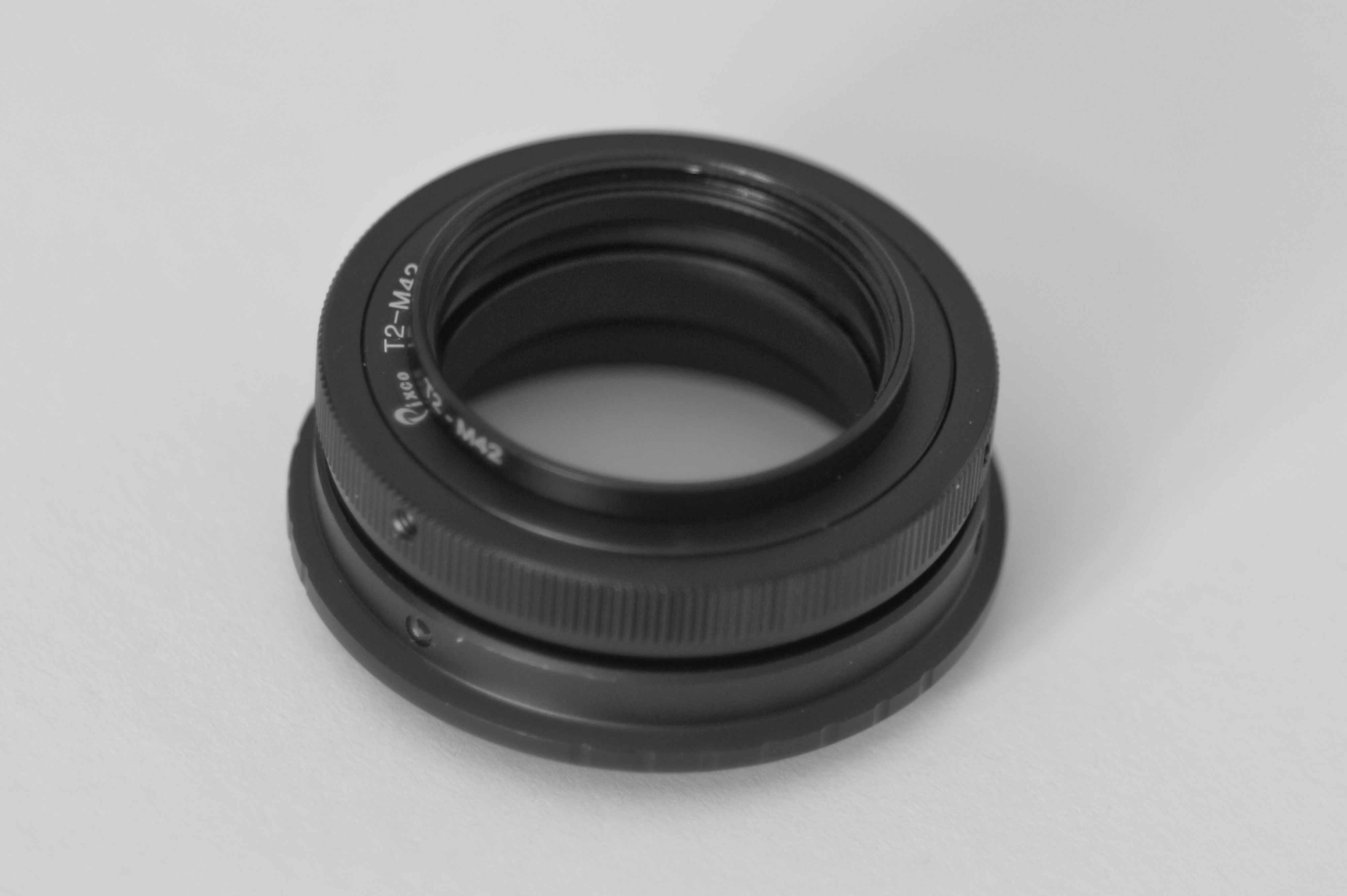

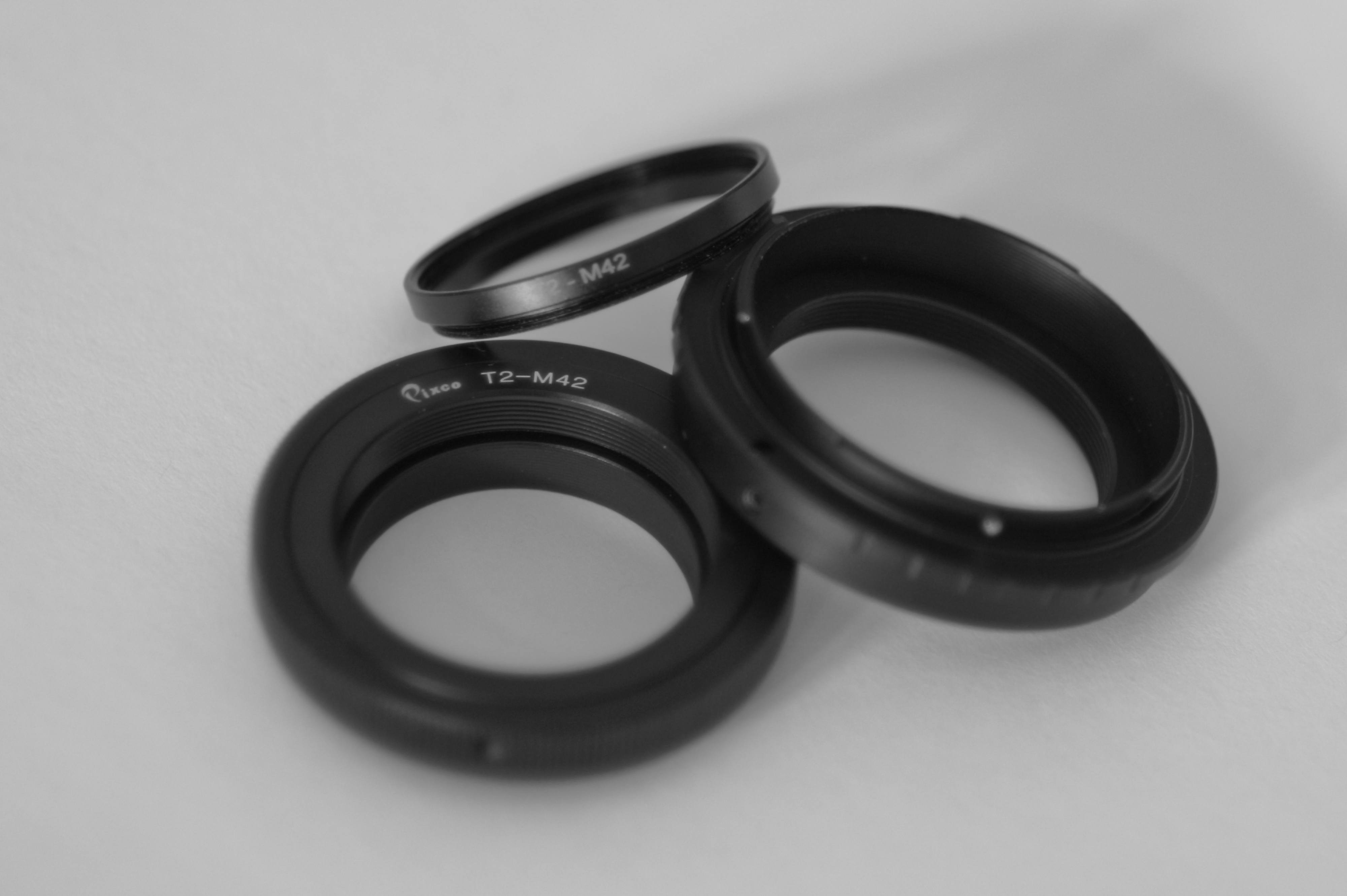

After deciding I can't make it work, took a different approach. Found 3 different adapters to make one adapter. T2 to Nikon Z adapter and a couple of M42 - T2 adapters to make all 3 of them to be a single adapter. That did the trick. Of course, there was a bit of luck in this approach. The total thickness of all 3 adapters brought the flange distance in the range to make the infinity focus work (I was hoping it would and that is what is the luck part). Only caveat is, it was not perfect, the MFD was extended a little bit, but I can live with that.
Posting the solution here, may be this will give somebody some ideas for their problems (or not)!
