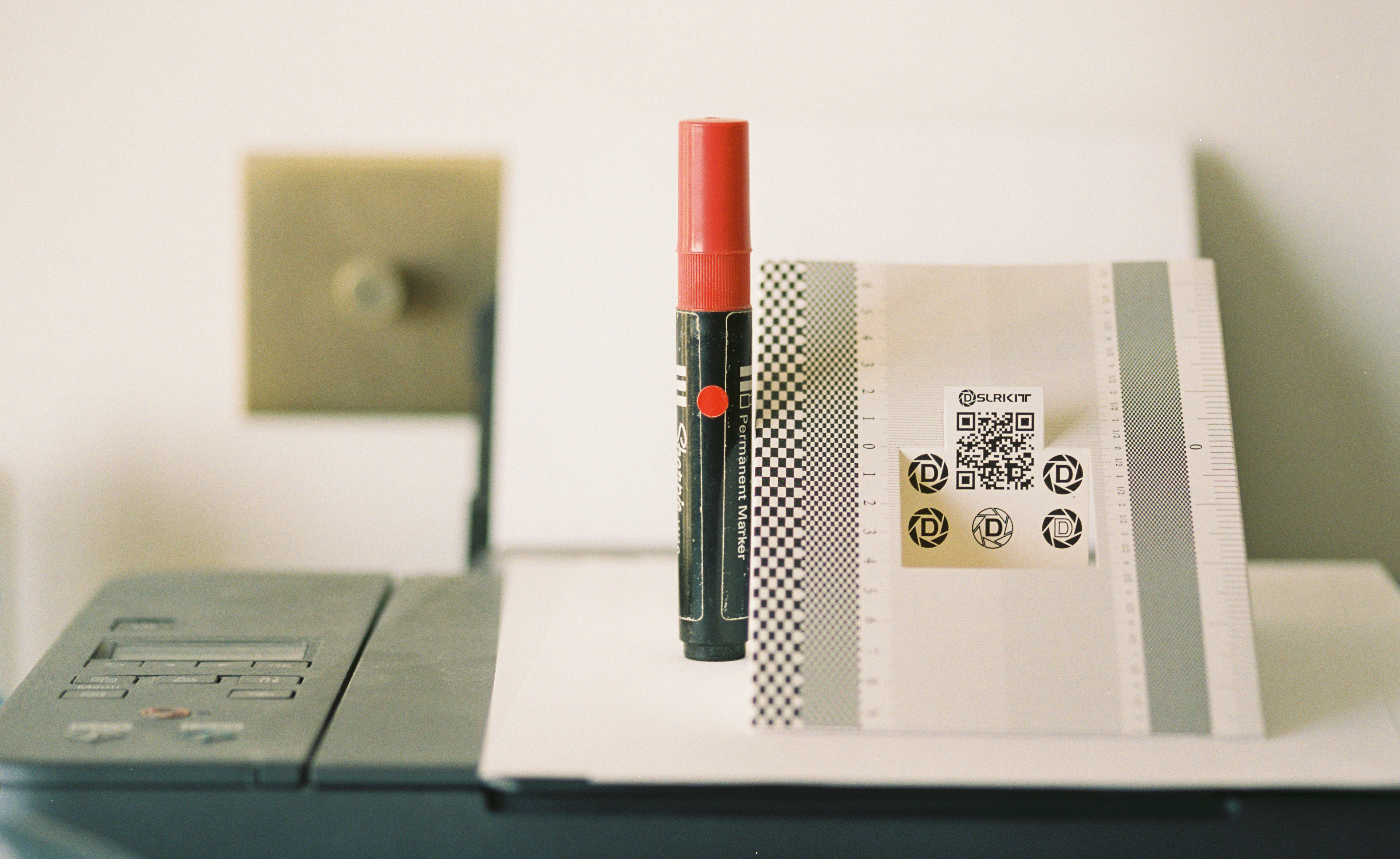

I know there's two screws that you can turn with a key, one for vertical and one for horizontal.
Though I imagine that's harder to test properly with a film camera - except for the infinity focus adjustment.
I read you're supposed to test it both at infinity and close distance... how are you going to do the close distance on film.
A tape measure? It's like calibrating for the lens rather than making sure the camera is right...
I know people use the tape on the back of the film plane, I was doing it last night with the fm2ns and it's kind of a massive pain.
It would be nice to have some ground glass specifically made for this so I can confirm with a loupe more easily. The tape isn't all that well defined. I did see a youtube video about a guy making his own so maybe that's the way to go.
I'm reading people saying something like "never leave home without an m2 allen key", they're joking right?
I often justify the price of a new MP thinking this is the camera for life, I'll take it everywhere.
But if I'm taking it everywhere and a single knock (or vibrations from a car ride) could require a calibration then that's delusional.
I get that in the past perhaps the expectations weren't quite as high overall - but maybe they need to make things a bit more secure nowadays. I appreciate the new phone makers with their rigorous vibration testing.
I don't particularly want to carry a screw driver with me, or make my own groundplane that secures to the back of the camera and take a loupe to check close-focus while out and about
I was reading up on calibration from a place that services Leics, and they talk about epoxying the prism if it keeps requiring adjustment.
Lots of people say they've never had to adjust their camera in decades. But equally as many saying they dropped the camera bag (not even the camera) and it needed adjusting.
Get the MP anyway? Buy some more FM2ns as well and hope they're right? Shoot only at f8? Headaches are a part of life?
They can't weld that stuff in place?
Get some microscope slides and some aluminium oxide 320 grit to make my own ground planes for testing without the damn scotch tape and just buy a bunch of cameras and send back the ones that are off?
But do you need to account for the film thickness...

Use a fully blacked out room and a point light source as your subject. It will form a pinpoint on the tape that you are using as a ground glass, and a point light source against a pitch black background is relatively easy to identify.

Yogifi wrote:
People have been mentioning lenses need calibration even with slrs, but unless zone focussing or talking about the infinity hard stop, it doesn't matter right?
But do you need to account for the film thickness......Show more →

I'll try this next time, thank you. I'm ordering some "magic" scotch tape too, I think mine is some offbrand thing that might not work as well. Tempted to try to make my own ground glass too, I've got some aluminium oxide dust already for some flattening thing for sharpening knives a while back when I was needlessly obssessing over that too. Now I just spend 1 min on 1000 grit shapton ceramic stone. Though it doesn't really fix the nice knives.
I got the Scotch magic tape and it's a lot better than the knock-off tape I was using, but it's still not 100%.
I ordered some small glass slides that I'll try to turn into ground glass with some aluminium oxide powder.
But I'm still using the red dot sticker on a pen. And I just don't know 100% with the scotch tape. It looks good actually with the 105mm macro lens. With the 50 1.4 it seems off...which actually matches what the film results came back as.
Now I don't understand how the lens factors in at all since I'm not using the infinity hard stop for the test nor am I relying on the distance measurements, I'm focussing with the loupe and the tape, then checking on the split prism on a very sturdy tripod and head with precise adjustments to confirm the focus.
I'd like to try the point light source. I tried it with a light bulb but it might be a bit too diffuse. And with my phones torch I wasn't sure how I could confirm focus with the split prism so not quite sure how best to do that as of now.
I'm going to repeat it all again a few times to make sure. I'd like the ground glass so I know it's flat and I can see it crystal clear. I think the glass arrives after the return window closes unfortunately though.
The hard stop is right on my other camera, but not on this one. I don't think it's focus shift, I tested the lens with my Sony and the first camera is really nice now for portraits at f2/2.8. Can't easily focus stopped down with the fm2n...I mean you can hold the dof preview while focussing but that's a pain.
Like how could it be so far off in most of the test roll. But okay with the 105 macro in close range.
I focussed with the split prism on the purple arrow:
How could it be that far off in some of the photos and only a little in others, or fine.
First image I took with the 105 macro on this second camera, and the test today with the loupe suggests it's still okay too.
But not with the 50 1.4 or 35 1.4.. Not the hard stops on this second camera. I'll recheck the 105 at a tree tomorrow in the distance.
It can't be the lenses if I'm not using the distance scale/hard stop, right?
So either my focussing is ridiculously bad if I hit closer to the green arrow when I focussed on the purple. Or I'm doing something weird after pressing the shutter... or there's variation day-to-day with the seating of it all. Or I don't know what.
I'm using a -2 diopter, that shouldn't affect anything, right?

p.1 #20 · Focussing accuracy question, 35mm SLR vs Rangefinders?
Honeslty I don't know what's going on with this second one.
I did the tape + loupe again, it seemed sometimes okay, sometimes a tiny bit off, depending on what lens, how I stretched the tape, but it was close, sometimes spot on. The glass to make the groundglass thing properly doesn't arrive until after the return window unfortunately.
I thought maybe the reason the first part of the roll came back okay then the next shots (which I took 2 weeks later) were way off is because it got some slack that I didn't rewind. It seemed to clear up a little bit near the end.
So I did one more very fast roll today, and basically every shot was front focussed with only 1 shot that seemed okay.
I was really careful, I took out slack, I shot at high shutter speeds (over 1/125 or faster on a 35mm lens). Focus is on obvious subject or text in the center:
way too optimistic with the banana placement for focus check ^
I checked focus shift with the 35mm f1.4 AIS on a digital camera and I don't see any, though I checked at closer distance.
One shot that looked like it was in-focus, that I'm guessing I either actually messed up, or something shifted - though I don't know how because the prism is basically crushing the focus screen on this body:
Not reliable enough.
I'm just going to send it back, it had enough problems with not matching the listing condition already but mechanically felt really nice and fresh. Pray I don't get screwed by the seller. I'll make sure my first fm2n is actually reliable with multiple rolls before getting a 2nd body in top top condition.
Or just going straight for the MP if the first isn't consistently reliable either.
