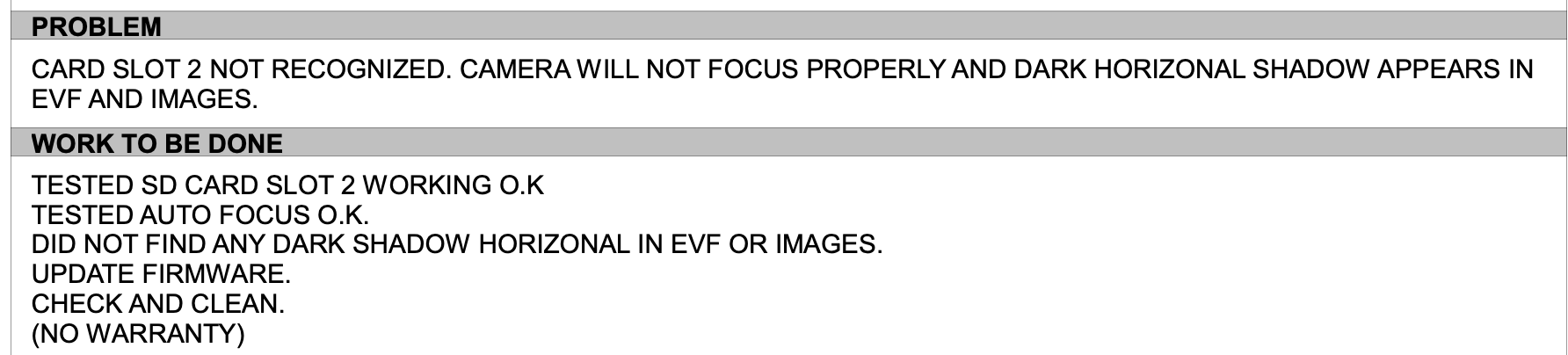

Imagemaster
p.1 #15 · OM-1 MK II - second card slot
I just got my camera back today, after they had received it on Jan. 28. They could find nothing wrong, and did not answer my questions as to how many times they tried inserting and removing a card from that slot, and no answer as to what could have caused the AF and shadow problems.
Communications from them was slow and inconsistent. Even though they are the OM repair company for Canada (Sun Camera Service), I would not use them again, nor recommend them.
Camera worked fine when I tried it today.
Feb 20, 2026 at 11:16 PM
