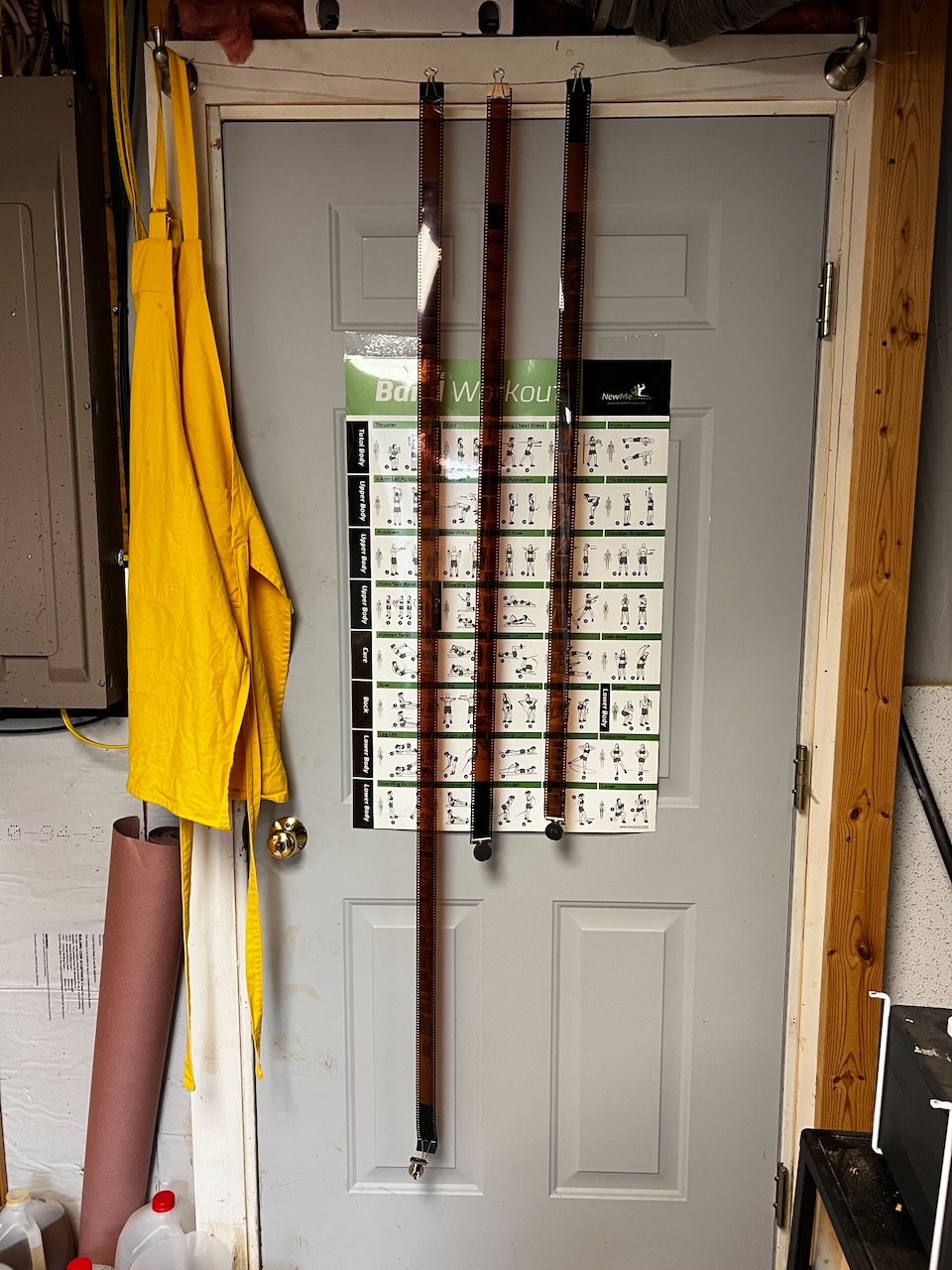

p.1 #11 · How Do You Dry Your Negatives?
I develop and dry my film in my furnace room in the basement. I use stabilizer or photo flo as appropriate. Rubber squeegee the film and hope for the best. I place a running humidifier near the base of the film (just out of view in this photo) with the emulsion side facing the humidifier in hopes the film will dry flatter. Works well enough.
