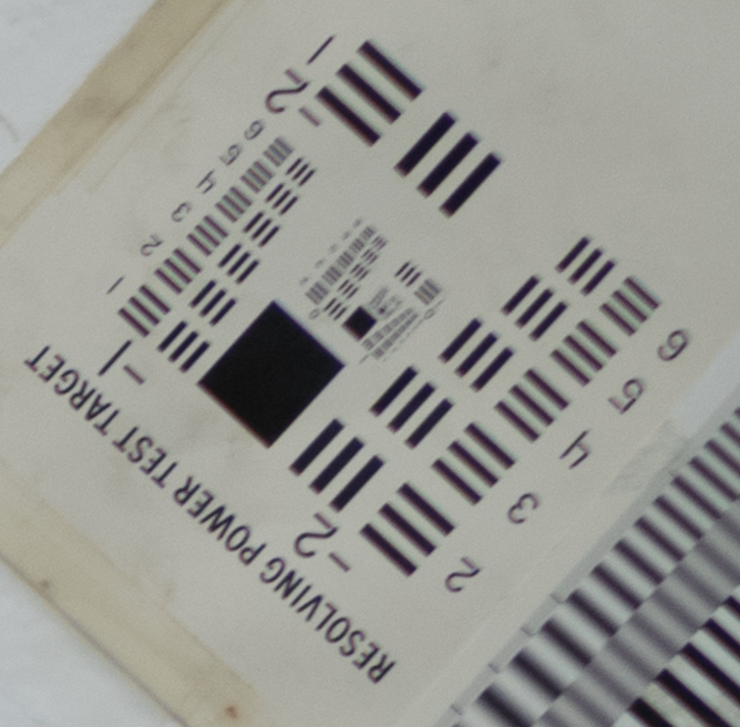

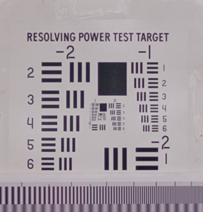

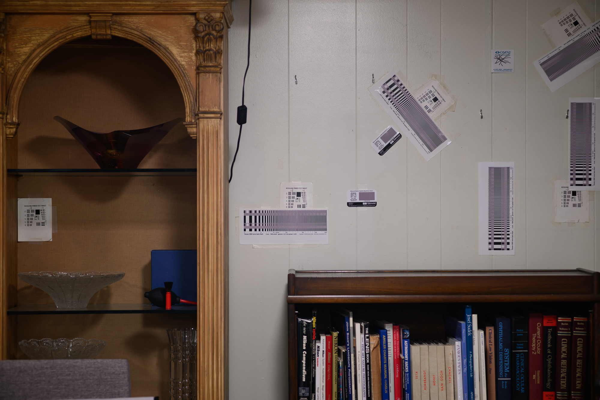

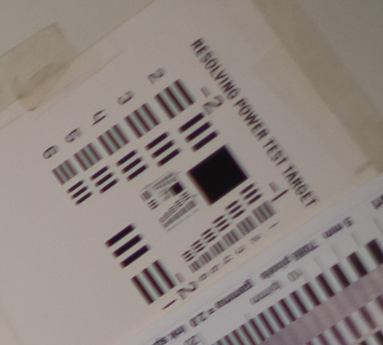

Much appreciated for the detailed responses. USAF resolution chart results wide open with the 90 Elmarit-M on my Z8 shows very sharp images centrally/mid-field, acceptably good at the edge but soft at the corner due to astigmatism. Stopping down to f/5.6 eliminates most of the astigmatic blur. By re-focusing at a slightly closer focus on the corner target using the EVF, it corrects the astigmatic blur but leaves the center and mid-field a little bit soft. I'll try to test it out on an M11 to see if it corrects the astigmatic corner softness without refocusing. If corner to corner sharpness is required for landscapes, the best option would be to focus normally and stop down to f/8. Below are results wide open at a distance of 1:51 repro ratio for proper reading of the resolution charts.
Full image
Center target. 88 lp/mm
Right edge target. 50 lp/mm
Upper corner target. 28- lp/mm
Edited on Jan 13, 2026 at 09:48 AM · View previous versions
Jan 08, 2026 at 08:34 PM

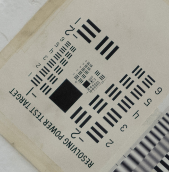

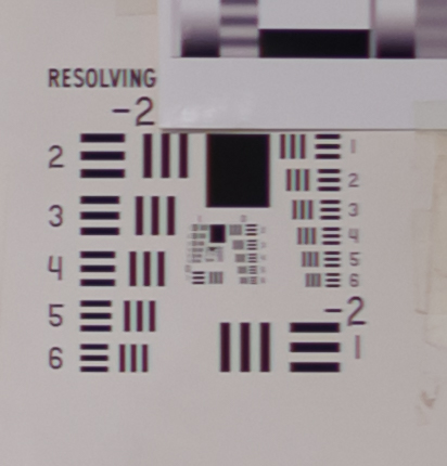

I had the oppotrunity to try the 90 Elmarit-M lens wide open on a Leica M11P at my local camera store and it confirmed the Leica ultrathin sensor stack was responsible for eliminating the corner astigmatic smear. Attached are the results with tightly cropped images. The resolution of the central target was the same as with my Z8 at 88 lp/mm but the corner resolution increased from 28- lp/mm to 56- lp/mm. The astigmatic smear is due a slight focus shift as the image rays pass through the thicker sensor stack of a non-Leica digital camera. The easiest way to compensate is to use a smaller aperture like f/5.6 or f/8 if you want to maintain sharp focus for the rest of the image.
focus on center target, f/2.8. 88 lp/mm
Upper corner target, f/2.8, same center target focus. 56- lp/mm
Jan 13, 2026 at 09:20 AM
