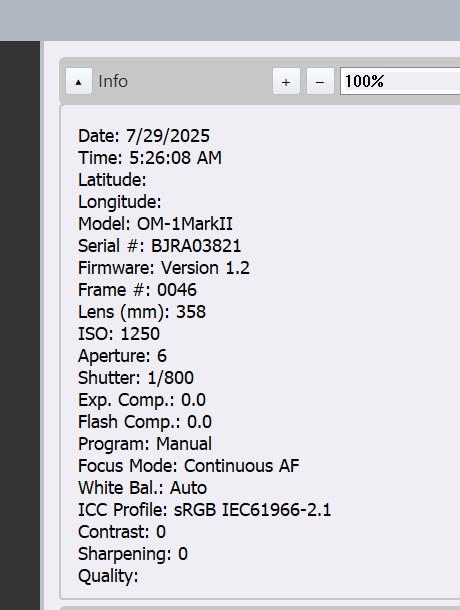

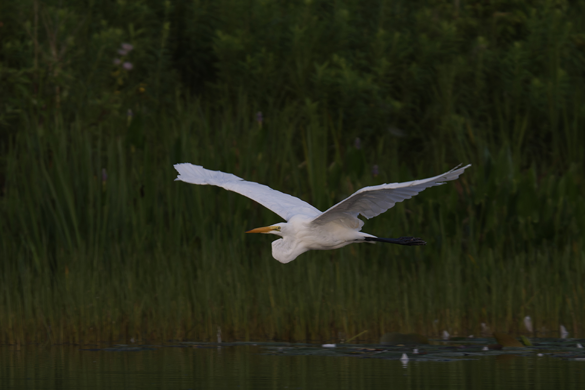

I had an OM 150-600 for an outing this summer and was not pleased with the mixed results. But I have a suspicion that I was in AF-S mode instead of AF-C for some unknown reason. I've tried searching the Exif data. That shows me a ton of information but not AF mode. I'm still trying to come up with a long lens solution and this info might help me figure things out. Anyone ??
Gary
  OM-1MarkII     OM 150-600mm F5.0-6.3 lens    358mm    f/6.0    1/800s    1250 ISO    0.0 EV

Hey Gary, I use Photo Mechanic for culling and it will give me the Focus Mode used. Sending you a PM that you can email the raw file and I can check for you. Patrick

PV Hiker
p.1 #4 · Can anyone tell me focus mode for this shot ?
Continious AF.

sum1sgrampa wrote TO ME IN A EMAIL:
Hmmm. That's interesting. The series that I took that from is terrible. Over 20 shots and very few are in focus if any. That 150-600 came from MPB. I returned it after testing this summer. Possibly the lens was bad or I screwed something up. Anyways, that's a big help. Really appreciate you taking the time.
To respond to your email and for others to chime in for help,
It is alway hard to determine why a series did not catch foucus on subject. You did that so long ago that the Medadata does not tell you the real infomation you need.
On the OM-1 MK2 There are so many menu settings that you can set along with what focus pattern size, etc..
Like for one, the menu "AF" tab "2" "C-AF Settings". I like to have this set to "ALL" so IF you are using a smaller focus grid pattern and get focus, as long as you keep the shutter half pressed or full pressed the autofucus will move with the subject outside the smaller pattern. This is how the OM-1 worked with the "Tracking" feature.
The other option selection, the autofocus will be lost if subject goes outside of your selected grid size.
Way too many setup variables for you to remember back when you capatured that image.
Cheers, Patrick
