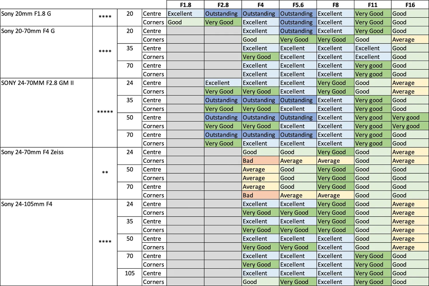

The chart, below, is from SonyAlpha.blog, a a testing source I have found to be quite reliable. I find the GM 24-70mm f2.8 II to be superior to the 20-70mm f4. In fact, I sold my 20-70mm f4. A lens that I actually use a lot for traveling is the Sigma 20-200mm. This lens is surprisingly sharp.
From the SonyAlpha.blog website

Maybe I had a strange copy but my 24-105 experience was the polar opposite of what this chart expresses. Mine was much better at 24-50 and weaker at 70-105. Unless I don't understand their relative statements of excellent and very good. I assumed excellent was better.
