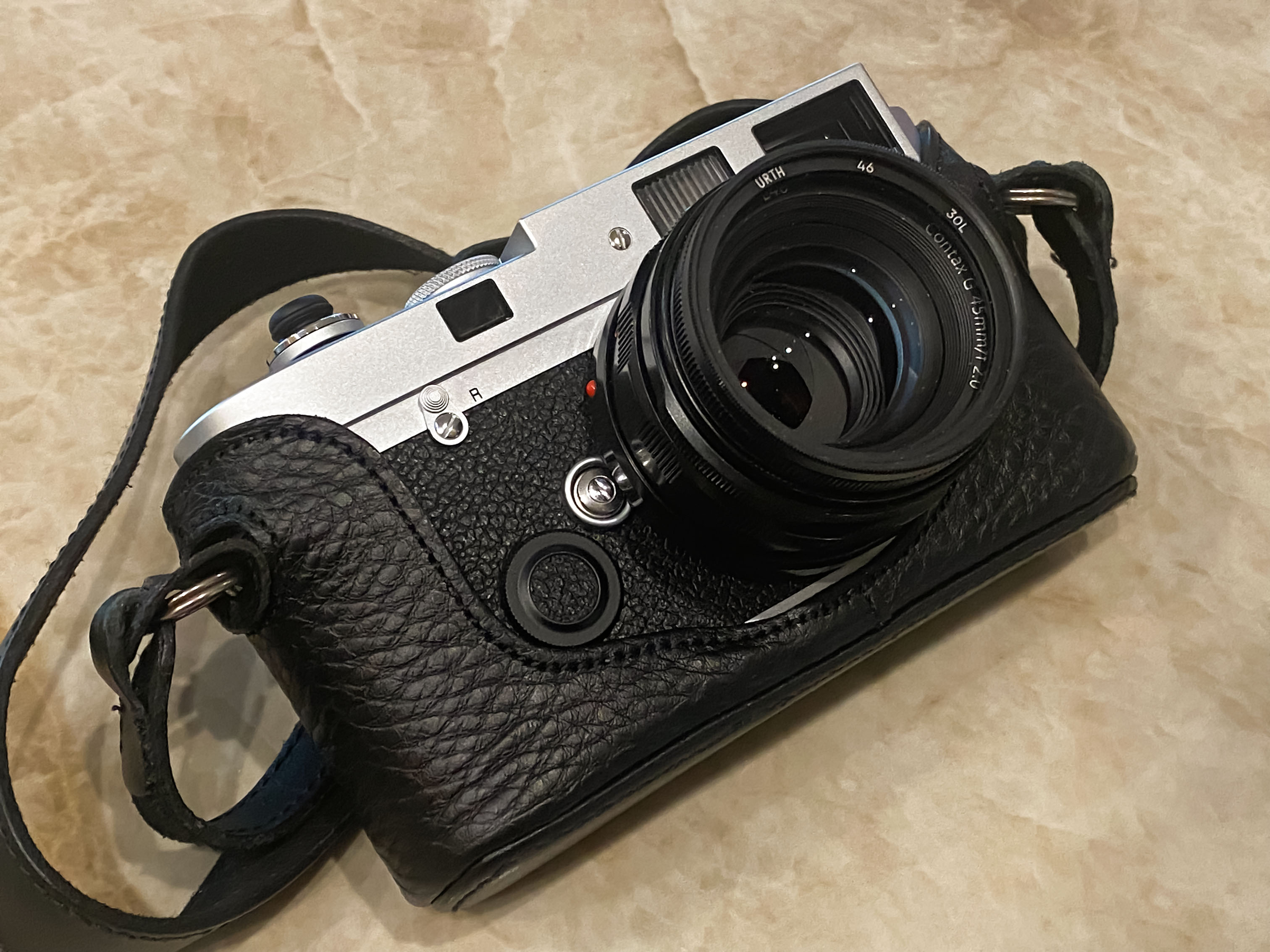

It is a tiny bit hefty but could be worse if it had lead or lak glass. I think it is a good weight match weight and size for my MP which is also hefty they two lens and camera fit well together and it is a combo I like, in part because this is a film era lens, works great on dig, but it was designed for film and in general that is my preference is to use it as a film lens as I have great dig era lenses for my M11. The adaptation is a good match for Leica film cameras, to my eye it works well, and equally so on a black Leica like my M4-2.
Photo my MP as I use it, and the 45/2 G from Funleader I think it looks like it belongs on the MP

Looks great on your MP! Your F2 comparison between the rigid and 45/2 is interesting. It's quite different between the two. I'll have to check out the video you linked.
