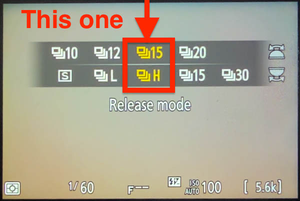

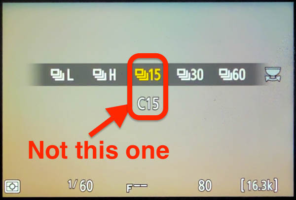

Assuming you have the latest firmware, there are two different 15 FPS modes on the Z8. Make sure you haven't chosen the C15 mode, as that is JPEG only.

That's exactly what I did and luckily I found it and changed it. Thank you!

I believe the top left half of your viewfinder will display "c15" , which you should be aware is a high speed capture mode in Jpeg only. If you see this, that's your warning https://onlinemanual.nikonimglib.com/z9/en/adding_c15_370.html
