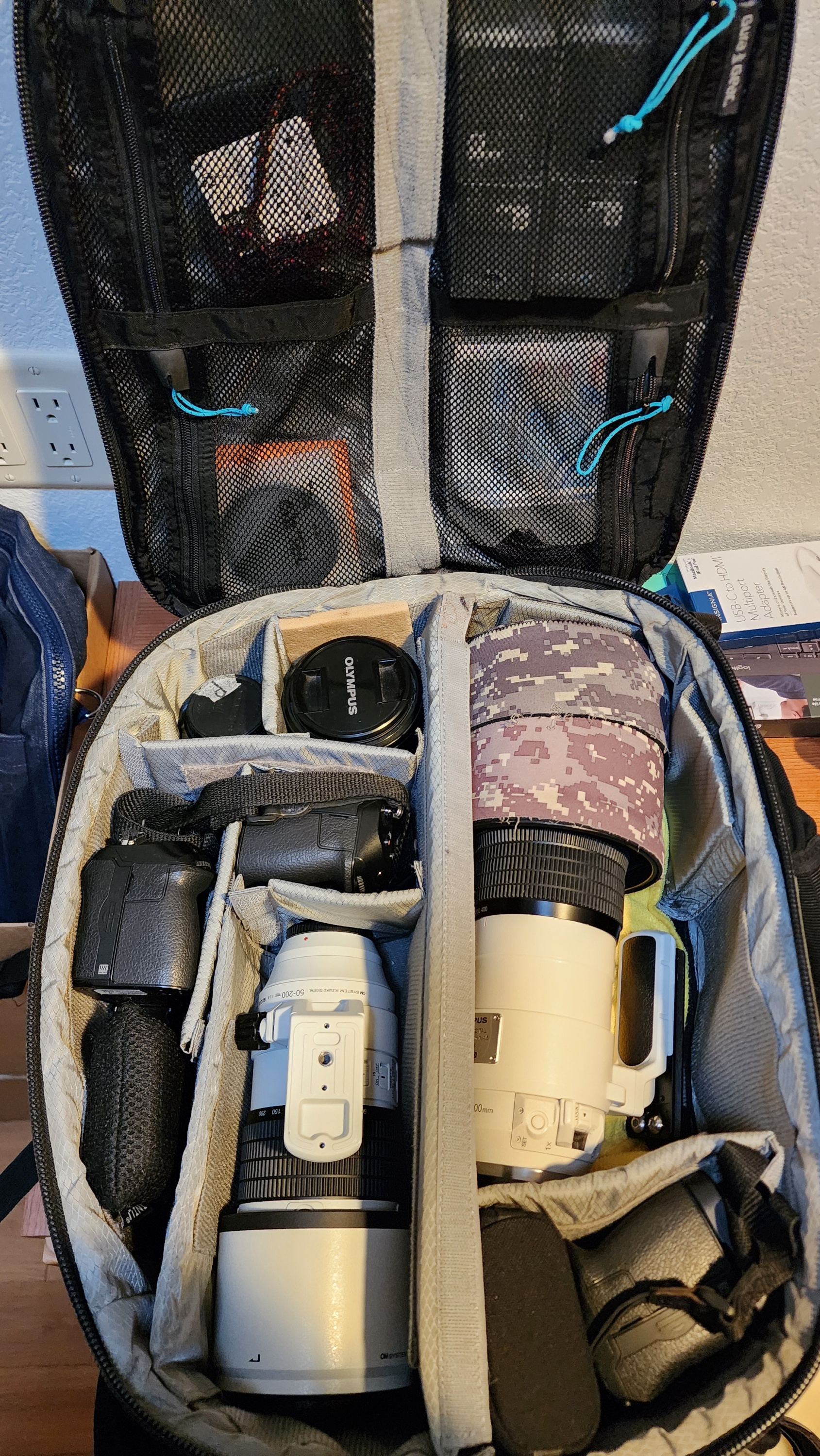

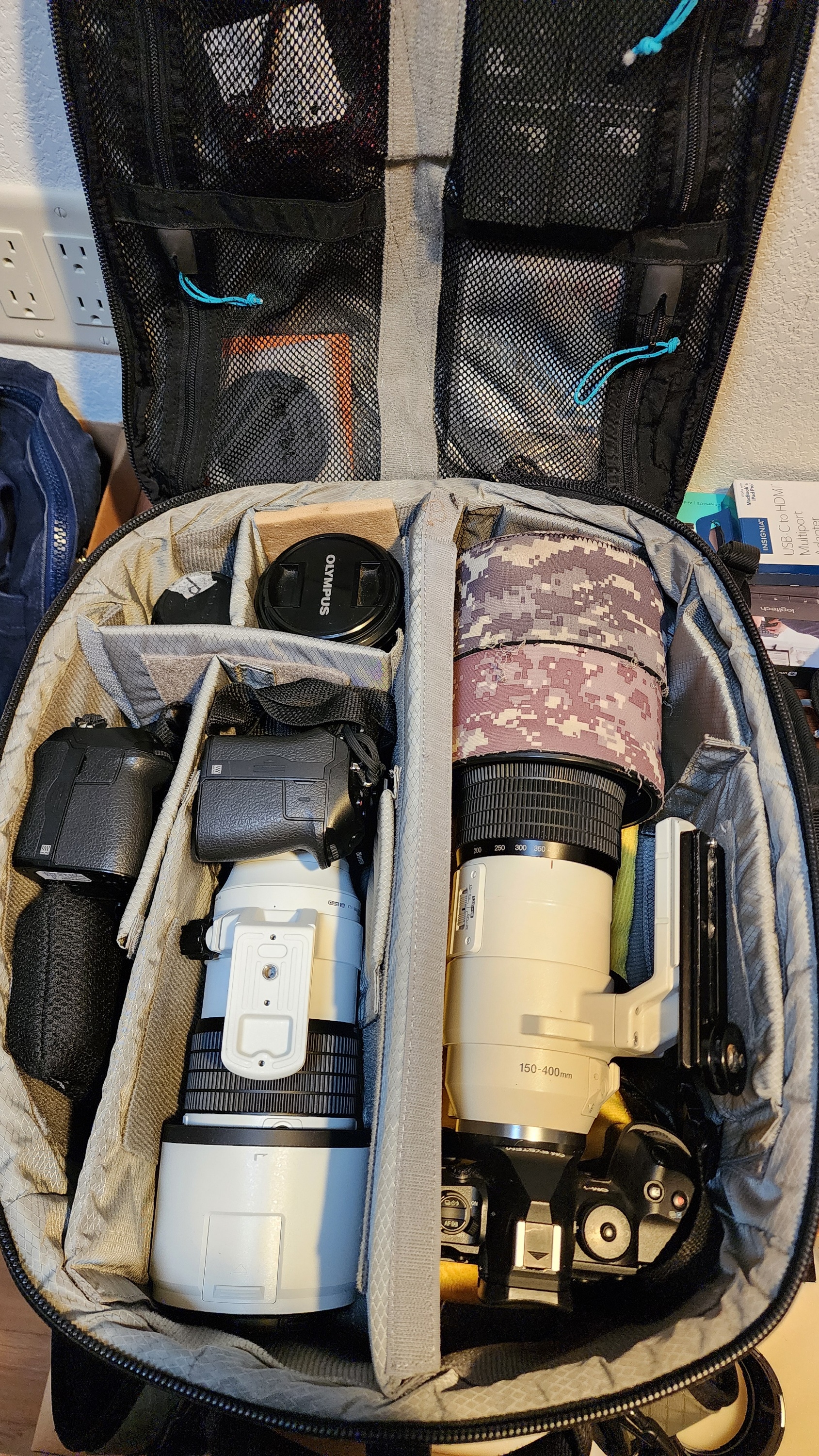

Hey Dan,
Below is two images of the Gura Gear 26L Bataflae camera bag, on for traveling and one for using camera mounted on the 50-200 and 150-400.
The bag is sized that now with the 50-200 it is longer so I can't have the smaller lens mounted on the camera and zip the bag closed.
*Click on the image to see full screen*
Patrick.
Cameras and lenses for airplane transport
Camera and lenses mounted for use
