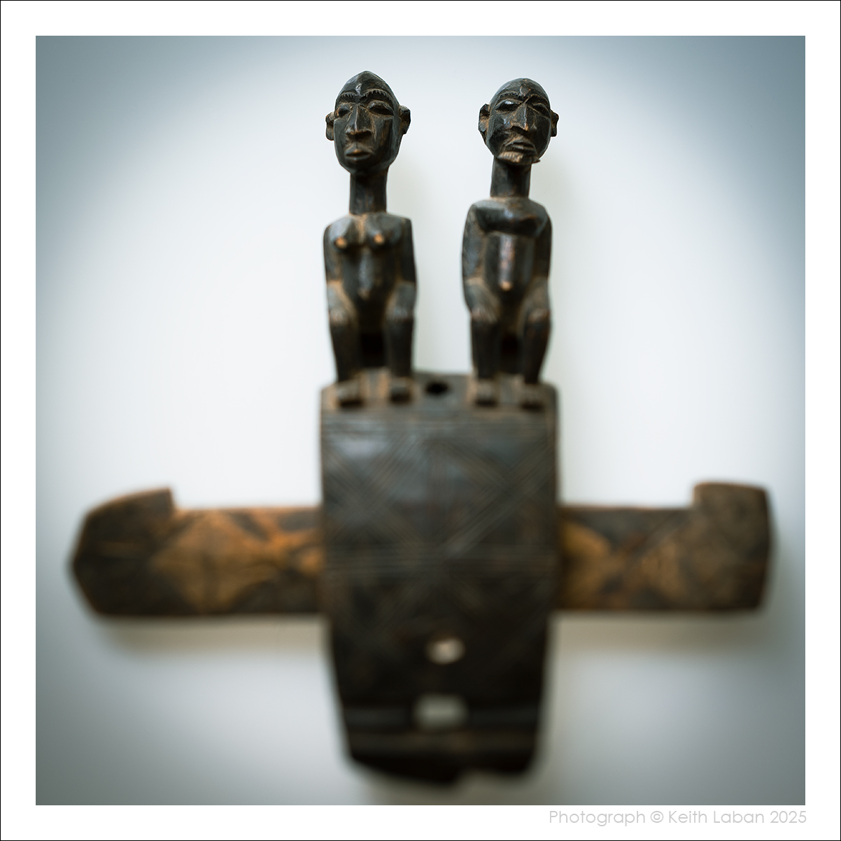

As well as the 58 G, I'm currently using a couple of inexpensive 'characterful' third party Z Mount lenses, namely the Syoptic 50mm f/1.1 and the 50mm TTArtisan 1.4 Tilt.
Syoptic
TTArtisans
Don't be concerned about the vignetting on the shell image, it's not the lens but purely a conceit on my part.
Nov 01, 2025 at 05:09 AM
