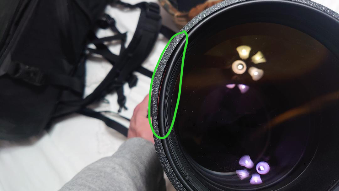

Recently I picked up a well-used Canon EF 600mm f4 IS II at what I *think* is a great price. The seller was very upfront on the condition of the lens and he noted that the front rubber ring on the lens had some denting "due to leaving the lens shade on overnight." I'm not quite sure how that would be, but the lens seems to be function perfectly.
As with any supertele that I have owned I purchased the Zemlin hood + cap combo (highly recommended) but unfortunately the lens cap doesn't fit well due to the denting of the rubber ring. I was able to get the cap on with some effort and as of right now I am leaving it there in the hopes, albeit how unrealistic, that it might help push the rubber ring back into place a touch. As it stands now, the Zemlin cap is really hard to put on and remove.
Has anyone attempted to "fix" the dented front rubber bumper of a Canon supertelephoto lens? I am tempted to use a pair of soft-jaw pliers to see if I can reposition the dented portion of the ring, but I don't know what risk there is in doing so. I am not sure what the 'anatomy' of the rubber bumper is or what it connects to.
Alternatively I do have a Lenshood Hoodie XXXX that would fit over the lens's glass when the Zemlin hood is in the reversed position, but gosh, those Zemlin caps are AMAZING and I'd love to be able to use it.
Thoughts?

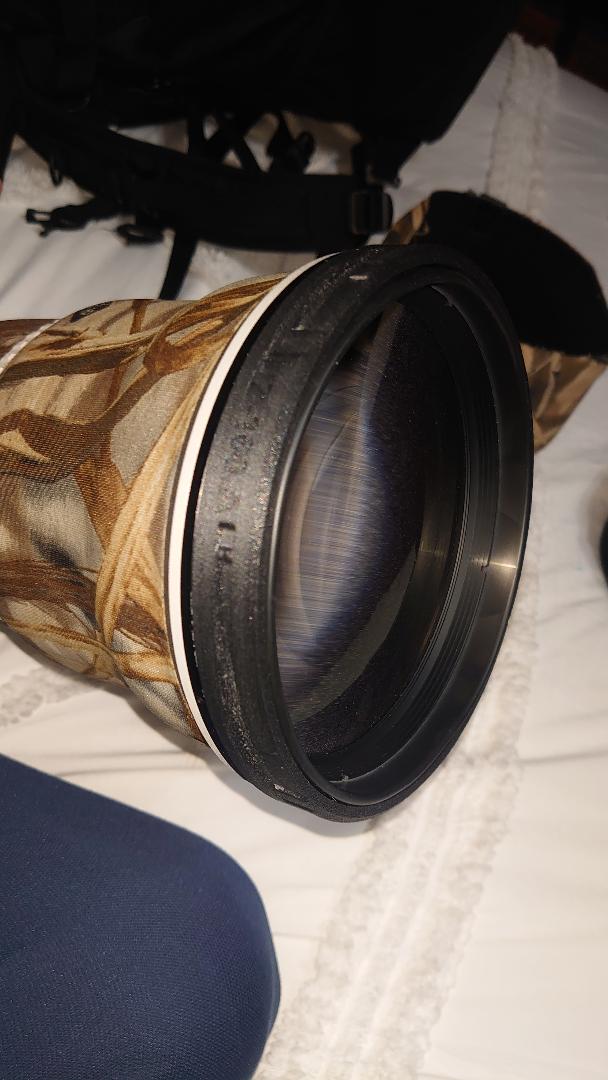

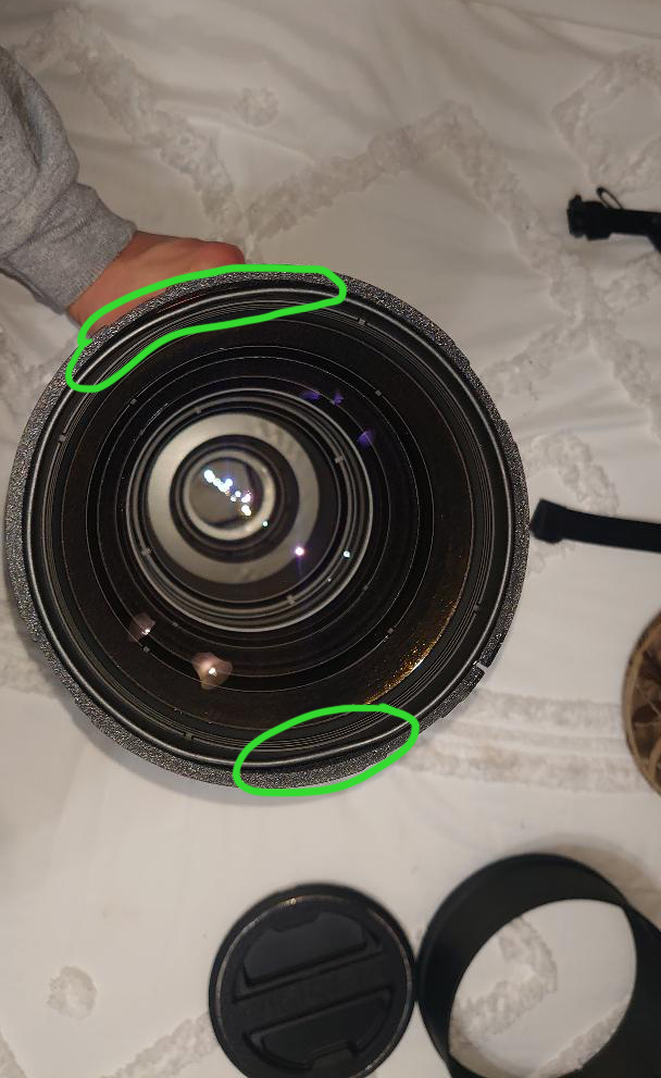

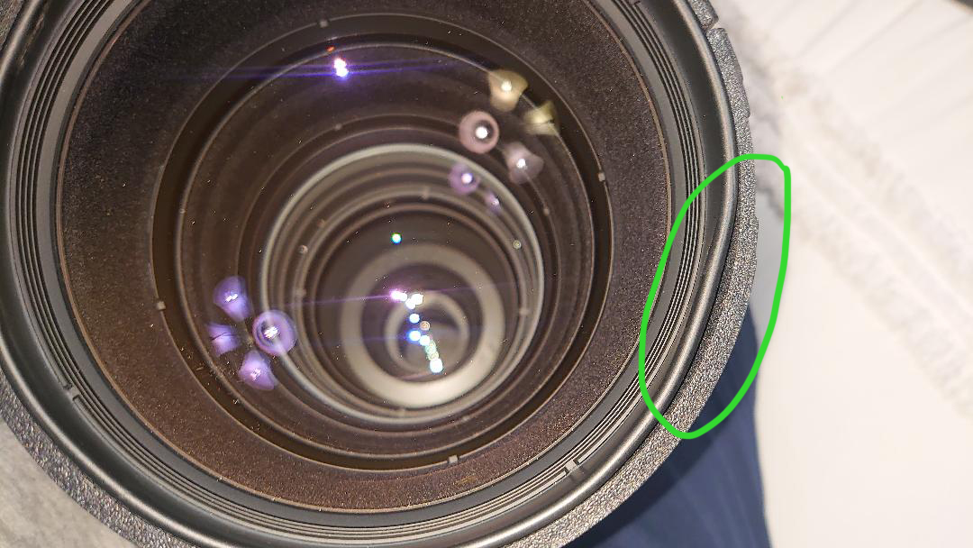

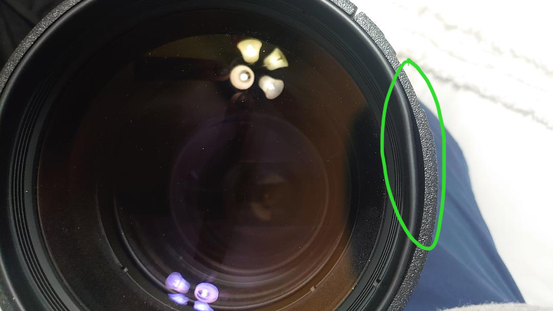

Photos added!
First photo shows entire rubber edge.
Second and third show same area.
Fourth photo shows the opposite area.
I added a Zemlin ring which connects to the Zemlin hood; it kind of helps to see where the Zemlin ring pulls away from the rubber where the rubber is bent.

Would it make sense to cut a form out of something like plywood in the radius of the overall ring so that you have a way of straightening out the curve versus the single pressure point of a set of pliers?
I have this feeling that the front ring is not purely rubber. Rubber would return to its original shape--any small dent should be in its elastic region, not deformed. Is there metal or something similar underneath? Looking at the parts diagram for the v1 600mm f4L IS (I can't find the v2 parts diagram) it looks like a rubber cover over something more substantial underneath?

Hi,
I had the same problem with my 600.
The rubber has a thin metal insert. I used a shifting spanner, just covered the jaws with tape, gentle bending the rubber outwards and all fixed in 2 minutes.
Regards

I'm wondering if you can gently push them out with your thumbs. The from ring is probably aluminum or similar.

-That front ring is metal, probably aluminum, the rubber is formed rubber that slides over the front of the ring. I would not try using pliers to straighten it. It is amazing how aluminum will dent without cracking but WILL crack when you try to straighten it.
-I can't believe putting on the hood incorrectly would dent the ring, It took a hit of some sort. I bent that ring on a lens i bumped it on a door jam.
-Canon's end of service on that lens was July 2025. Although you could try calling them and see if they would replace the ring.
-If you really like using the Zemlin cap I would be inclined to use sand paper or a file to take the roundness out of the Zemlin cap in one area and when you use it, use the flattened are where the dent is. Would probably only have to do that where the bigger dent is.

To me, that's looks like a dent in the metal ring that's under the rubber. Leaving the lens shade on overnight would not cause this.

It looks like the hood was not seated all the way when the thumb screw was tightened down. I did the same thing on my 200F2 and now have a small flat spot. lol
Either way its cosmetic and other than that shouldn't be a worry at all, unless you're OCD about it.
