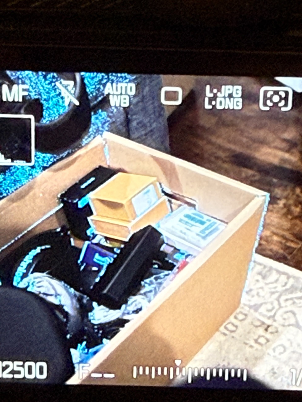

Thanks Huss - I set up only 1 info profile that includes focus peaking with sensitivity set to high. However, I do not see any focus peaking color. Strange . . .
In fact, when I play back an image I see the focus peaking on the just shot image on the LCD. But I don't see it on the LCD or EVF when focusing.
Here's a picture as it appears on the LCD during playback. But the blue peaking color did not show on the LCD or EVF when focusing. Focus was on the white plastic box with writing on top. Sorry for the crappy phone pic.

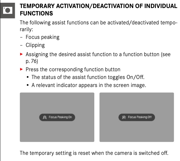

Thanks for this. I tried assigning a function button to toggle focus peaking and it does nothing. No message that focus peaking is on or off. Makes me fell like I'm missing something or worse . . . focus peaking is dead on this camera.
Oct 24, 2025 at 08:30 PM
NP.... I have gotten frustrated figuring this camera myself. Not as intuitive as it may seem at first!

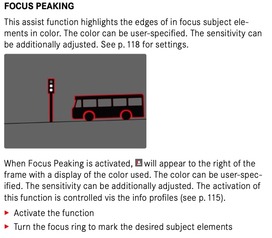

One more question, are you seeing the focus peaking icon at all? (Something I only just learned about trying to figure this out)
I am not seeing the focus peaking icon. Yet, focus peaking is turn on in Profile 1. It is off in profile 2 with a different display. I CAN toggle between profiles with the FN button so I know I'm in the right profile.

I just found that enhanced live view disables focus peaking.... Wonder if that was it. That being said, I am pretty sure peaking worked when magnified.....

I only found it on the 3rd time through the manual, only in the section about ELV. Would be nice if they referenced it in the focus peaking section..... But whatever.
I ran up & checked my SL3, peaking is visible in magnified view, albeit less with much less intensity
