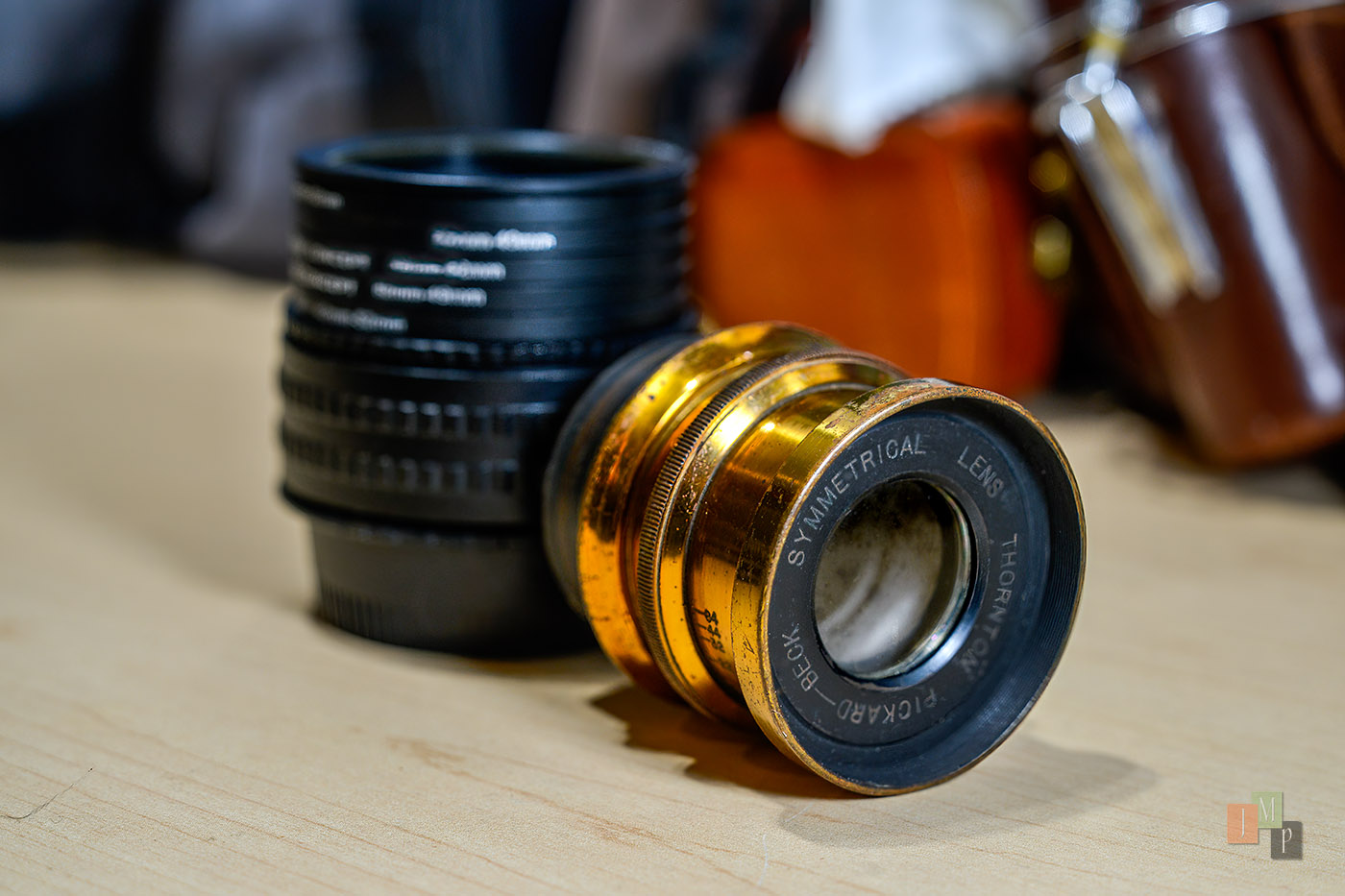

"Using MF film lenses on Digital bodies.....worth doing?" Really? If I could use a coke bottle I would. Film or digital, and it is great fun plus economical. OLdest lens I've adapted was a 115 year old
$1 Thriftshop lens and cobbled together adapter in background from one of the earliest photography companies

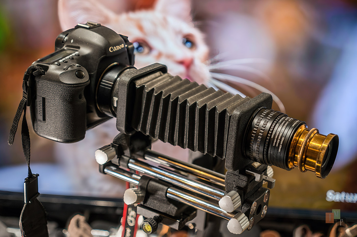

One setup

That 11" 115 year old lens was off a 5x7 wooden camera - kinda the large end of medium format - imo
Same lens pictured on the 1910 "Imperium" whole plate body
http://camera-wiki.org/wiki/Thornton-Pickard
