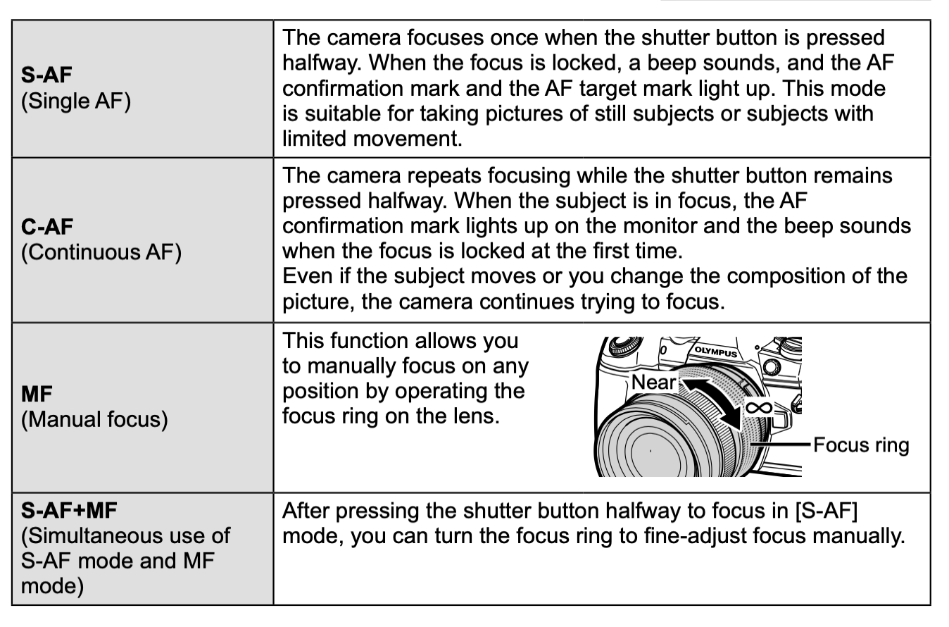

I believe all macro lenses focus-hunt more because of the much shallower in-focus distances.
If your subject is not moving, you should be using S-AF mode or Manual Focus mode, not C-AF mode.

p.1 #3 · OM System 90mm Macro Focus Hunting
?si=2USjMyiwOZfYkmBm
