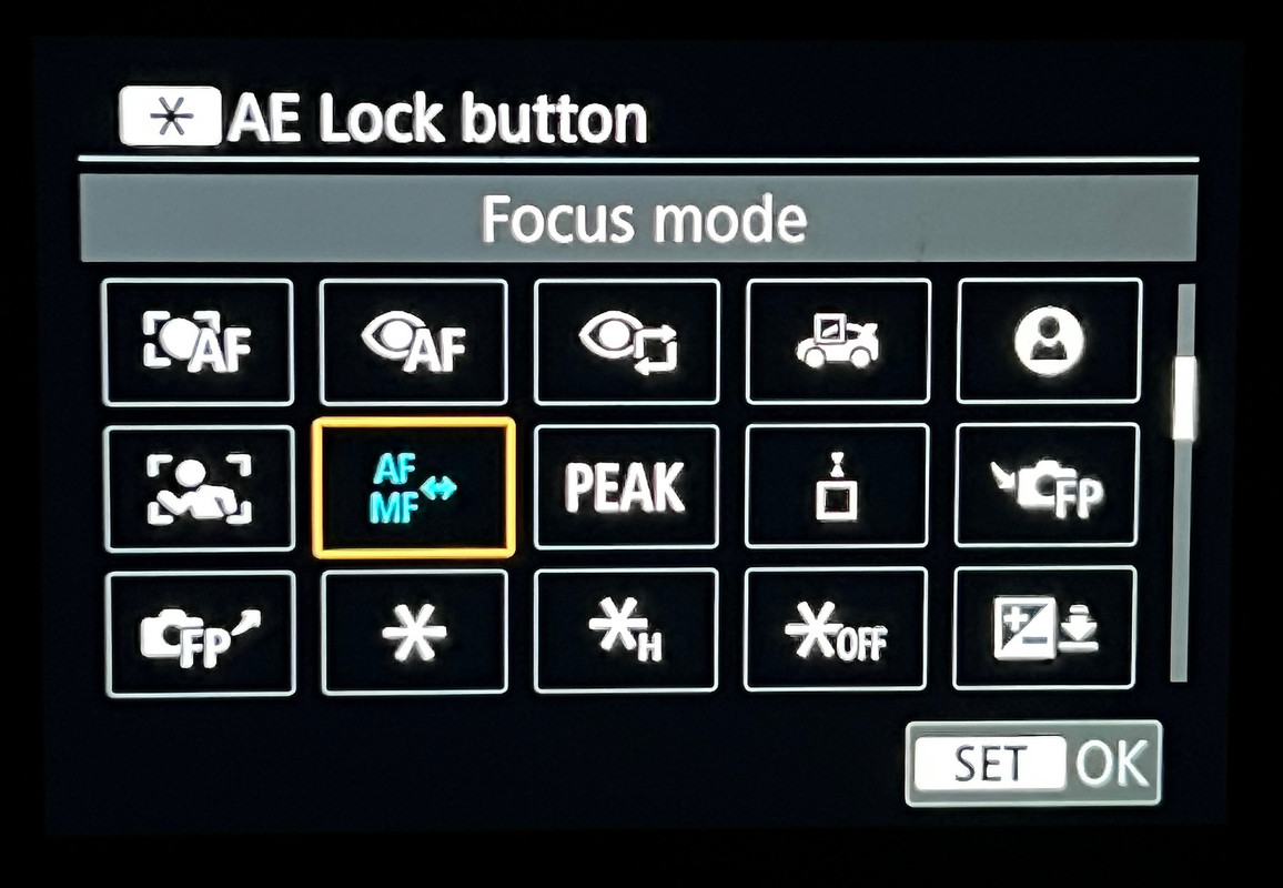

Camera R1 with lenses having the AF/MF switch.
Does anybody know why pressing the * button, with assigned AF<->MF function, doesn't toggle between AF and MF? It doesnt seem to do anything.
To eliminate possible interdependency with other custom settings I tried this after the factory reset.

p.1 #2 · Custom settings AF<->MF question
Tried it with the R5II. It didn't work with the RF 135/1.8, but it would switch between AF and MF control with the RF 50/1.8.
I thought it might have been a conflict with allowing electronic MF after AF, or as a BBF user, at any time. So I turned off that setting but it still would not toggle between AF and MF with the RF 135.
As you may know, if you are a back button AF user (BBF) (AF with the shutter release disabled), if in the AF menu you allow electronic MF focus, you can manually focus lenses at any time without having to use the physical AF/MF switch on the lens.
I'm curious what you want to do with this feature because if you're a BBF user, it's kind of an irrelevant setting.

p.1 #3 · Custom settings AF<->MF question
Thanks for reply and confirmation. Im not a BBF user. I opted for the * button as the most convenient for me. Unfortunately, the AF on all cameras, without exception, is unreliable and often fooled by various objects. When a Heron standing still turns the head away the AF will jump from the eye to a black patch on the shoulder or other black spot in the scene. Had Canon developed a good algorithm for the birds body recognition this should never happen. In such a case I need to quickly refocus and instead of fiddling with the lens switch Id like to have it assigned to a button. Both 100-400 and 100-500 lenses dont respond to the AF<->MF settings. It is also impossible to assign a digital cropping to a button. The Movie button cannot be assigned any function or turned off. In video the target acquisition is lethargic. The are many other limitations and nasty surprises. After disappointments with the R5II It is hard to accept them on the flagship camera. Canon is reluctant to admit to them and the UM do not list the important limitations which do not exist on other far less expensive camera.

VX4321
p.1 #5 · Custom settings AF<->MF question
Go -> Customize buttons for shooting -> Select function to assign to see the AF <-> MF option.
Over 1000 page UM neither shows this limitation nor lists the incompatible lenses and Canon support cant/doesnt want to explain why this doesnt work, at least with the lenses that I use. Thats why you can only discover problems and judge the camera after many months of extensive use. Not by reading the UM, testing a borrowed camera for a day or two or watching the comedian-salesmen on the YT. The AF system, since its introduction, has always been a struggle for the manufacturers and users alike. After decades of gradual, small improvements it is still unpredictable and unreliable, even on the top line cameras. Yesterday, during a video the R1 recognized and tracked the bird in the bushes with excellent accuracy, but when the bird came into the open all eight single-shot photo frames were garbage because the AF selected a black stump in front of the bird and clung to it. Another design screw up is the Video button, a total waste. If Canon photo designers talked to the video people they would place the Video button on the front of the cameras left bottom corner, just like it is done on the cinema line, and made it assignable. A non tilting LCD panel with reflective surface, low brightness and resolution is another big problem in the field. Instead Canon provided a 9 MP EVF which is no better than 5 MP in practical use. The battery, once impressive with the dSLRs is adequate, but not impressive any more. The R5 batteries with the letter P designation stand for puny.

rscheffler
p.1 #9 · Custom settings AF<->MF question
From the R5II:
Oct 05, 2025 at 10:35 AM

rscheffler
p.1 #14 · Custom settings AF<->MF question
Sy Sez wrote:
I guess it's on the "later" models, as it's not on my R5.
My brief Google research seems to indicate that its primary purpose is for use with lenses that don't have an AF / MF switch.
Does it completely" override" a lens AF / MF switch changing it to AF when set to MF, and Vica Vesa?
Doesn't seem to make a lot of sense when you can change it with the lens switch, or use Manual Focus Override, though perhaps it bit faster or more coinvent, I guess?
Well, as a BBF user, I agree this feature does not make sense when you can simply not press a back button for AF and instead simply turn the focusing ring for direct MF, if you have that capability turned on in the AF custom functions.
But OP prefers to have AF on the shutter release, which makes switching to MF a necessity. Their desire for this CF is to be able to do it with a simple no-look button press while shooting, rather than having to feel around, or actually look for, the AF-MF switch on the lens. I can appreciate what they want to do. Unfortunately Canon's designers/engineers have a somewhat different intent with this feature. It seems to only work with 'lower end' RF lenses that do not have a dedicated AF-MF switch, like the 50/1.8, and I assume also the 16/2.8, though I didn't try it.
I'd guess it would be a 'simple' firmware update for this feature to override the AF-MF switch on RF lenses equipped with a dedicated one. But it's another matter of whether Canon actually will do so. OP could send a message requesting this feature change to at least get it on the radar of someone at Canon.
