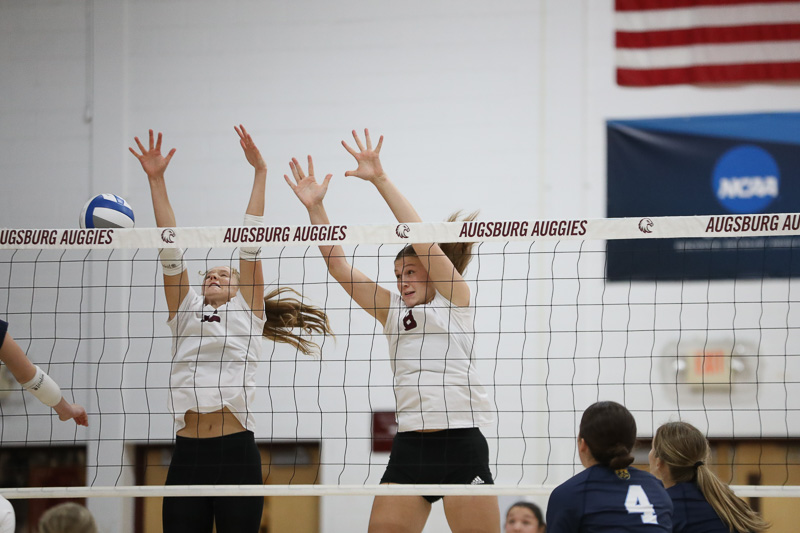

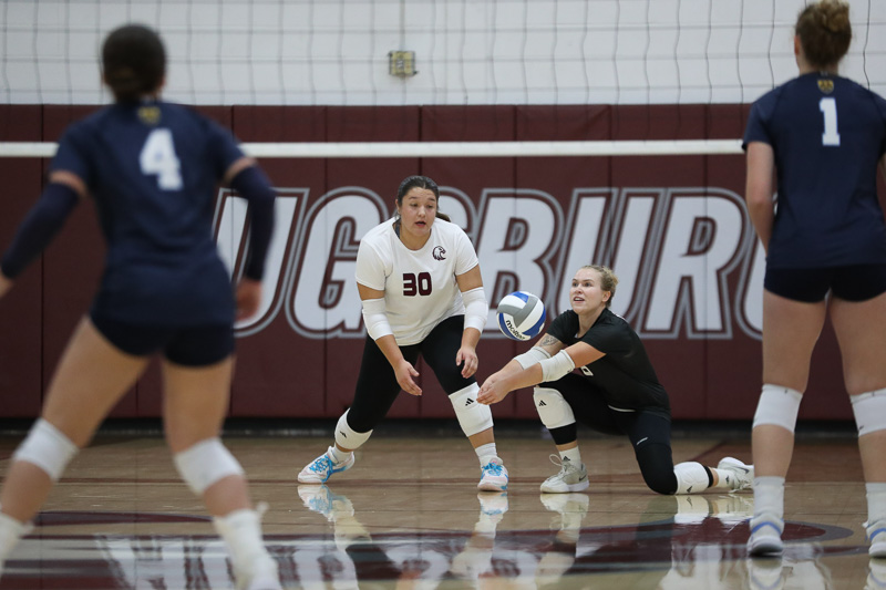

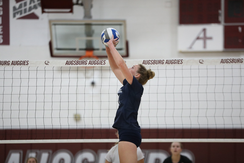

Here are some SOOC photos (other than horizon straightening) from a D3 college volleyball match from the floor facing the net with the 1Dx mk II and an EF 70-200mm f/2.8 IS II and using the center point as the focus point. No Zone focus.
  Canon EOS-1D X Mark II    EF70-200mm f/2.8L IS II USM lens    200mm    f/2.8    1/1600s    6400 ISO    0.0 EV

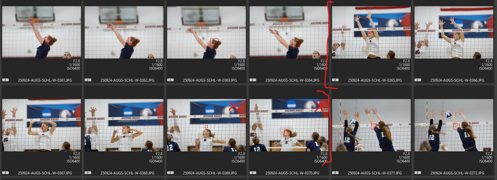

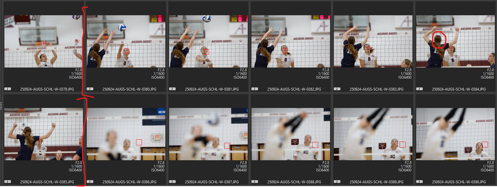

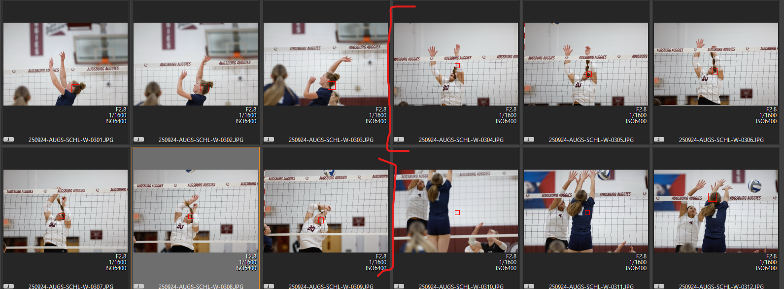

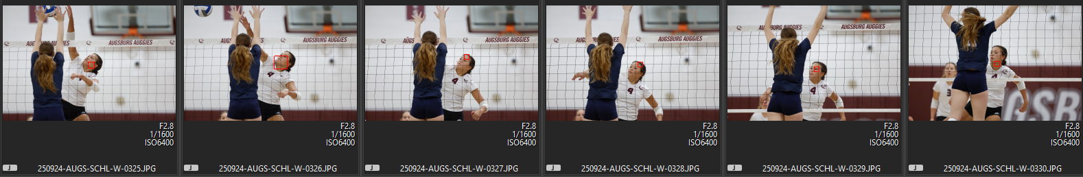

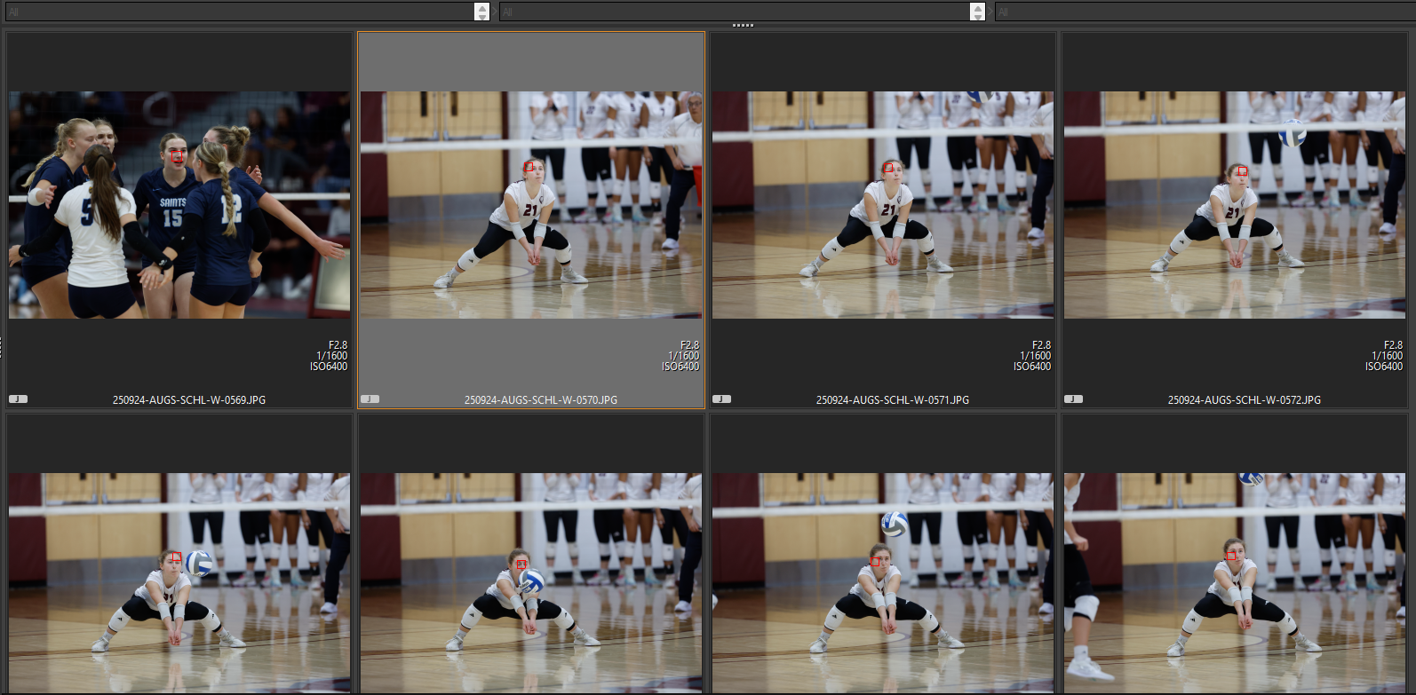

Here's some examples:
Here is one example where Subject Tracking never grabbed the person's head or eye (albeit a very brief sequence of 6 frames at H+). (I downloaded DPP just to see the focus points.) (R3 + 300 2.8 IS v1)
In the second sequence, the subject started in focus, but despite subject tracking, the focus moves to the net. (R3 + 300 2.8 IS v1)
In this sequence, the focus is locked tight on the Subject the focus drifts to the net in the frames marked with X. (R3 + 300 2.8 IS v1)
Here again, the subject tracking sees the person, but focuses on the net. Finally, the player in the foreground grabs focus. (R3 + 300 2.8 IS v1)
WIth no net, the subject tracking works wonderfully as it normally does. (R3 + 300 2.8 IS v1)
