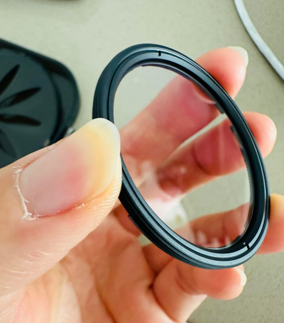

p.1 #2 · Filter solution needed
You could try modifying the JJC Inset Filter, removing the glass, then relocking a thin magnetic frame inside, then using whatever smaller diameter magnetic filter inside of that. But then youd need a strong magnetic pulling tool for the filter and test how much it would add vignette since it's the 28mm.
