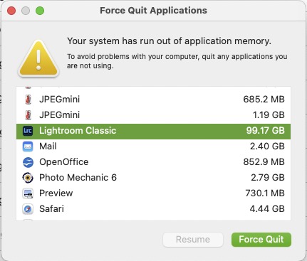

The memory pressure problem is happening most often when I'm exporting images from this project.
Often I will concurrently export at full resolution and a second identical batch at a reduced size, depending on client needs. One current problem appears to be that if it's a large number of images in the export batch, LRC does not like to initiate a second concurrent batch. The export verification for the second batch doesn't appear until the first one completes.
But memory consumption is definitely a problem. Often it will be OK during export, running in the 30-45GB range but something will happen (what, I'm still not sure) and it will balloon considerably. Twice now I've had to force quit when LRC was using up to 99GB.
For example:
Edit:
I just edited another project, all R5II files in a new catalog, none of the images have Denoise applied. On export, memory consumption sits in the mid 30ish GB range and never higher than low 40ish GB.
It seems that while the new handling of Denoise reduces user noticeable storage requirements because it appears to be saving the instructions for how to apply/calculate Denoise to an image, rather than an actual file with baked-in noise reduction like the previous DNGs, it perhaps requires more memory/cache for image handling (preview generation and regeneration) when new edits are applied. And also calculations on final export. Something about the new approach causes memory consumption to sometimes continue until it locks up the system. As if it's reluctant to purge, especially with a large export set.
Things definitely could be better handled behind the scenes.
