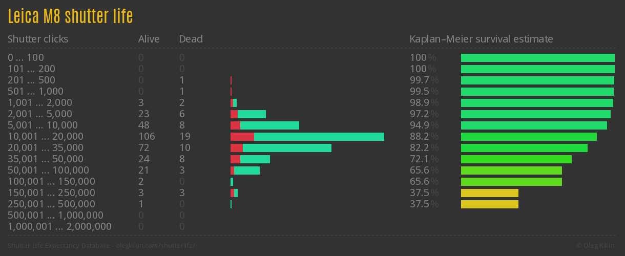

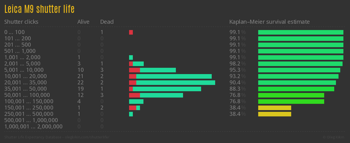

Attached below are self-reported lifespans of just the shutter components. They are a small sample size, and other factors are unknown. Source: https://www.olegkikin.com/shutterlife/

Very interesting. Shutter longevity is fairly high up to ~50k actuations, then starts dropping noticeably, with a big decline after 100k.
10k–20k shots: ~88% survive
50k–100k: ~66% survive
250k+: very rare, 500k+: essentially none
10k–50k is a safe zone, but careful use can extend life. After ~100k, expect higher chance of servicing or replacement. Mechanical shutters are easier to fix than electronics but still a key factor in overall camera lifespan.
I hope we are both alive to see your next chart in 25 years!

Not sure if the data is comparing to an established MTBF from the mfr, but the point where it reaches around 38%-ish is a reliability number that pops up when the average MTBF equals the expected MTBF, using exponential distribution.
Translation ... an average vs. the expected means about a 50/50 shot of making it that far. I know that % number is showing in the 30's but that's just kinda how the exponential math formula works out.
Note the 3 vs. 3 (i.e. 50/50) for the M8 = 37.5%
I don't know what Leica's expected design MTBF is, but I seem to recall that the Canon Pro models were slated around 300,000, and consumer models around 100,000. Similar for Nikon Pro, etc. iirc.
That said, seeing where the 38% mark is for the M8 / M9 ... I'd venture a guess that Leica's design MTBF (which is a mean, not an end of life necessarily) target is in that 150-500 range, i.e. same 300K as the other mfr pro models.
I'd be curious to know Leica's design / testing MTBF targets.
Of course, too ... those higher count numbers ... not a lot of them available for data points because (self-reporting) not a lot of folks stick with a camera that long. I mean, it's one thing for a professional sports photographer to rip of 1,000,000 frames. It's quite another for an M shooter to do 300K-500K. For some folks that's 30-50 years worth of shooting 10K images / year on an M body.
I say that because it may be that Leica actually designs higher, but we just don't have people reaching (self-reporting) those volumes very often ... based on usage, not based on failures per se.
Still, interesting info ... but, I wouldn't read the >100K falloff as being a worrisome point the same way many folks might interpret this info. Imo, a well taken care of rig with 100K should be in good shape to go twice that long again (+200K = 300K). But, I would use it as a point of negotiation on price point.
