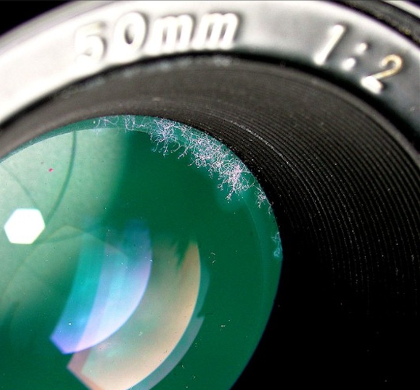

What is this discoloration on the front element? (EF 300/4)
wsalopek
p.1 #1 · What is this discoloration on the front element? (EF 300/4)
Anti-reflective coating peeling away??
https://photos.app.goo.gl/EVjNXaPSvwCxrUdV7

I'm not certain, but it looks like fungus.
Is it the 300 f4, not the 300 f4 IS?
As Gochuggi mentioned, the non IS lens has a protective front element.
If there is fungus there, it may also be on other elements.
If it's only the protective element, possible it could simply be removed. I don't know if there would be negative impacts on results, if not, it would be an easy fix.

Looks like fungus.

It's the non IS - for sale on eBay - rated excellent by a reputable seller in Japan - so I supoose the fungus is limited.
I've never owned a lens with fungus - is that much to worry about re: image quality?
I'm not shy about nicks and small scratches - and find good bargains that way - IQ seems unaffected 99.99 percent of the time.
But I've never had a lens with fungus.

A lens with that degree of fungus would never be rated excellent. It's not usually just a matter of replacing the element with the fungus on it. Most folks say to keep a lens with fungus away from the rest of your gear. I have no idea if it's really true that it could spread from lens to lens or from your camera body to another lens but it's an easy pass for me.

In the past, I was able to remove the fungus on 2 old FD lenses. It was more of a learning experience than anything else. It was easy to remove the front element, then I used a 50/50 mix of peroxide & ammonia on a q-tip. It took 2 or 3 attempts, but I eventually removed it.
