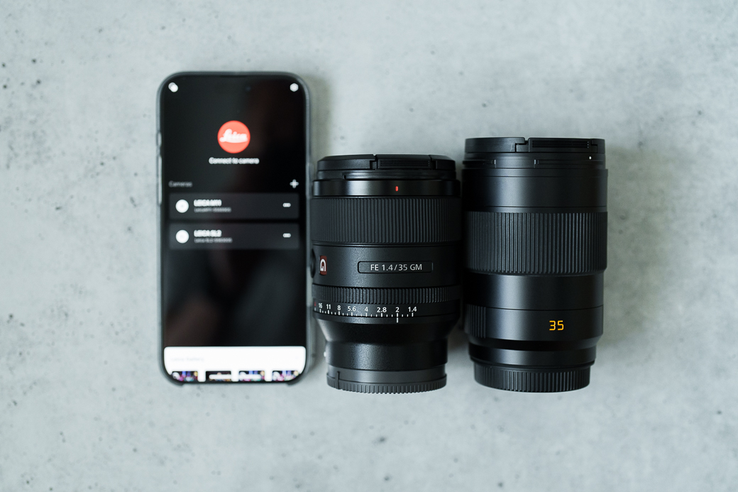

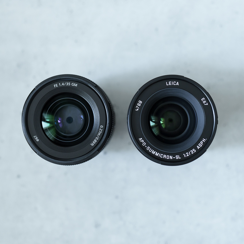

p.1 #18SL Apo vs Sony GM?
I think the GM35mm is as good but much bigger.
Is this a joke?
Sony FE 35mm f/1.4 GM
• Mount: Sony E (Full-frame)
• Weight: 524 grams (18.5 oz)
• Length: 96 mm (3.78 in)
• Diameter: 76 mm (2.99 in)
• Filter thread: 67 mm
2. Leica APO-Summicron-SL 35mm f/2 ASPH (L-mount)
• Mount: Leica L (Full-frame)
• Weight: 750 grams (26.5 oz)
• Length: 102 mm (4.02 in)
• Diameter: 73 mm (2.87 in)
The Apo Summicrons are monsters.
Unless, of course, you mean M lenses.

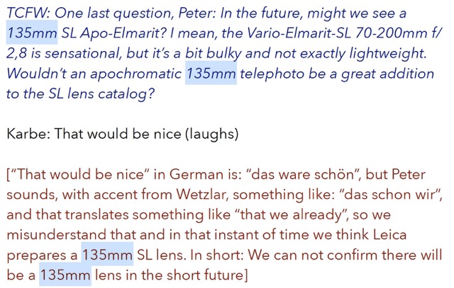

You may enjoy watching Peter Karbe Leica's Head Optical Engineer discuss his holistic approach to lens design and measurements when building the APO-SL lens system. Not in contrast to other manufactures, but just an interesting learning opportunity.
One thing that struck me is the manufacturing tolerance requirements differences between the compact M lenses, and the larger SL lenses. This must be a significant pricing consideration for the M system. Maybe this is a meaningful factor in copy variation that some other M lens manufactures seem to have.
