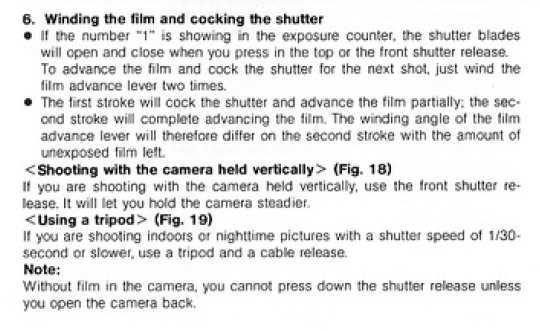

It takes two winds of the advance lever for each exposure. I attached a screen shot from the manual for my GSW690II, below. The manual for the III-series says the same. You can get your own copy of the III manual from:

Thanks for the reply. Is that also 2 winds for 35mm film to advance?

The film advance is determined by the width of the film gate. Switching to 35 mm film will not change it. Even if it did, I don't see how you could modify the GSW to change the amount of film advance between frames as the advance stops automatically. There is nothing you can do to advance it further once it stops, nor will the camera allow you to fire the shutter if you do not advance the lever all the way.

Yes. As @theHUN said, the film advance is fixed.
You'll get the same width for each image with 135 film, as you will with 120 film. The 120 film also provides the extra 50% (or so) that the 135 mask removed from the top and bottom of the 6x9 image. You're trading off using a few more rolls of 120 vs. losing a lot of image (which could have allowed you to move the 135-mask up or down in the image during post-processing, if it had been taken with 120 film).

35mm frame size is 36mm wide, if you ignore the gap between frames, 36exp basically is 36x36=1296mm, or 130cm, and if you count the gaps and the wasted frames at the beginning, the length of the film is about 160cm. When you shoot it on 690, each exposure will take 9cm, which is the distance film traveled when you strike your lever twice matter what film you use. So 130/9=14.4, that’s the maximum 9cm frames you can shoot on 36exp roll. Considering the way 135 film loaded on 690, you’ll waste maybe 2-3 shots, so I guess you can shoot 9-10 shots of 9cm frame.

IIRC the first wind is a full stroke and the second stroke gets shorter each frame as you get farther into the roll since the diameter of the film at the takeup spool increases. I never used my GSW690 III with 135 though. Worst case the extreme ends may slightly overlap or have extra space.
