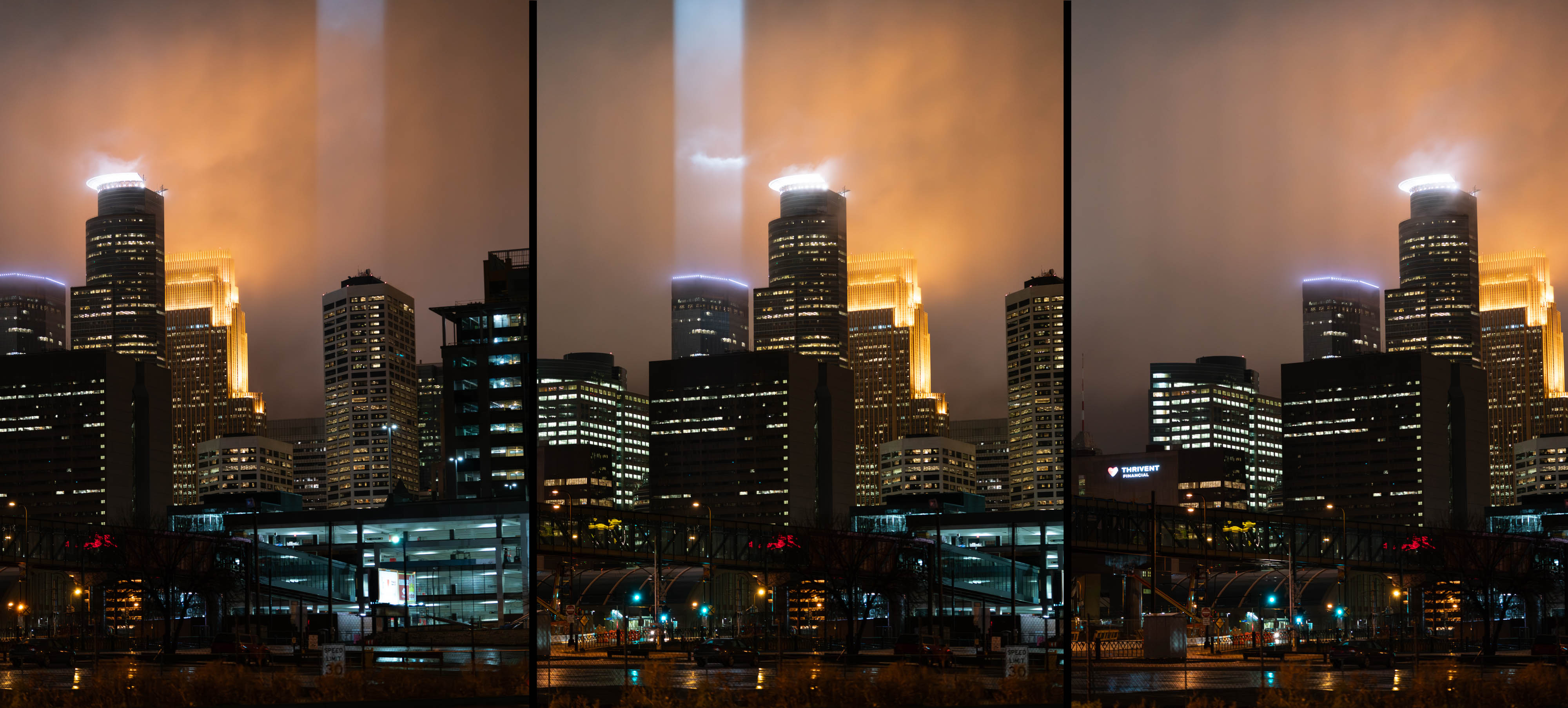

Years ago I was shooting an impromptu handheld pano of a cityscape, using EFCS on my A7R2. Although I was aware of the problem of shooting LED lights, I never imagined it would affect this sort of shot. And things looked fine through the viewfinder. But when I got home, there turned out to be serious banding in the sky, caused by a combination of a bright light on the tallest building and low clouds (which spread the effect across a wide area).
If I had just thought to use a slower shutter speed, the shot probably would have been saved. As it was, it taught me a good lesson.
Drastic banding in some of the frames
  ILCE-7RM2    FE 90mm F2.8 Macro G OSS lens    90mm    f/2.8    1/100s    8000 ISO    0.0 EV
The finished, though unacceptable panorama

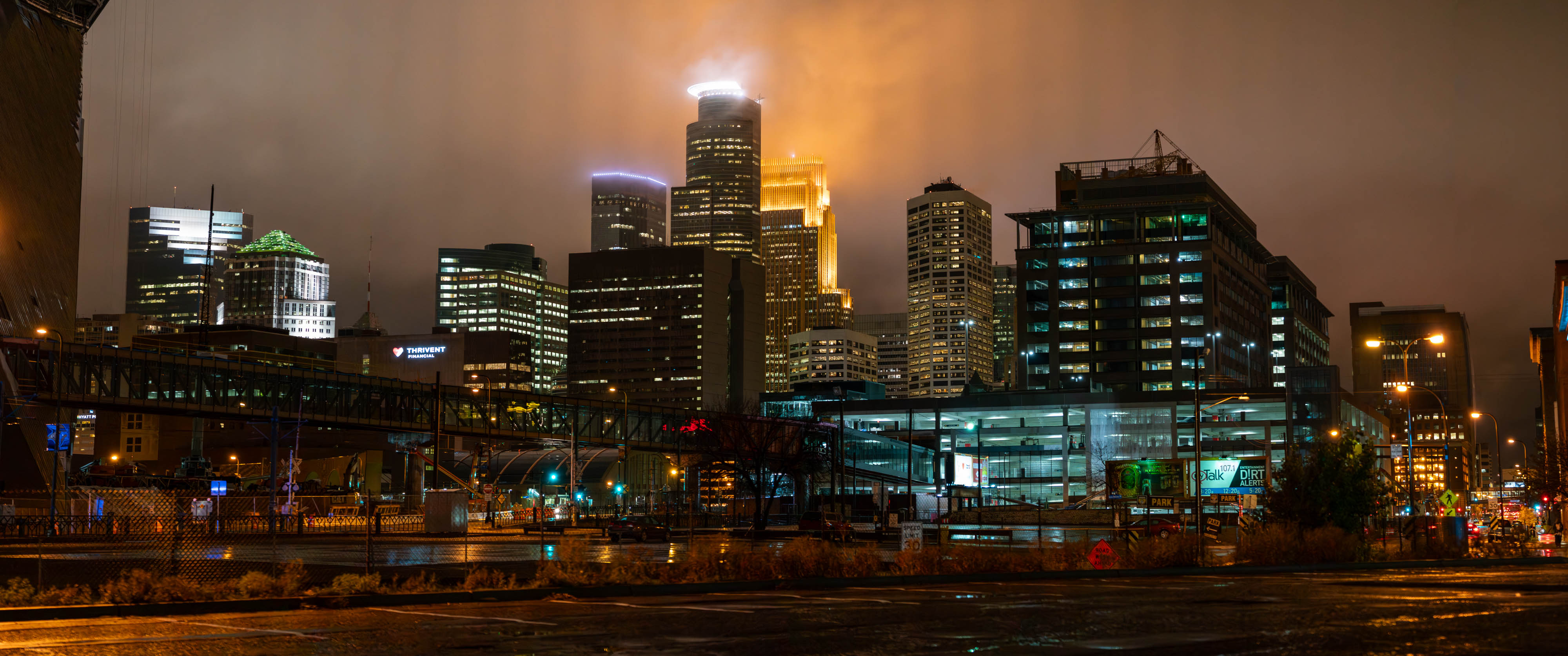

I have this far (having owned the A1 since 7 or 8 months now) not run onto any banding problems.
The image here is a stitch and processed. During the PP I didn't notice any banding problems in any of the images building the final result. There is at least seven different light sources ancluding the colored LEDs along the roof you can see in the image.
(You may complain about slight oversharpening in this web version though.) And yes, it was dark also if it doesn't look that dark now. Not middle of the night dark, but early morning winter day dark. ISO 500 1/100 sec.
[removed image]
Edited on Jun 30, 2025 at 10:16 AM · View previous versions

Nice image. Was this with mechanical or electronic shutter on the A1?
...Show more
Ouch, that was bad luck and a nasty golden light. I understand the disappointment. Let's say 1/30 sec and it may have been fine. I had a similar problem once and since then I check a first shot carefully in the viewfinder at different enlargement steps.
Thank you.
Electronic (and tripod and remote control). As the mechanical shutter is EFCS only I avoid it and have this far used it together with a flash only.
