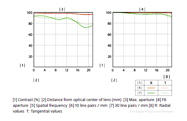

Most likely this is the best available solution. Most zooms (while exceeding fixed focal performance nowadays) are really heavy. And getting a well centered copy (at all focal lengths) is cumbersome.
The Sony 14mm has 104 degrees horizontal FOV and weighs 450g, it is really worth a thought.
How strong is the midfield dip of the GM 14mm?
At what f-stop does it go away?

I haven't observed or tested for this. But I find the performance to be excellent.
Here's an Optical Limits review with some info: https://opticallimits.com/sony/sony-fe-14mm-f-1-8-gm-sel14f18gm/#MTF_resolution
Also, a Sony-provided MTF chart.
