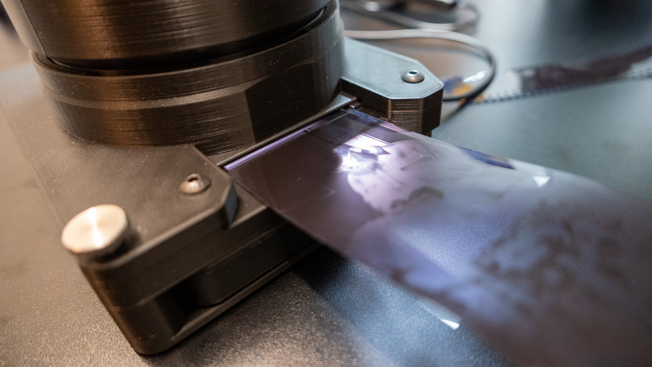

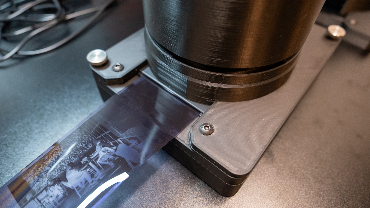

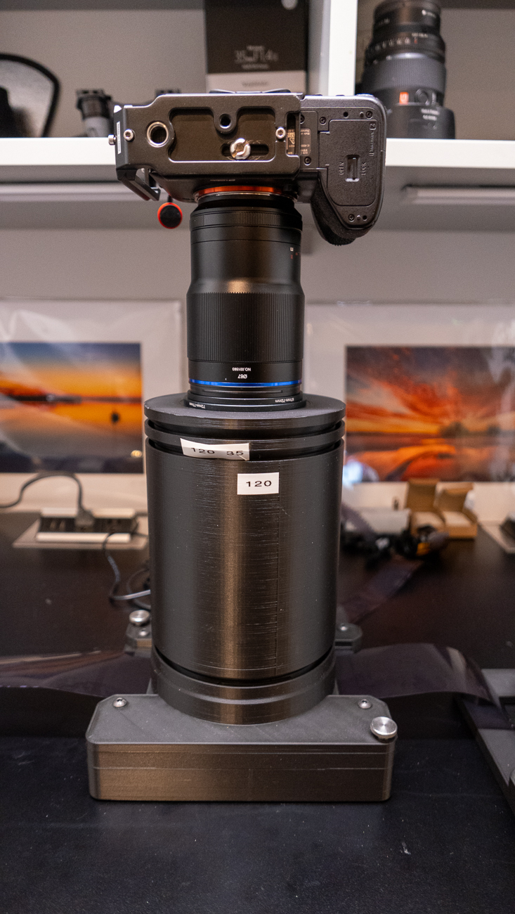

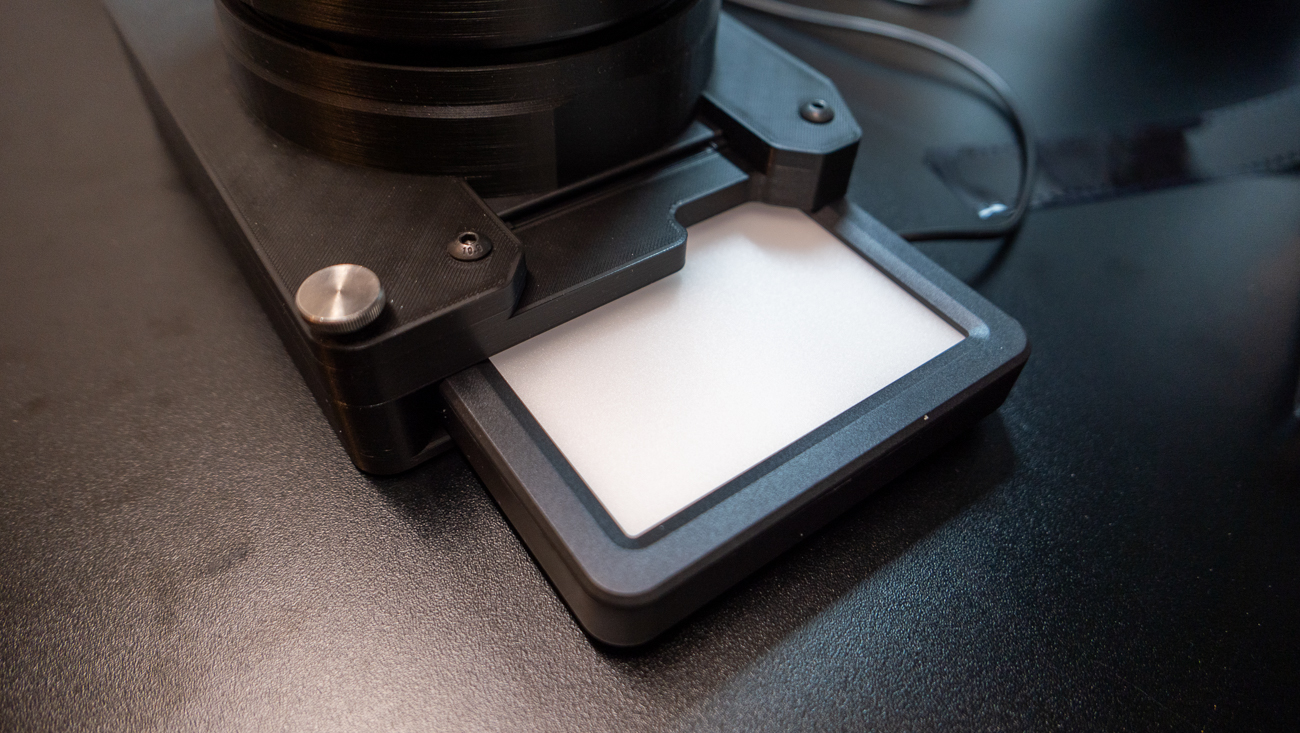

Following up on my previous post in this thread, I ended up purchasing the Blackscale Lab Molo scan unit. Similar to the Valoi Easy setup but comes ready to scan medium format AND 35mm. The price point is less than the Valoi easy120. The kit comes with everything you need, a variety of extension tubes, step up rings, cinestill light and three scan mounts 35mm, 6x6 and 6x9 masks. The whole setup is very solid and the negatives are held in place and flat. It's a pull through design which allows me to scan a roll of 36 exposures in about a minute. I'm loving this one kit solution for all my 35 and 120 scanning needs. The Cinestill light source slides right into the holder and fits perfectly. I will also point out that Dmitry, who created this system, is easy to communicate with. Note, I put those tacky labels on the extension tubes to make it easy to switch from scanning 120 to 35mm.

Looks great! What macro lens are you using (looks like Laowa, maybe)? I keep thinking about going this route, but 1) I don't own a macro lens and 2) my highest-resolution camera is 24 megapixels and when I'm shooting medium format I'm always shooting 6x6 so presumably those images will be cropped and I'll lose resolution. Scanning portions of the negative and stitching to get higher resolution seems like a pain. Plus I don't use Lightroom so thus can't use Negative Lab Pro and would need a different solution. The problem is that the other semi-affordable options for scanning 120 are a lot more expensive...basically either the Epson v850 or the recently updated Plustek 120 scanner (which also does 35mm).

Yes, that is the Laowa macro 90/2.8 and works great in this setup. Yeah scanning 6x6 negatives with a camera, you will need to crop either in post or if your camera can do square format which is just cropping in camera. I already had the Laowa lens.
As for scanning a portion of the negative and stitching in post, I've done this once, scanning 'TexPan' negatives using a 35mm mask. Stitching was done in Lightroom, of course, Photoshop works well too. It's an extra step but wasn't too bad so long as you scan in manual mode to keep exposure consistent across the full negative.
