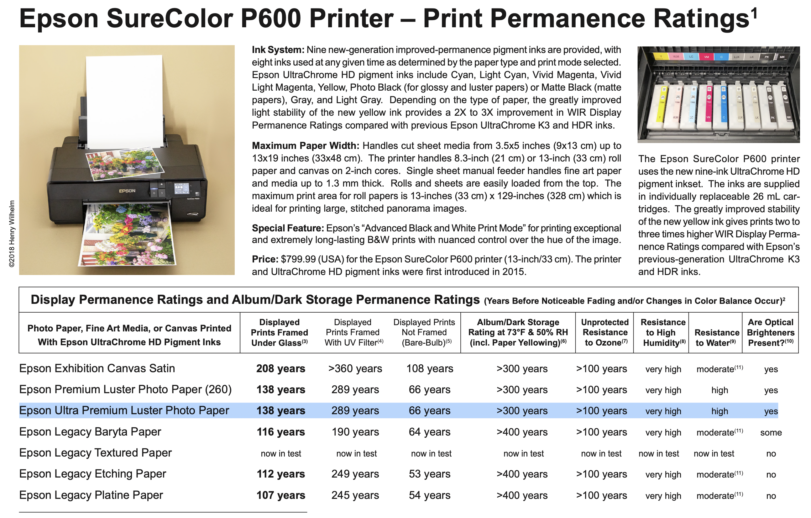

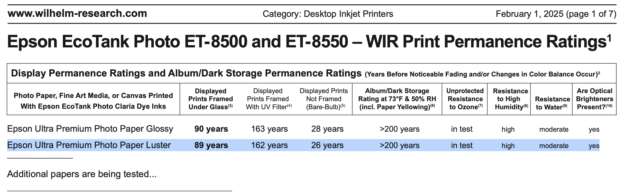

js47
p.1 #16 · Phenomenal Epson ET-8550 13” printer
jwpstl wrote:
Someone said earlier they wouldn’t sell prints from this printer and I’m curious why. Longevity? Quality? Anyone disagree?
I'm not that person, but longevity would be my concern. Wilhelm Research has done studies with both the Epson Claria ET ink and Epson UltraChrome pigment ink. There is only one paper in common between the tests, but it suggests that bare prints made with a pigment printer such as the P600/700/800/900/5000/etc will last ~2.5x longer than prints made with the ET8500/8550 with their mostly dye inksets.
I posted the links above but here they are again (the ET test was updated last week):
http://www.wilhelm-research.com/epson/WIR_Epson_EcoTank_Photo_ET-8500_and_ET-8550_Printers_2025-02-01.pdf
http://www.wilhelm-research.com/epson/WIR_Epson_SureColor_P600_Printer_2019-02-15.pdf
Feb 05, 2025 at 10:50 AM
PhilDuff
p.1 #17 · Phenomenal Epson ET-8550 13” printer
Not long ago I purchased an ET-8550.
Before purchase I agonized some over the issues of dye vs pigment ink and probable print longevity that the ET-8550's ink set provides.
In the end - it became obvious to me that I have no need to make prints that last longer than what the 8550 provides.
My prints are intended mainly for personal display. Maybe some will end up with close family. If others would like to purchase my prints I'd happily print and mat it for them. I seriously doubt anyone will have issues with the 8550's probable print life when informed how to properly mount and install the print.
My stuff will likely get tossed out after I'm gone and never be missed anyway.
Myself certainly and I imagine many 8550 owners that are honest with themselves probably have no illusions of their prints winding up in museums or in the rarefied air of high-end print galleries and/or collectors. That's where pigment ink prints with 50-100+ year lives are de rigueur.
Feb 05, 2025 at 10:45 PM
jwpstl
p.1 #18 · Phenomenal Epson ET-8550 13” printer
Thanks for the info. I guess the question is when selling a fine art photographic print what is the expectation for life expectancy? 89 years is still pretty good.
Feb 06, 2025 at 04:39 PM
