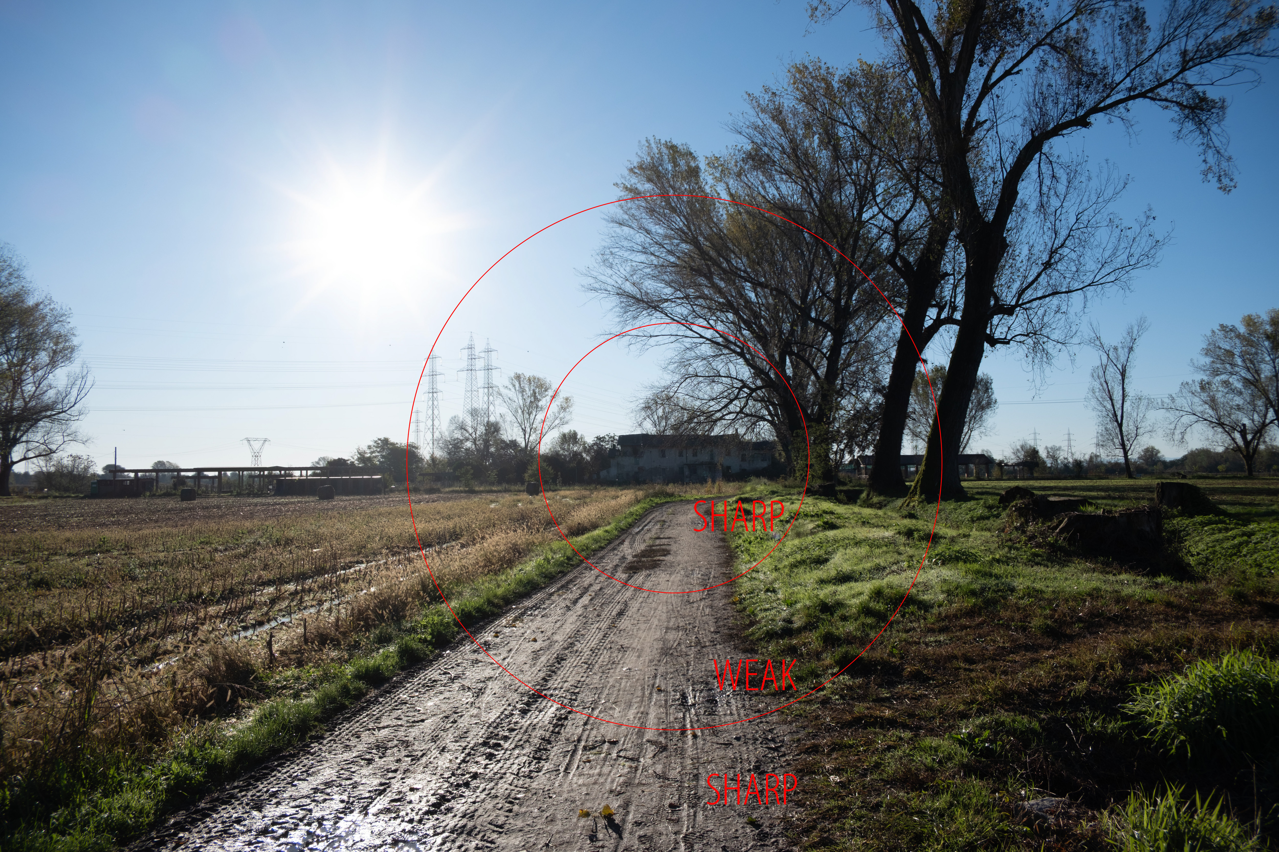

I recently bought the Voigtlander 18 2.8 and find it very interesting and fun, but I'm having an "issue".
At f2.8, with focus set to infinity all is good, enough sharpness in the center slowly fading away towards the edges. As I focus back from infinity I immediately lose sharpness, so infinity mark is right.
Already at f4, but even more visible at f5.6 and f8 (and up) I got a strange behaviour (focus at infinity). The very center looks sharp enough, but then there is a big area around the center that loses sharpness

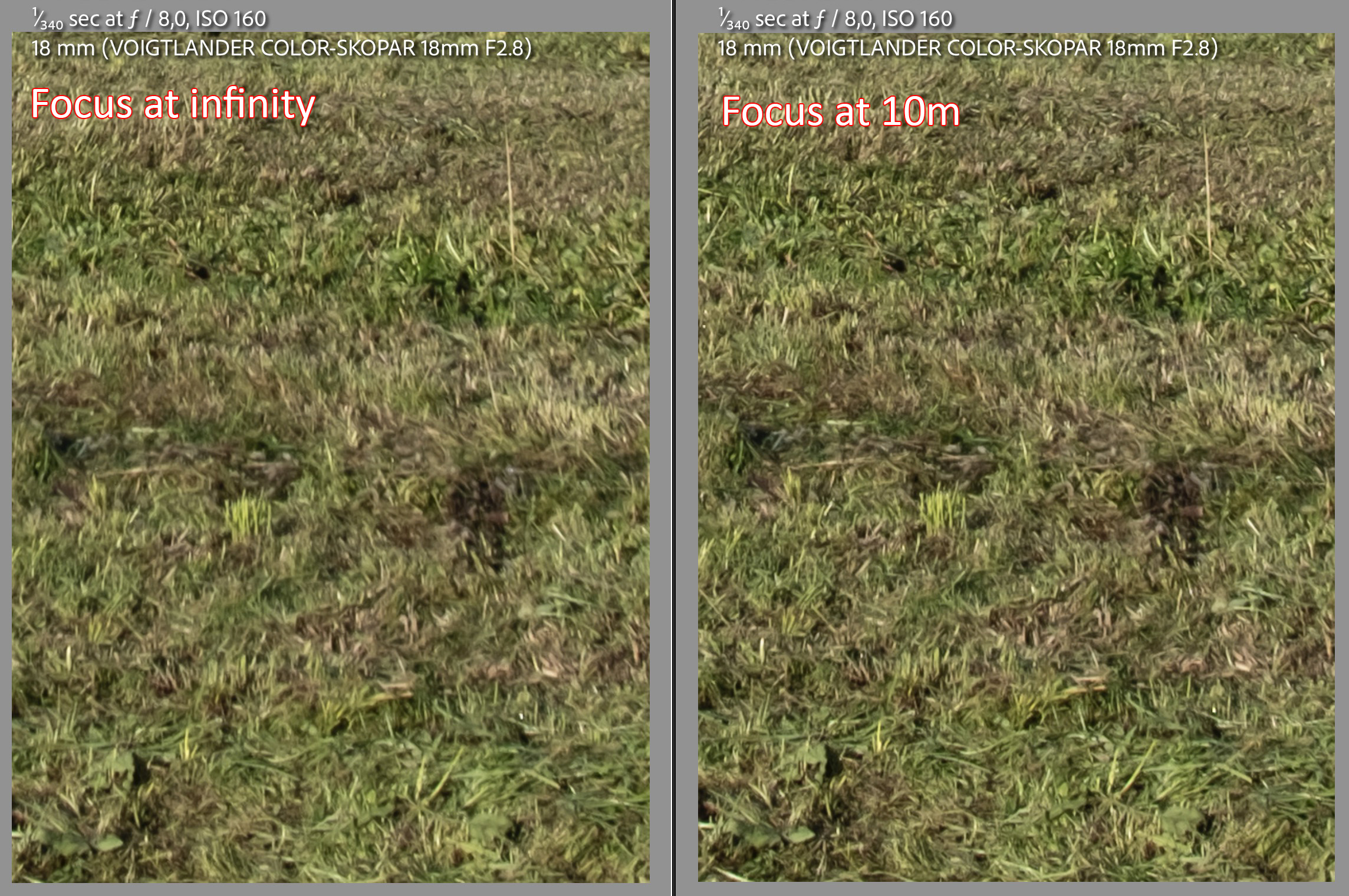

p.9 #2 · Voigtlander 18mm f/2.8 Color-Skopar X-mount Review

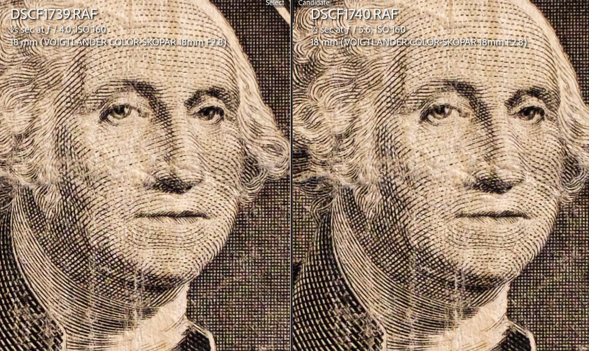

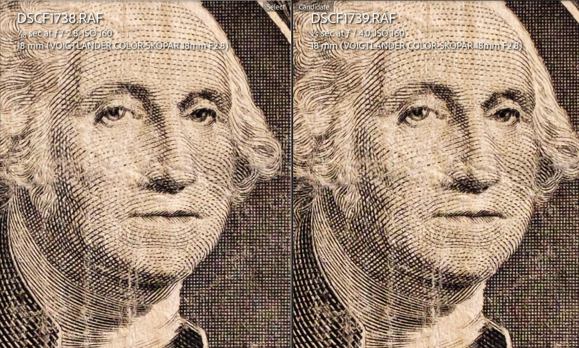

Thanks for your answers!
Yes, I thoroughly read the review, but I didn't think field curvature was so strong—especially with focus at infinity!
This is the difference:
It's a HUGE difference in sharpness over a large central area of the picture. So basically, to really have everything in focus at f/8, I have to rotate the focus lever back by just a millimeter… pretty difficult to do and check every time! It cancels out the convenience of simply setting f/8, focusing at infinity, and shooting!
This is the full image from which i took the crops above, this is the one with focus at infinity:
Nov 15, 2025 at 11:51 AM

From these examples, I think your lens with your particular camera may be focussing a bit beyond infinity when set to infinity focus. I have that with several lenses (and most lenses on an adapter) and yes you do have to pull back the focus from infinity a bit with such lenses and it takes some care. Sometimes, you can add shims to the lens to address this issue. I don't know if you can with this lens and I doubt that you can easily given its compact size, but maybe you can. You can also add a little mark short of the infinity mark at the spot that works for best infinity focus and just focus to there before you bring the camera up to your eye when you want to shoot at infinity. Still not ideal, but I have never found that to be too big of a hassle.
Nov 15, 2025 at 12:37 PM

I don't think this is the case, because at f/2.8 with focus set to infinity I get the sharpest result, while with focus set to 10 m the sharpness already becomes slightly weaker.
Also, at f/8 the edges are sharper with focus at infinity than with focus at 10 m, even though the loss of edge sharpness at 10 m is far less severe than the difference in mid-field sharpness when comparing focus at infinity versus 10 m
Also, at f/8 the edges are sharper with focus at infinity than with focus at 10 m, even though the loss of edge sharpness at 10m is far less severe than the difference in mid-field sharpness when comparing focus at infinity versus 10 m
Then that sounds to me like your lens is experiencing focus shift as you stop down. If a lens is well focused at f/2.8 at infinity but no longer is In focus at f/8 that is focus shift. So although the lens might not be focussing past infinity at f/2.8 that does not mean it isn't focus past infinity at f/8. With focus shift that is totally possible.
Yes, indeed if I focus at f.2.8 (close subject) and close down to 4 I have to refocus otherwise I lose maximum sharpness. What souds strange though is why the edges are sharp when focused at infinity while they lose a bit stepping back, but the central area improves? Might be field curvature. At the end I'd just like to know if my lens is ok...it would be very nice to campare two, but not easy to do of course, very rare lens to find, at least here in Italy

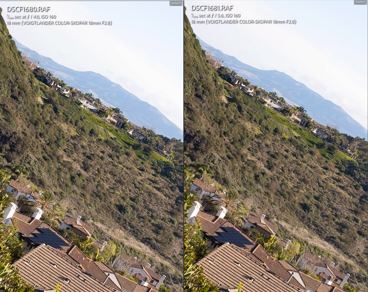

Fred Miranda wrote:
<div id="cur" name="cur"></div>
<a href=https://www.fredmiranda.com/forum/topic/1846043/0#ql>Back to Quick Links</a>

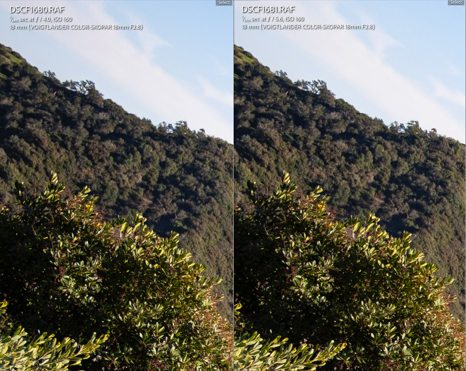

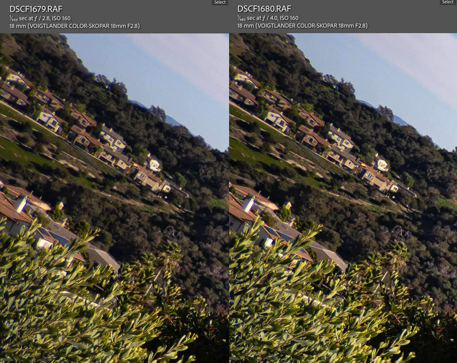

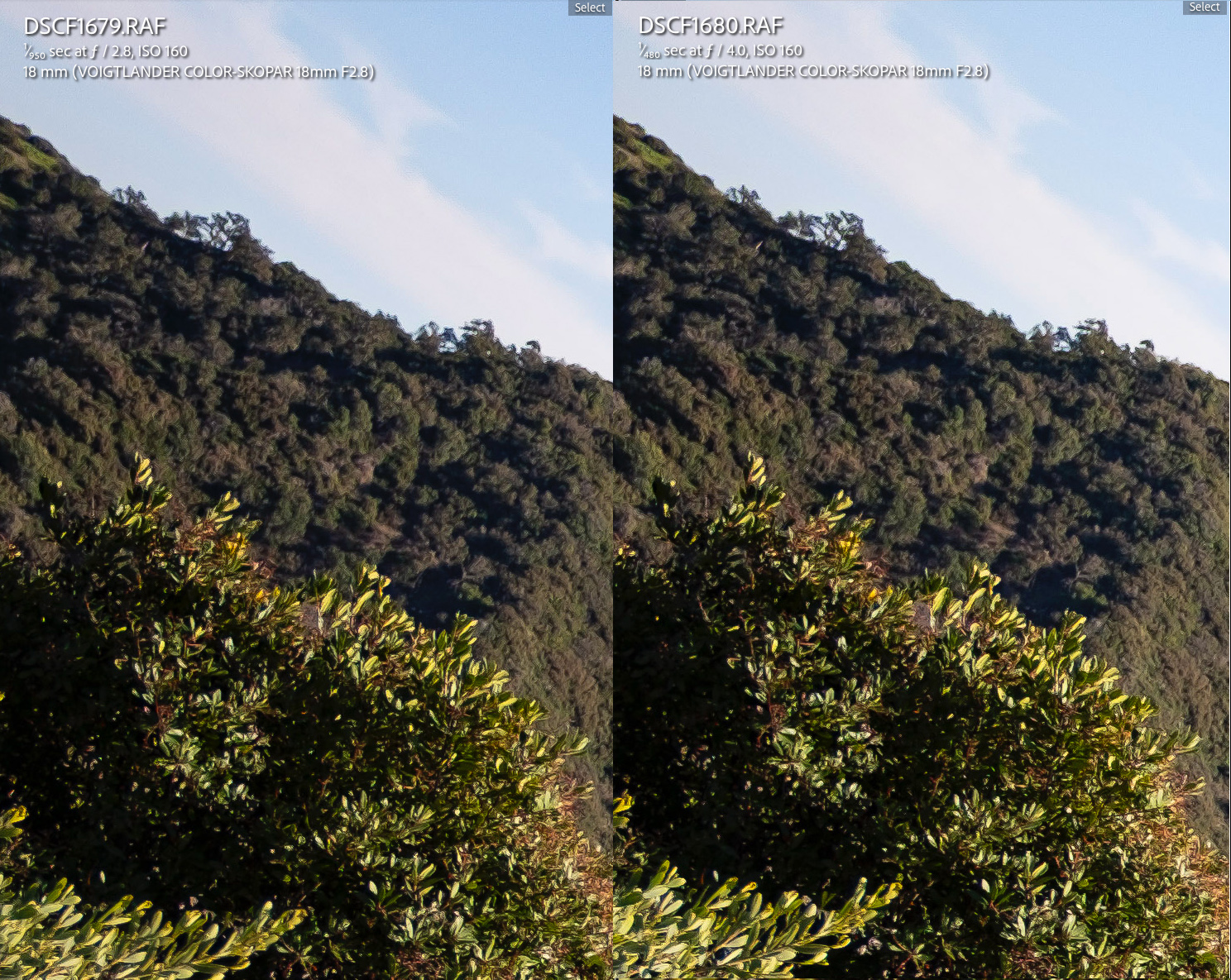

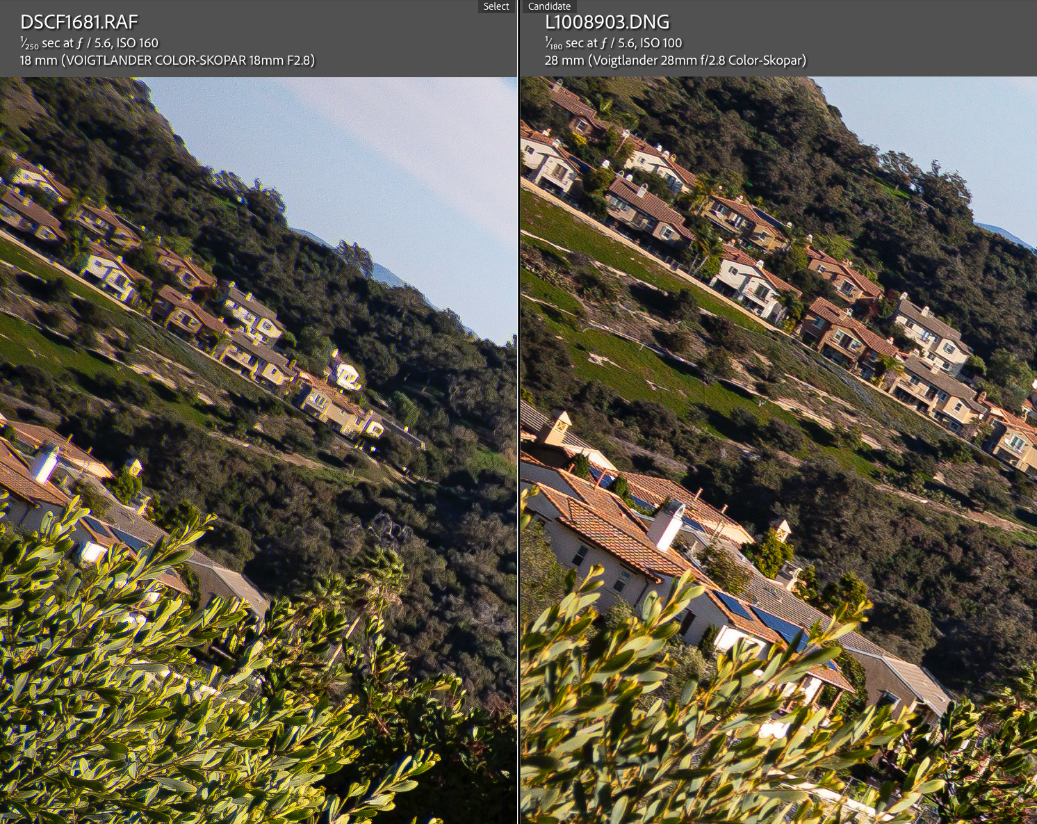

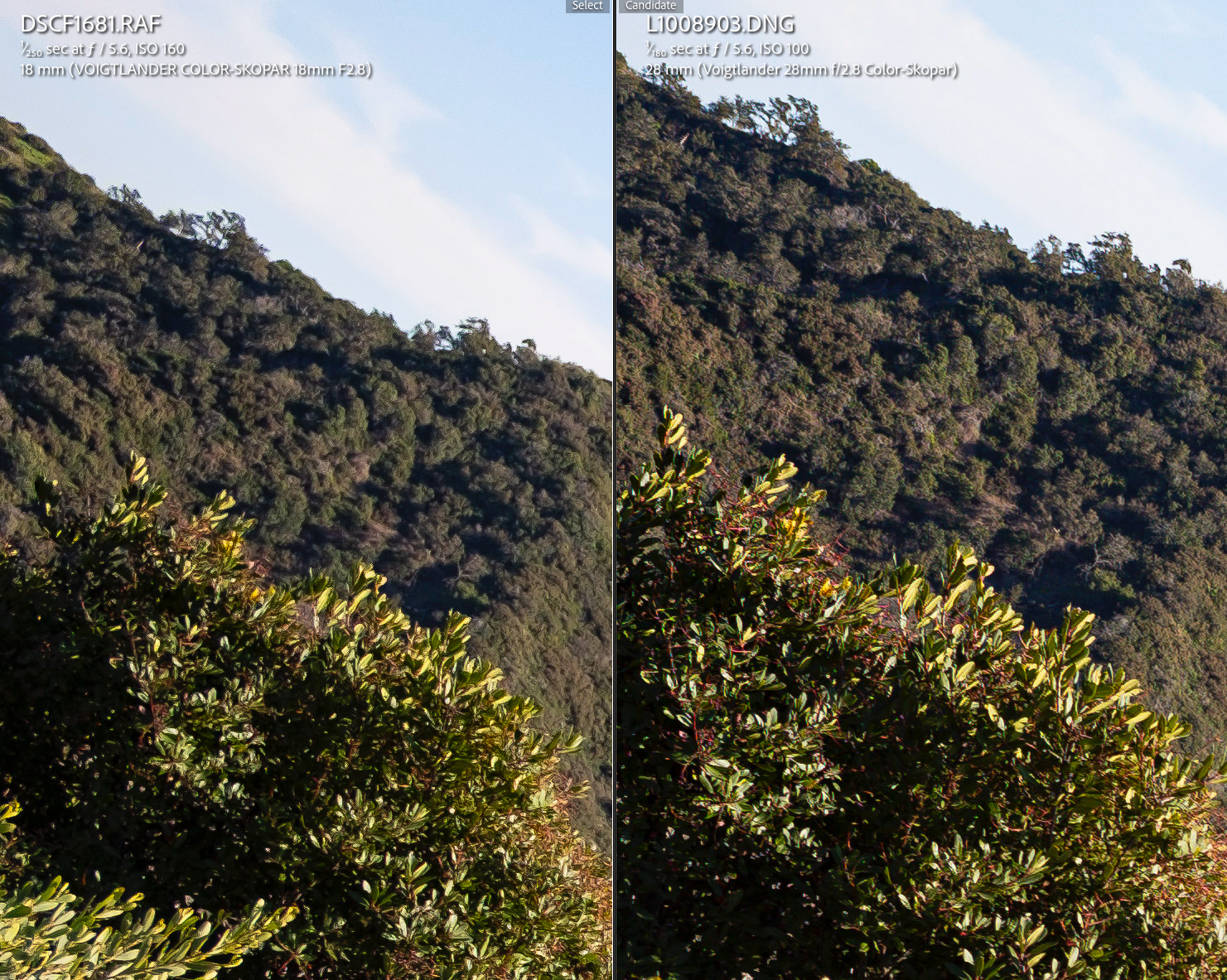

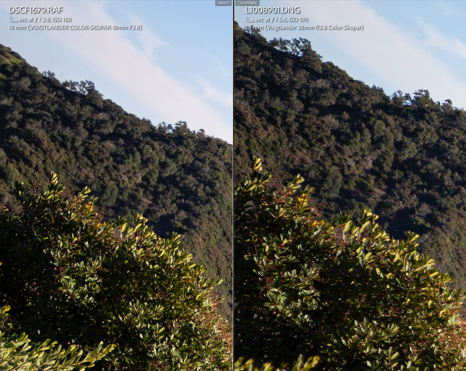

Field Curvature
The Voigtlander 18mm f/2.8 Color-Skopar has a field curvature shape that varies depending on the focused distance. When focused up close, the curvature seems to extend outward, while at medium distances, it becomes flatter. At longer distances beyond 5m, the curvature shifts inward, similar to the 27mm f/2 Ultron. This typically results in better out-of-focus rendering towards the corners of the frame, and also makes it a preferred field curvature shape for shooting landscapes where the distance center and foreground sides appear sharper.
To demonstrate this effect, I've processed a sequence using the
...Show more →
Hi Fred, sorry I do not completely get your field curvature explanation, does it explain the behaviour of my lens, as I described in the previous posts? Many thanks!
Nov 17, 2025 at 05:32 AM

Yes, It sounds like your lens has both focus shift and field curvature. That means you will need to focus at shooting aperture and get the best compromise across the shooting plane, which means probably checking focus in several spots. That can be a pain as you have recognized, but that is how some lenses perform. You could mark on the lens where typical best compromise is for long range shooting, which may work for you, but having both issues definitely is a bit of a pain as I find focussing at wider apertures with field curvature can be useful for setting focus and you can't do that with a lens that has focus shift.
