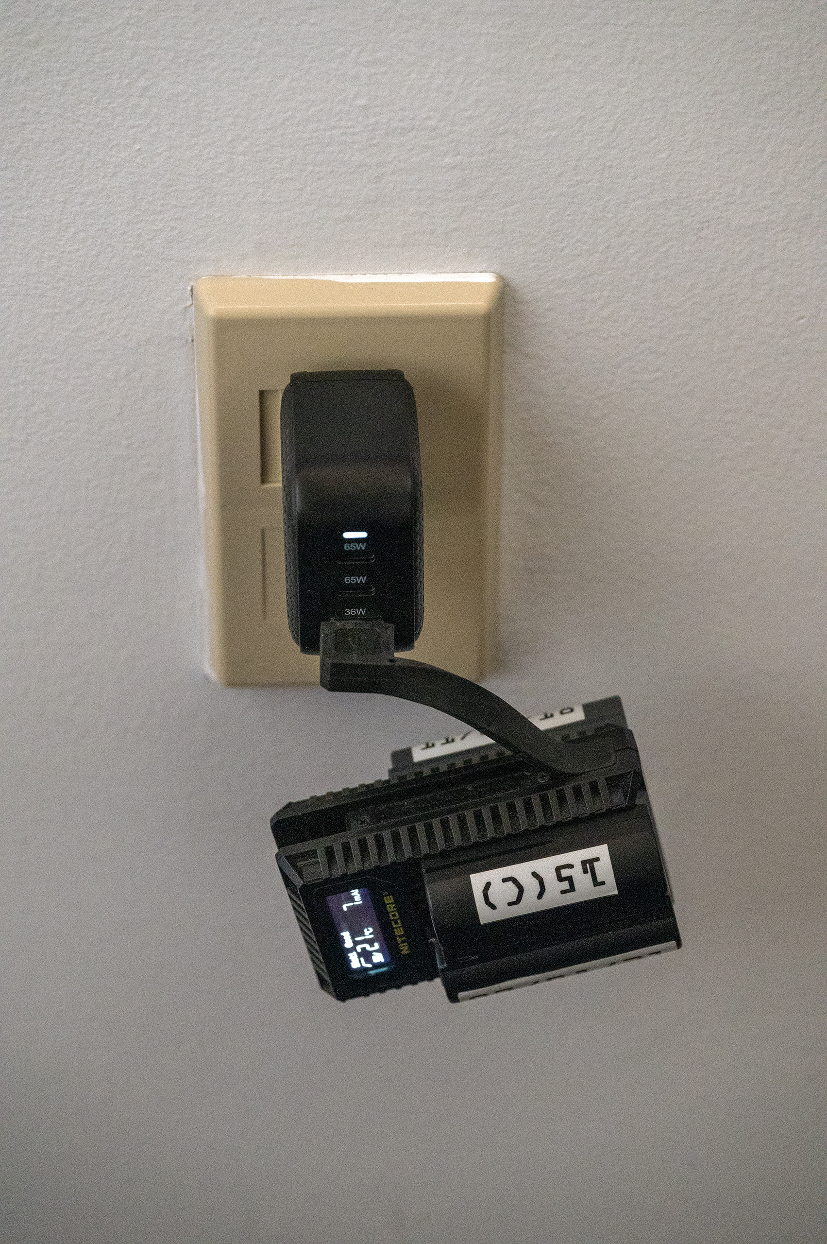

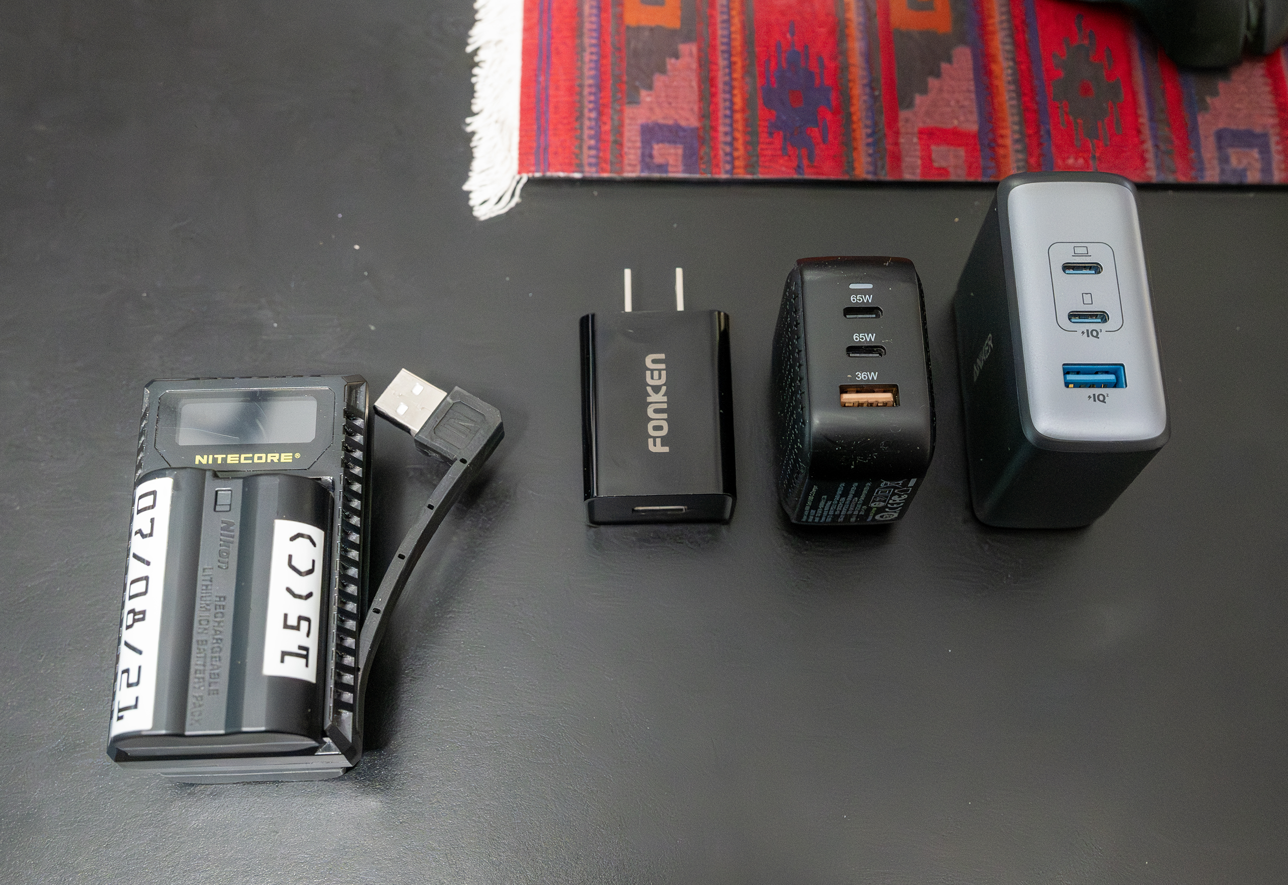

sjms wrote:
that is relevant to the charger output capability itself. now the input is from a power supply as seen in the pic) so it is acting as a simple power plug in this type of build scenario so it can accept from other various sources. now with data transfer stuff, things will be "different"
https://www.howtogeek.com/690160/usb-type-a-connector-everything-you-need-to-know/
Compatible Batteries Nikon EN-EL15, EN-EL15a, EN-EL15b, EN-EL15c
Compatible Models Nikon D600, D610, D750, D800, D800E, D810, D810A, D850, D7000, D7100, D7200, D7500, 1V1, V1
Input Voltage DC 5V 2A
Output Voltage 8.4Vą1%
Output current 1000mA (max)
Input Type USB
Output Type Connection Pins
Dimensions L-3.35"xW-1.97"xH-1"
Weight 2.33oz
nikon charger: 8.4v, 1.2a
nitecore output is 15% less than the nikon charger. how interesting!
Jan 28, 2024 at 04:07 PM

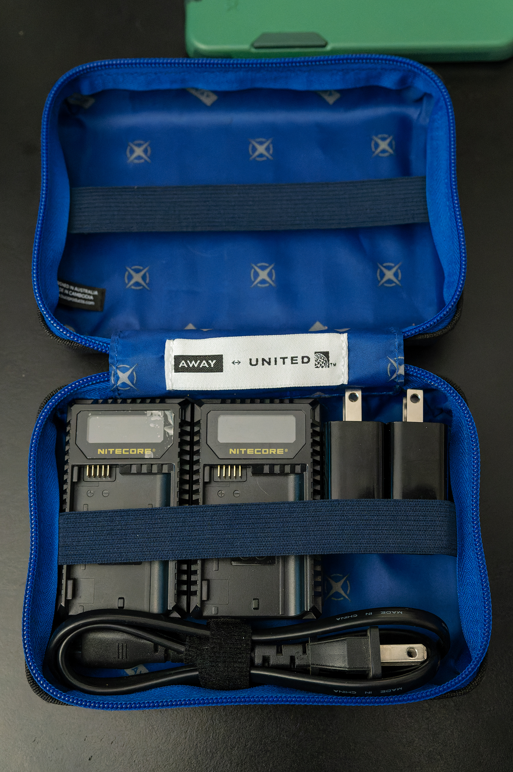

Can anyone provide some statistics for charging two 15c batteries? How long does it take and does the charger provide enough power to charge to 100%.
From Nitecore's own information:
As I stated in a previous post, unless this was some kind of perpetual energy machine, there was no way that it could generate more power than the USB-A input so it will take longer to charge. Assuming that one is charging two 15c batteries with a capacity of 2280 mAhr beginning with a residual charge of 10% (not unreasonable). That's a total power of 4104 mAhr which would need to be supplied. The batteries voltage is 7v and assuming 100% efficiency, one would suspect that a full charge would take on the order of 3.5 hours.
Feb 03, 2024 at 12:17 PM

the output parameters are there; and you said it.
it's NOT possible to charge 2 depleted batteries in 2 hrs with the cited output. do you really need actual users data to confirm what you already know?
Feb 03, 2024 at 01:19 PM

DanFekar
p.2 #11 · EN-EL15C charger recommendation
I have two of these and have been using them for quite a few years now, for all the different EN-EL15 batteries. It is not fast, but it is reliable.
Did three tests over the last couple of weeks, charging two 15c from depleted to 100%. It takes 4 hours and 40 minutes, +/- 10 minutes. Connected to a 100w wall charger from Satechi with a quality adapter from USB-C TO USB-A.
The two hour claim makes no sense and must be a typo. Not even with two EN-EL15a. At least not to my experience over many years, and the tech specs from Nitecore confirms this.
Feb 24, 2024 at 07:12 PM
