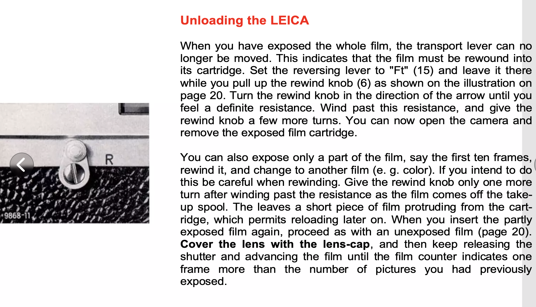

I wasn't aware this was doable. As per the Leica M2 manual, it's possible to switch the film midway without completing all the shots. For example, you can switch from an ISO 400 film to ISO 800, or transition from color to black and white.
Has anyone experimented with this? The instructions recommend covering the lens, noting the exposure number, changing the film, and later reloading the film and advancing it to the previous count.

All the time! Even if you have a camera that rewinds all the way automatically, a leader puller (or another wet leader) is all you need. Just note how far you were, and go a few frames past that in the next camera to give you some buffer. As noted, do it with the lens cap on.
The only caveat I've found is with cameras that completely wind the film when you load, and then rewind with each shot.

I've done this with Pentax and Contax film cameras. Should work with anything that you can initiate a mid-roll rewind. Biggest challenge for me, is to remember which frame was up, when the rewind was started. I usually skip this frame when putting it back in a camera.

I stopped doing mid roll changes when a few times accidentally used a partially exposed roll as fresh film. I also stopped leaving leaders out after finishing a roll. Also carrying two cameras helps a lot! When I had .58x and .85x bodies I can carry two bodies and load them with 100 and 400iso film.

Any film camera can do this. It is more inconvenient on cameras with power rewind if they rewind the leader but you can still the fish the leader out if needed. Unless you only have one film body It is not worth the faff in my opinion.

When you feel the roll being pulled off the spool you attach it to when loading, maybe even hear it coming off, stop, and pull it out of the camera. Not that hard on manual rewind film cameras, really. Can try it in a dark room like a bathroom, having no light, to be on the safe side, and feel if the film is rewound, rewinding if necessary (probably won't be.)
then mark the number of exposures on the roll. I've probably even scrawled it on there using a cable relesse, the part that you put in the shutter release often kinda sharp. A pocket knife could be good, or if you're more organized than I am, a sharpie in your camera bag
Obviously you need to put the lens cap on or something to keep light from entering the lens (M, highest ss good idea f/22 etc or dark bathroom or something) when you reload and advance the film past the exposed part, to avoid double exposures. I usually do 2-3 extra, to avoid double exposure. I've probably done it on Nikon, Pentax, Olympus film SLR'S etc
