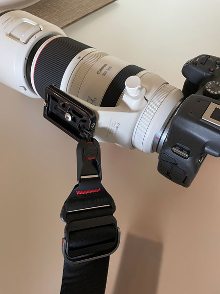

I attach my PD anchors to a arca swiss QR plate, I can move it from lens to lens as i like and I feel is very supportive.
I also replace all my canon feet with arca swiss replacements from Jobu. Very strong.

That said I use too a strap with QR on the lens collar foot - with additional plate, and have a small strap going from the lens lugs to the strap itself

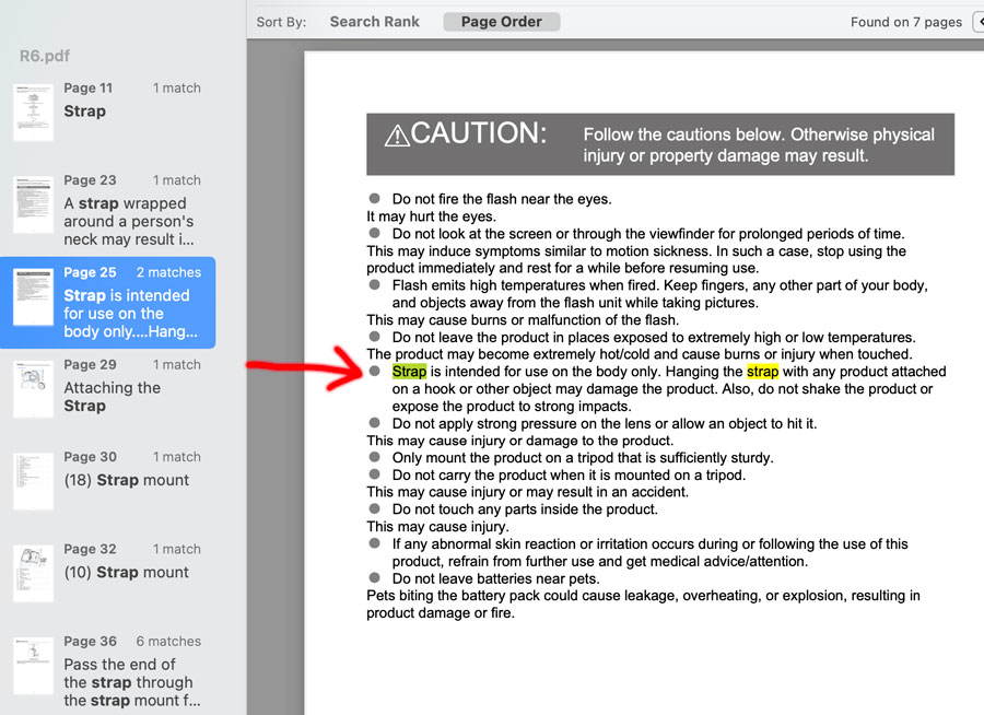

In the RF 400/2.8 and 600/4 manual, Canon issues a warning:
"Where the lens is mounted on a camera, make
sure to properly support the lens. If you hold only
the camera, the lens may fall off the camera and
cause a malfunction or injury.
OO Be sure to attach the included strap to the lens
when carrying a camera around with the lens
mounted on it. Using the strap for the camera may
allow the lens to fall off the camera and cause a
malfunction or injury."
It's very obvious that the lens has to be supported and not hung from the camera. Other manufacturers' similar lenses have similar warnings.

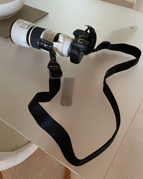

Alan Kefauver
p.1 #16 · Supporting big whites with a camera strap.
I just sent a link to this forum topic to Peak Design. It'll be interesting to see what they say.......

Agree, though with my 100-500 I use an anchor attached to the foot of the collar and a single strap with a safety tethered to the camera body, whereas with my big white primes, I use straps attached to the lens lugs affixed to a larger harness system. Whether one chooses an Opteka, Black Rapid, a Cotton Carrier, or any of the myriad of lens/camera mount systems, it is prudent to figure out what works best for the user and type of shooting.
