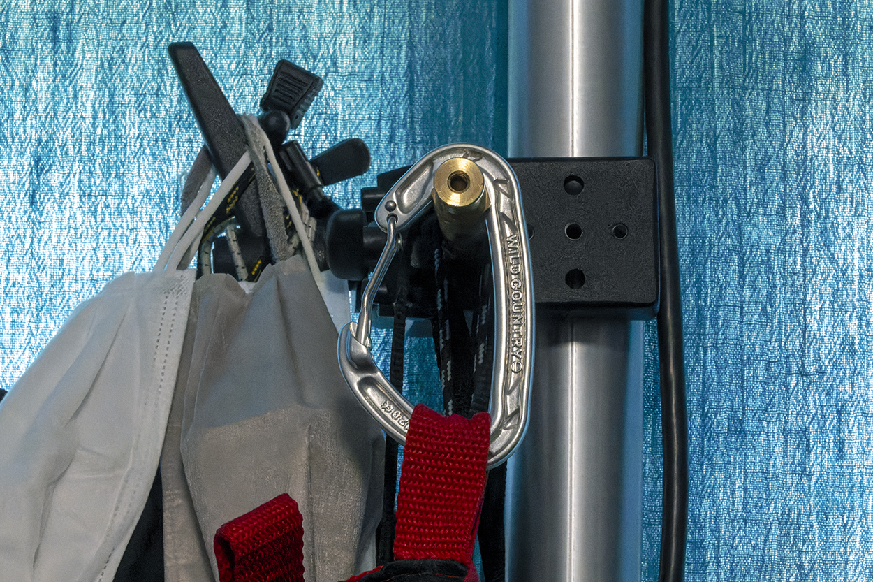

depending on post work
oh, and no lens noise from this setup.
relativity
  NIKON Z 9    NIKKOR Z 24-120mm f/4 S lens    120mm    f/22.0    1/20s    25600 ISO    0.0 EV
