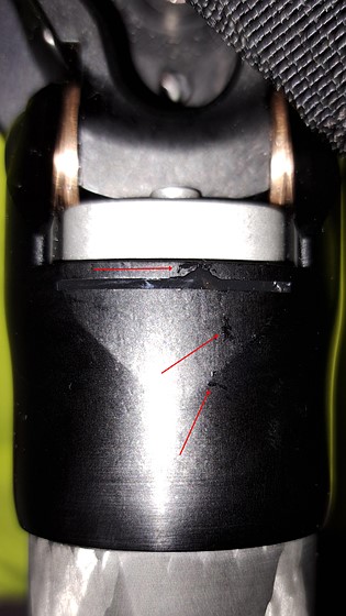

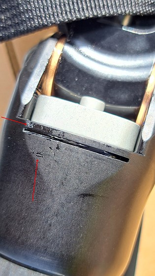

A very strange and weird problem with new RRS Tripods?
I received my TFC-33 brand new from B&H last week. I immediately noticed that 2 of the legs were difficult to pull out and push in, while 1 leg functioned very smoothly. After looking around, I noticed the air vents (RRS call them Clevis's) at the top and on the back of the legs were the causing the problem. They were filled with a rock hard but clear substance. It looked to me like crazy glue or some kind epoxy. What made me realize it was not supposed to be there was how messy it was applied. Not to mention why would RRS design the air vents, talk about them in the marketing material, cut the slits into the carbon fiber, then to just plug them up. No air flowing through the air vents?
And even if this is intentional, why would it be applied so messy that is drips on to the tripod legs? I couldn't even get it off if I wanted, whatever it is, it is rock hard.
I returned the tripod, and got the new TFC-33 today, and again the same issue!
What is going on? I can only find a couple images on the Air Vents clearly online, and they all seem clearly "Open" and not blocked by clear epoxy.
Anybody with Mark 2 RRS tripod can confirm this, or care to share a photo? I would appreciate it.
I already emailed RRS about this, but they are still closed until tomorrow.
I also spoke to a tripod specialist today at B&H, and he said that is 100% not right, and is now sending me a 3rd copy of the same model. Hopefully third time is a charm.
Both tripods were also definitely brand new and not returns. I could tell by how it was sealed, it came direct from RRS this way. 100%.

Thanks you, I also found zero info on this issue anywhere online. It perhaps was a bad run or bad batch only manufactured recently.
I did send all the photos to RRS already. They have great customer service, so I should hear back from them tomorrow when they reopen.

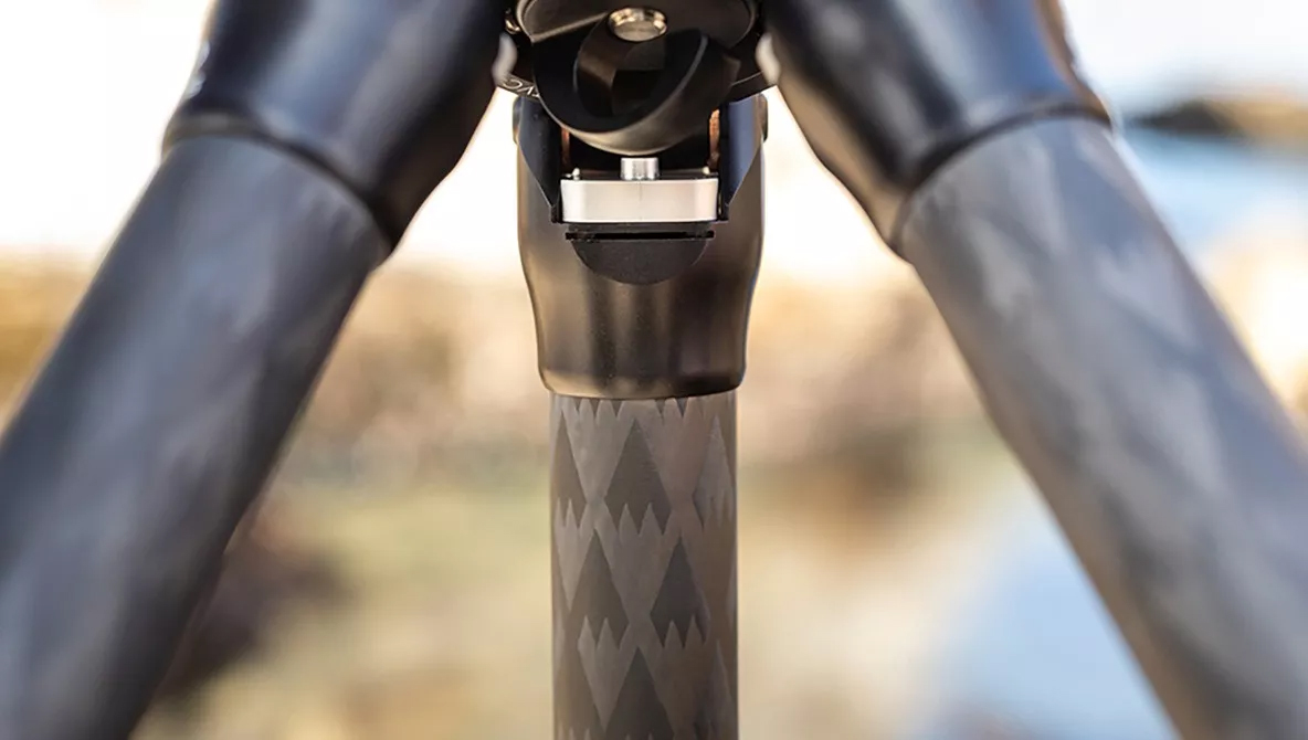

That first image is just a stock photo, it was the clearest photo I could find of the Air vent in the back.
I guess it is possible it was some kind of protective film. But that wouldn't explain all the "Splatter" I highlighted with arrows showing the substance outside the air vent. Those spots are rock hard, and no way to get off. So even if I was able to clean out the air vents, it's still all over.
One more thing I didn't mention. Both tripods came with a sticker on the top plate that said.....
"Remove after inspection".
(I have a photo of the sticker, I'll have to figure out how to share images)
This is my first RRS tripod so I'm not sure if that Inspection sticker was meant for me or meant for some in quality control at RRS? But I own RRS Ballheads, plates, brackets, and none of them came with a warning label to inspect before using it.

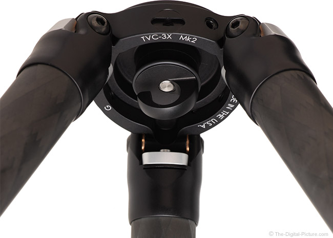

found another stock image - indeed the vent looks cleaner....hmmmm

Yea it is hard to see in my photos. But the vents on mine are completely closed off. No air goes through them at all. The 1 good leg, you can feel the air push right through the slot.
And with the leg fully extended and than pushing the leg up, it has a lot of resistance. The one leg that is clear, folds up so much smoother.

The legs have to be attached to the spider in some way. Probably epoxy. I'd hazard a guess that the epoxy was applied poorly (either excessively or in areas it was not supposed to be) and it pushed into the vent area.

yes that does look like a RRS issue
those vents should be clear of any obstructions. if not you have 2 choices:
1- send it back as bad from stock and B&H should send you a return ups tag. as i see they have stepped up to the plate.
2- if you have easy access to NYC (big assumption in the part of NJ that is close to PATH). take it back and have another pulled from stock and give it the full function once over and final inspect while there. i did send you a PM.
i'm just interested party that is not related to RRS other than i purchase stuff from them too. i do have a somewhat technical background. i would like to photograph the issue and send it to the appropriate individual. as it looks like stupid was done then they need to know and account for it for the consumer and themselves.
it looks like a combined issue in building and QC.
we gotta keep them honest.

Yes that is completely possible, and makes a lot of sense. The person assembling the new tripods is applying wayyyy too much adhesive to the top of the legs before plugging it into the spider, and it just clogs up the air vents.
