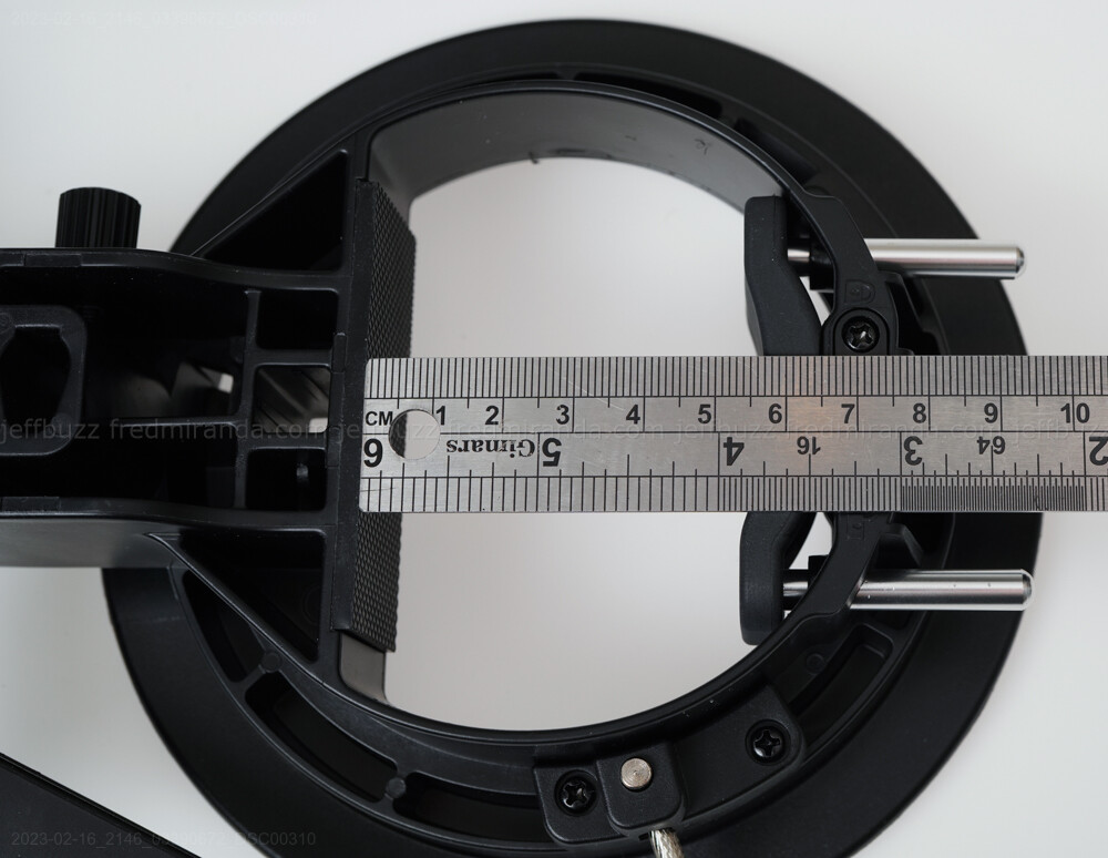

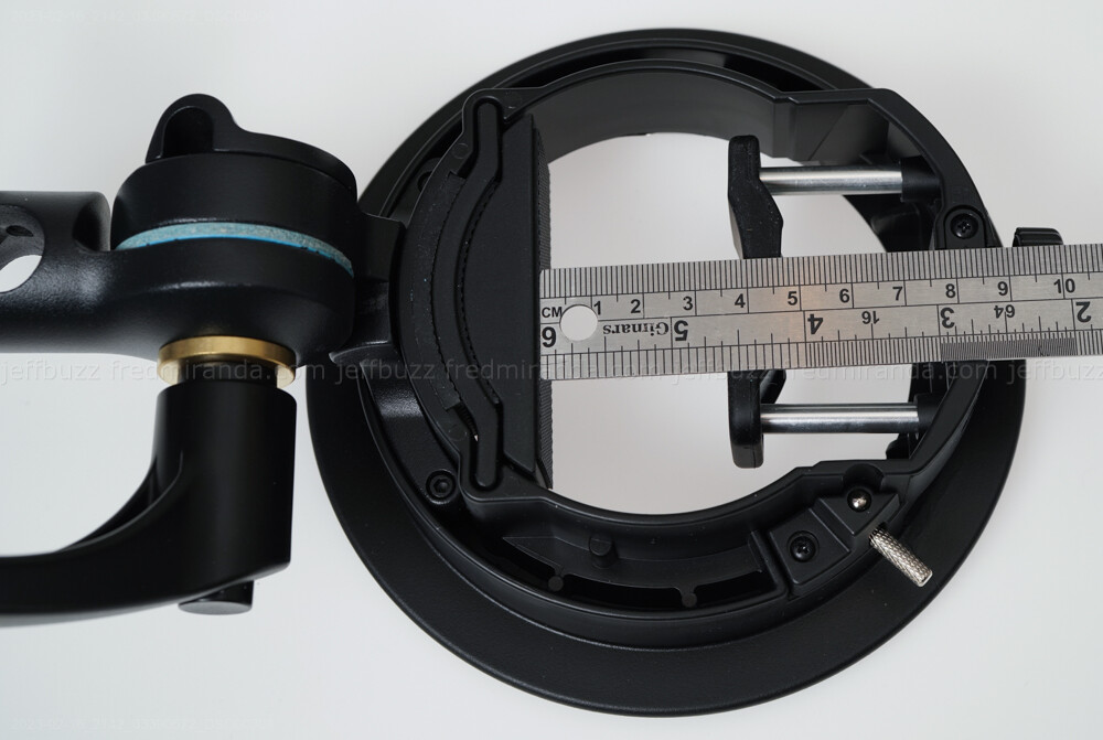

I have both kinds of brackets so I measured for you. S2 will close down to 40mm. Original S-type bracket closes to 30mm. So you might be better off with the old style which do not fit the round head V1 lights but close down tighter.
S2 bracket closed
S bracket closed
S bracket open
