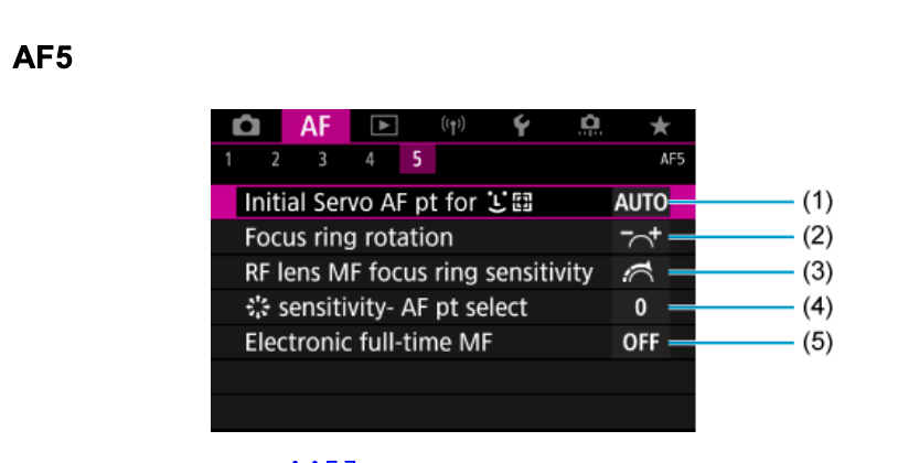

I'm looking at the R6II manual and it appears Canon has made the similar change to the R6II as it did to the R3 and R7.
Can someone explain this. On the R5, 6 there is a menu called Initial AI Servo pt for. With my R5 I'm on Auto. When the camera wakes up I don't need to press any buttons and the white pre-focus square is looking for an eye. I press the shutter half way the blue AF square takes over. I don't use a BBF for this. With ML I work with the shutter button for both Metering and AF Start. I have other uses for the BBF.
1st image shows the R5 & 6 manuals that have Initial AI Servo pt for.

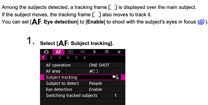

R3, R7 and R6II do not have the Initial AI Servo pt menu. The 2nd image shows this new menu for the R3 & R7. Subject Tracking.

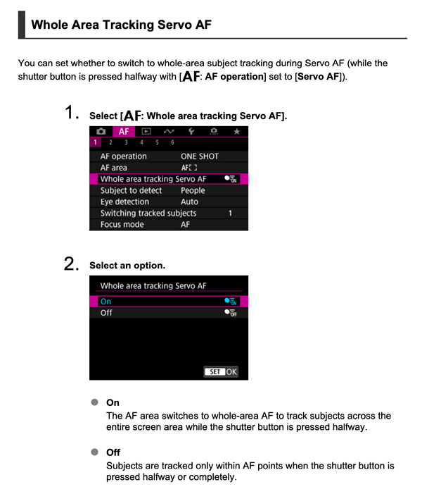

The 3rd shows the R6II menu. More text, same location, same Icon.

I think it means you can use one of the wide zone AF settings and it will only follow the subject within that area, rather than the full frame.
On the R6 I have initial servo af point for face/eye tracking set to pick up from my manually set focus point. I BBF with a manually set AF point without tracking and have the * button set up for tracking. I'll switch from BBF to * and tracking will pick up from my manually set AF point. For me this is better in environments with more than one person/face so that I can be more sure the camera will focus on the intended subject (though sometimes it still jumps to someone else). In a way it's kind of like focus and recompose. I'll move the AF point over the subject, switch to * and recompose.

As I understand it, the basic difference is that on the R5 and R6, subject tracking is a separate AF mode which always uses the entire screen, and you can choose the starting AF point where it will look first. On the newer cameras, it is a behavior that can be toggled on or off for any of the regular AF modes (spot AF, wide area AF, etc.).
So, by default on the newer models, tracking is constrained to operate within the portion of the screen dictated by your selected AF mode. I believe the "Whole Area Tracking" menu gives you the option of having the camera switch automatically to the entire screen when a subject is detected (for tracking).

Yes for R5 and 6 the Initial Servo AF pt for can be set to use a specific AF starting point or let the system do that automatically which is when it Auto.
Got some feedback from a R3 user which would apply to the R7. That enabling that menu basically activities the white pre-focus square which will start to look for an eye without any user user intervention. The icon in the description shows the whit pre-focus square. So the same as "Initial Servo AF pt for"
The instructions for the R6II says Whole area tracking Servo AF says while shutter is "half pressed". I hope that is just a typical translation thingy and it works the same as the R3/7. That is a nice feature to have.
