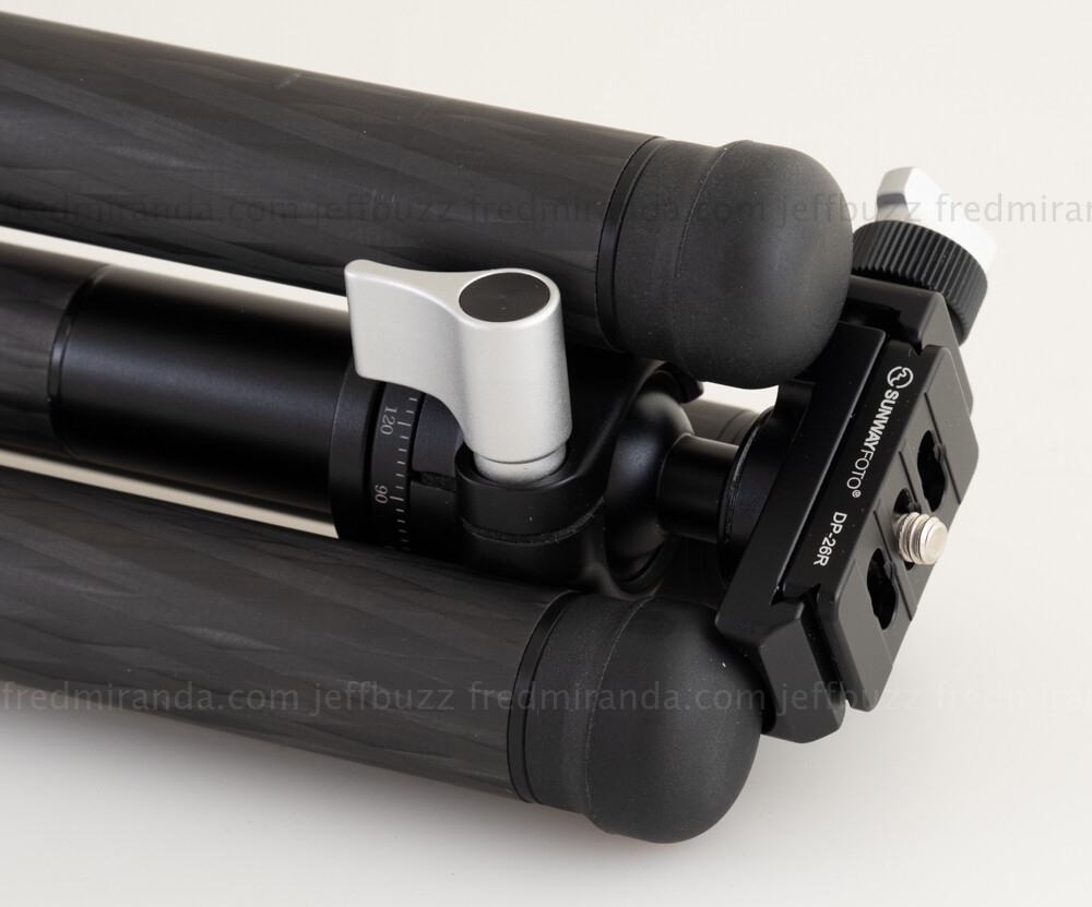

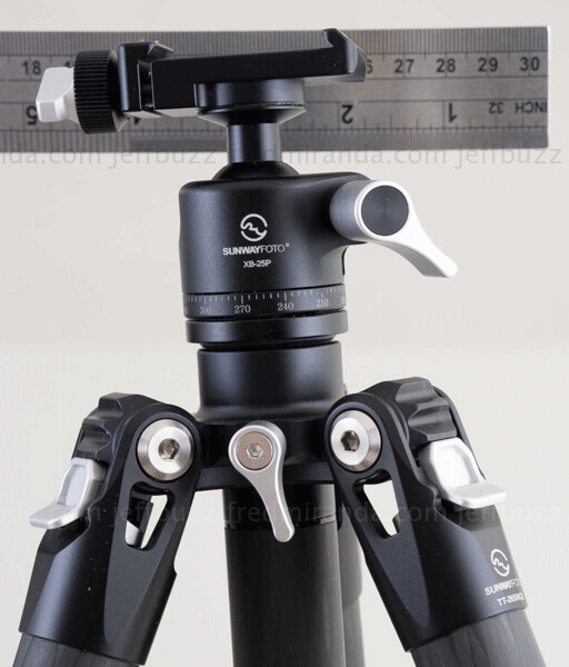

This same tripod (or at least clones of it) are being sold under a variety of brand names. Not sure who the actual manufacturer is. Certainly intriguing. I do wonder how the internal expansion lock mechanisms will hold up in dirt and sand.

actually the Marsace XT-15 centerpost is considerably different using a trilobal type centerpost where the sunwayfoto and fotopro use standard CF posts (i believe the CP on the Marsace is alloy which in this case is the better material to use)
just remember you buy it you own it. you break something on it you have no support.

Yes, definitely some variations in design. I was mainly intrigued by the collarless, internal locking leg designs. Certainly a good way to save weight. My concern with those main legs is that I've have ski poles with that type of locking system fail. They were very temperamental only being exposed to snow. Not sure how such things handle dust and sand.
I can vouch for both Sunwayfoto and Fotopro support. Both exist and both are responsive. I have no experience with Marsace. Seems like many of these products are available under a variety of names. Sometimes you can save a buck buying from one of the lesser known brands. You take on some risk of potential future expense if there's no domestic warranty or support under those brand names. You may still be able to get parts and service. But you might be dealing with expensive cross-border shipping to do it.
