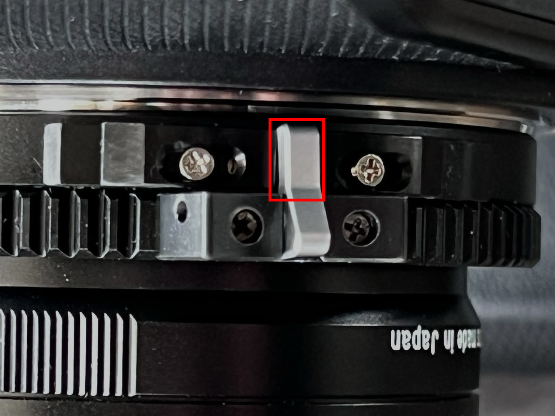

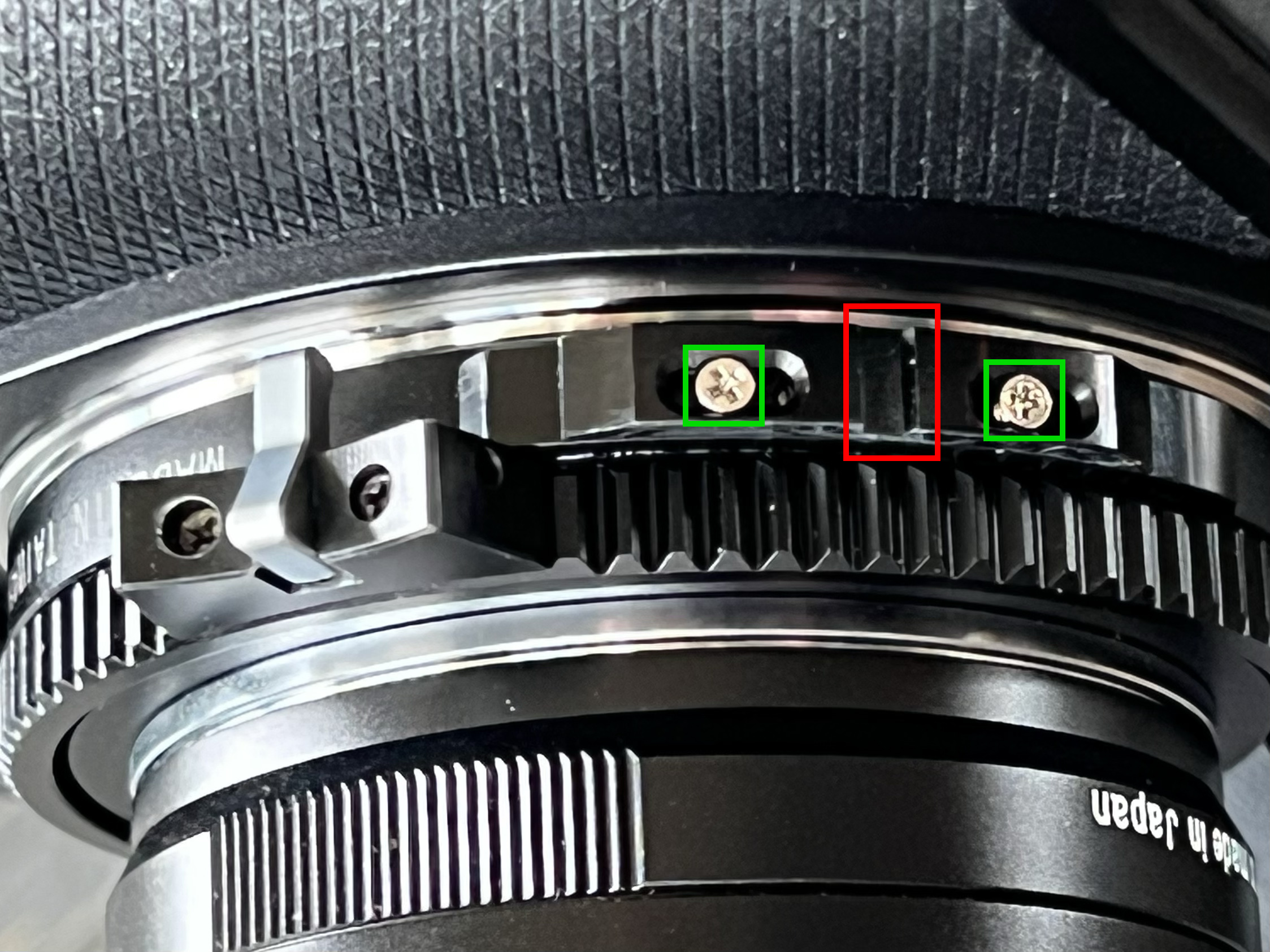

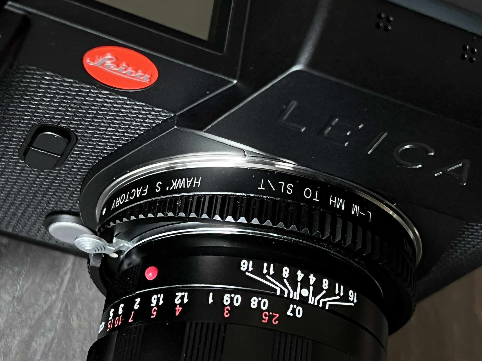

This will be short. It works. Solid operation and no play in the mount.
But the standout feature here is the adjustable infinity hard stop, which is a huge plus. Most adapters are slightly short, and your M lenses will not hit infinity at the hard stop, which can cause IQ issues, especially for M lenses with floating elements. Having the adjustable infinity position makes the experience much more like using an M body – no more having to check infinity focus in the EVF for every shot. So even if you don't want to use the macro function, this adapter still allows you to set the infinity hard stop specific to the body and/or lens you're using. All my M lenses hit infinity at the same place, but if I had an oddball lens that hit infinity slightly before the hard stop, I could purchase one of these to use just for that lens and always keep them paired together.
Do not buy this adapter direct from the Hawk's Factory website, at least until the pandemic is much further in the past. I had to get my money back via PayPal due to back and forth with missed delivery window promises. Instead, buy this from eBay from someone selling a used one or from a Chinese camera store that has them in stock. In the case of the L-mount version, you may pay more for it, but you will actually get it. I only see they have M adapters to Leica L-mount, Sony E-mount, and Fujifilm X-mount on the Hawk's Factory website, but on eBay I have seen ones for Nikon Z-mount and Canon R-mount as well. I'm not sure if the Z and R mount versions are new or if they stopped making them.
Green: loosen screws to adjust infinity position / Red: notch for infinity lock
Helicoid locked at custom infinity position
