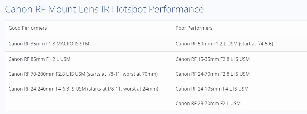

Have you seen this site? It identifies the RF 24-105mm f/4L IS USM as a "poor performer" for IR.
Kolari Lens Hotspot Database, https://kolarivision.com/articles/lens-hotspot-list/
(screen shot of Kolari Lens Hotspot Database, https://kolarivision.com/articles/lens-hotspot-list/)

I like to highlight agreement between real world (what you said) and online info (the database). Consistency helps to establish credibility, although Zolari is already pretty credible (which doesn't help much, if you don't know them).
I was interested to see that a couple of my EF-M lenses are in the good performer category (not shown in the part of the db that I copied and posted above). That's a way-ahead for my M5/M6, after the EF-M line gets dropped (i.e. five seconds after the first APS-C RF camera is announced).
