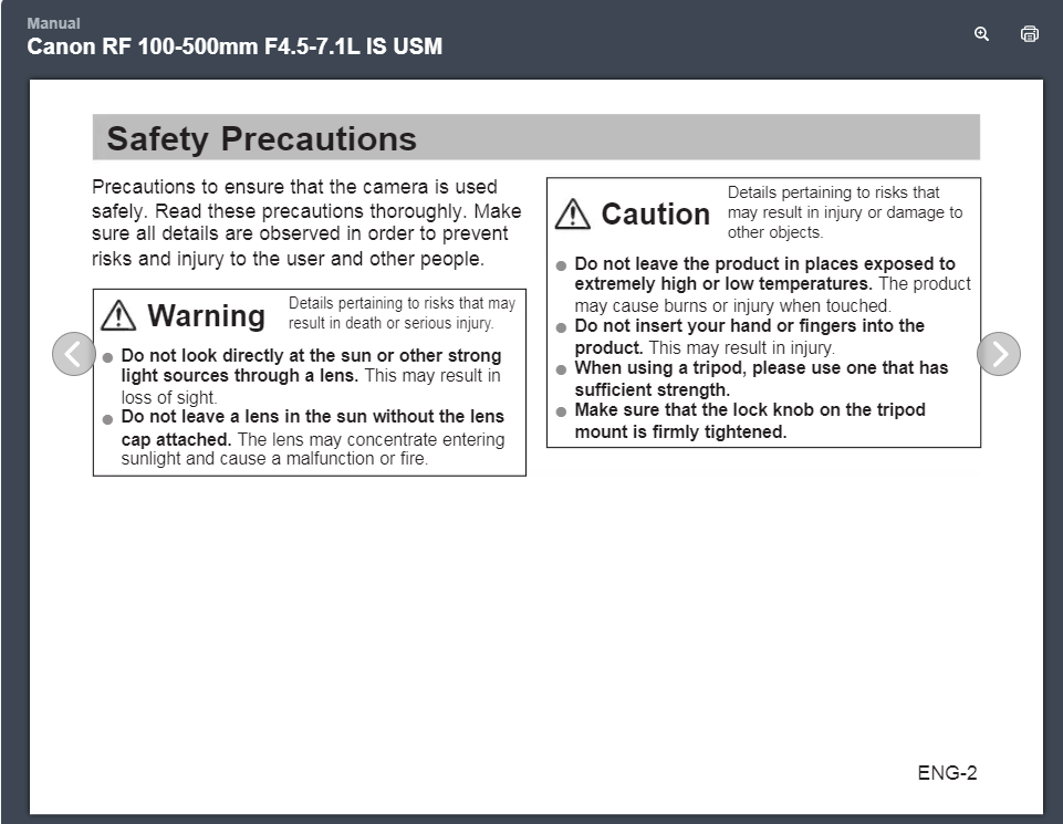

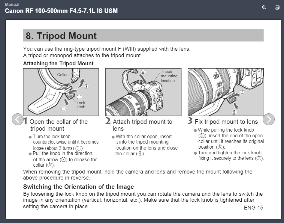

On a more interesting note, I just looked through several Canon lens manuals to see what they say about operating the tripod collars. I looked at the EF 70-200's, the EF 100-400's, the EF 400 500 and 600mm primes, the RF 400 and 600mm primes, and none of them say anything about needing to keep the tripod collar adjustment knobs tightened down. Which would lead me to believe that there is not an issue in keeping them loose. If it was an issue (causing damage to the lenses and repairs), they would likely advise against it in the manual.
So then I checked the RF 70-200, and the RF 100-500, and each of their manuals have a warning stating "make sure the lock knob on the tripod mount is firmly tightened." Also in the "Tripod Mount" section it states "By loosening the lock knob on the tripod mount you can rotate the camera and the lens to switch the image in any orientation (vertical, horizontal, etc.). Make sure that the lock knob is tightened after setting the camera in place."
Coming from the EF 100-400 IS II, I just assumed I could use this (upgraded) lens the same way I was using my old one. Unfortunately I cannot. Canon obviously put those statements in the owners manual to cover themselves. I really wish more reviewers would cover the dangers of misusing the tripod collars on these lenses in their reviews. It's my own fault for not reading the owners manual, but let's be honest, how many people read their owners manuals....

The tripod collar on the RF 100-500 (which I own) and apparently the RF 70-200 f/2.8 (which I do not own) are very similar in operation to the collars on several EF lenses, including the EF 400 f/5.6, the original non-IS EF 300 f/4 and the original EF 70-200 f/4 IS, all of which I own or owned.
With all these EF lenses it was my custom to tightly close the knob after loosening and rotating the lens. I never had a failure with any of these EF lenses, which I customarily carried while attached to my tripod, which in turn was carried over my shoulder.
