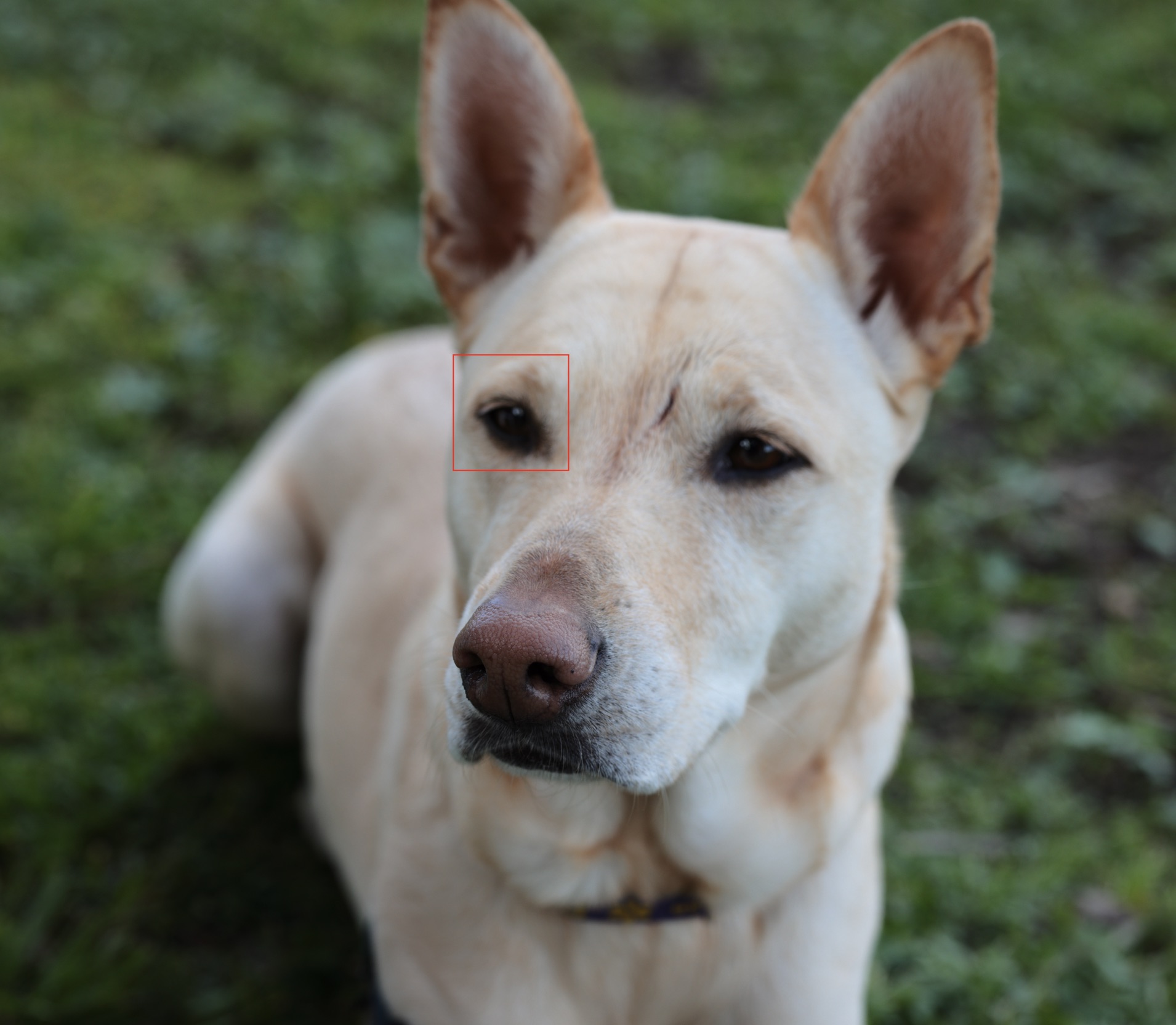

The AF assist lamp is on, not that it matters as it would never turn on in this circumstance, and the lens and camera were perfectly capable of acquiring focus on the eye and the nose repeatedly.
To follow up on why the video was dark, I had accidentally left the CLog Gamma and BT2020 settings used for recording video on, and the output for the viewfinder is standard rec709. Whoops.
I took a bunch of videos today testing out various lenses. It frequently jumps to focus on the nose using any lens I tested with (RF 35mm f/1.8, RF 24-70 f/2.8L, RF 70-200 f/2.8L). However, it doesn't get stuck the way that the RF 50mm f/1.2L.
The RF 50mm f/1.2L exhibited the same behavior in broad daylight while doing these tests today.
Here an example of it happening today while we were out. The image was clearly focused on the eye, but the moment before I pressed the shutter button it refocused to the nose and stayed till I released the AF button and reacquired focus. At least for my dog, something very odd is going on.

The nose looks like a little face with nostrils for eyes?
Actually though if you think about this, Canon started with people face detect before eye AF. Perhaps it is reverting to ITR mode and face detect finding the nose and it thinks eyes should be really close to the nose, for people. My theory anyways, but it doesn't explain the lens being part of the equation.

Maybe you should try it on another dog. The Af may be confused as the nose resembles an eye.

I have noticed with my own dogs (Beagles) that if the nose has a better / more pronounced catchlight than either of the eyes then the camera will be drawn to it, especially in low / subdued light. Typically the AF box will show this happening; it's much less common for the AF indicator to be sticking to the eye while the nose is (very obviously) in focus - but it has happened.

So let us know what Canon tells you. If this is a known failure point, they will tell you to just send in the camera. If it is uncommon, most likely they will tell you to reset the camera and see what happens.
Did you reset the camera? Did you call Canon?
I love posting my issues here as I learn alot... but before I get all twisted up in my shorts... I ALWAYS call Canon either before I post here or shortly thereafter. Unless someone posts something like "set menu X item to Y" to make the issue go away, I call Canon too.
Let us know. As I noted before, I think your camera is broken. While all this expert opinion is fascinating, I would still call Canon and after going though more than a few calls with them, I save some time by just resetting my camera first....because they always told me to do that. YMMV.

Even if it is ultimately determined this is just the limit of the AF system with all the variables it must account for, Canon still needs to change one thing.
If the PDAF pixels on the nose are being used for focus, then move the displayed AF box so the user knows where focus is occurring.
Showing the user "Here are the eyes!" while deep in the AF algorithm deciding "I'll pick the nose!" isn't very user-friendly.

Coming to this late. My first reaction after watching the video is the PDAF was losing a lock on the eye. Eye detection occurs in the spatial domain, which is separate from PDAF's ability to acquire. But then I read your post about this occurring in daylight, so there shouldn't be any reason for the PDAF to fail to acquire...unless there is insufficient vertical contrast (irrespective of light levels), which is typically the case for dark eyes but I imagine Canon's algorithm is smart enough to use areas around the eye instead.
Q: Does Canon's eye-detect AF implementation reflect the state of PDAF acquisition in the color of the box around the eye, ie change from one color to another when PDAF fails or succeeds? I'm guessing no from the video but just wanted to make sure since that fact would be useful in determining if this is a PDAF acquisition issue.

If focus acquisition failed the box turns red.
White: not focusing
Blue: successfully focusing
Red: failing to acquire focus

Thanks. So based on what you're observing, the camera reliably detects the eye, indicates it has successfully focused on the eye, yet sometimes switches focus to the nose instead. Btw, how quickly does the camera respond to changes in its focus success (ie, change in color) in your experience?
