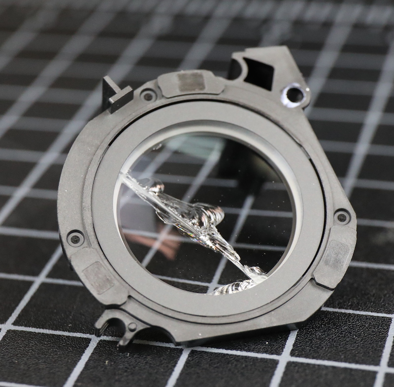

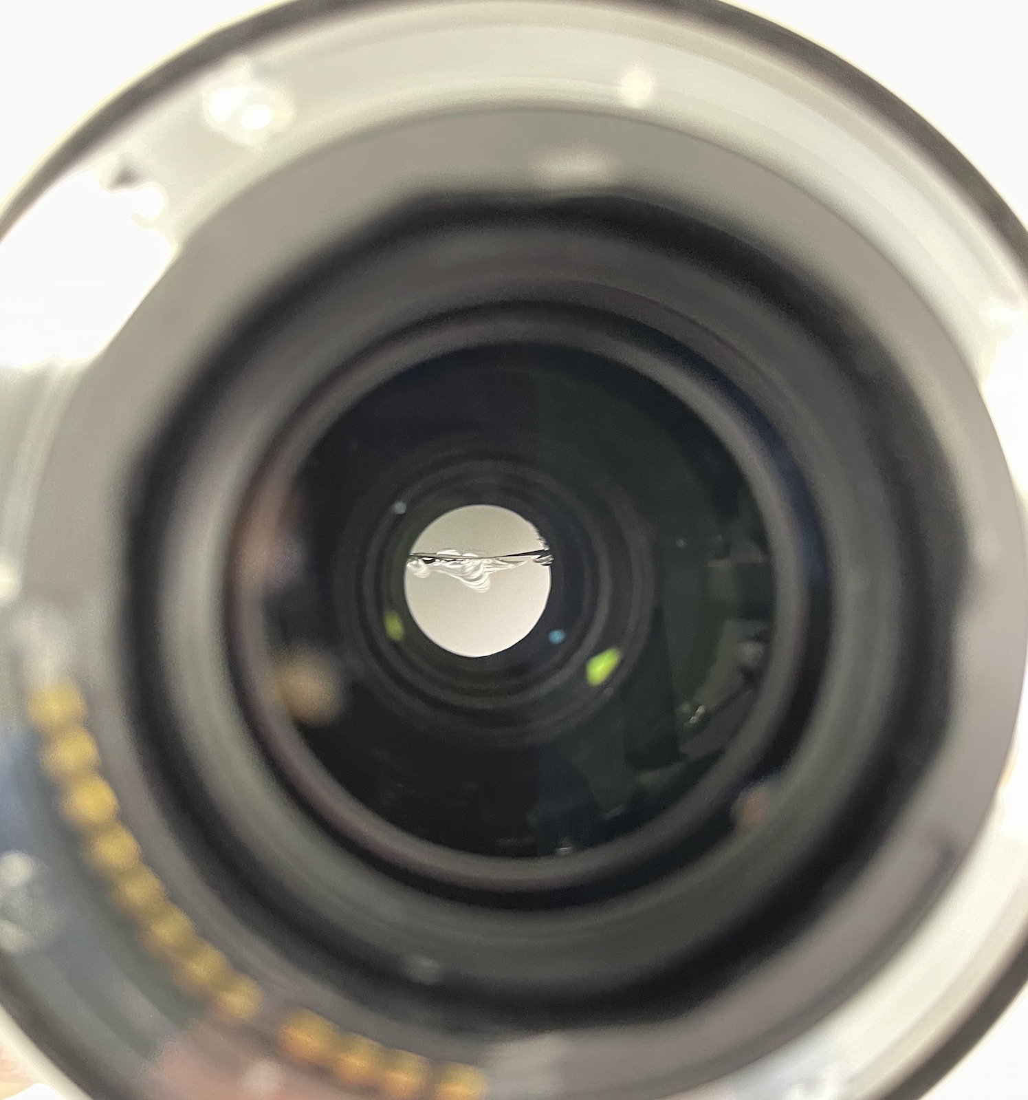

Canonrumors member Yuenglinger has been investigating the IS unit of the 100-500mm flopping around when it is not attached to a R body or when the camera is off or sleeping, and he is worried that it might break. It appears that Canon has removed the parking of these and other R lenses IS units when not in use, unlike in EF lenses where the unit is safely parked. Roger of Lensrentals has answered in dpr that 4 of his RF 100-500mm lenses have had IS lenses crack during transit. https://www.dpreview.com/forums/thread/4546469
This is clearly a worry.
Is that conclusive proof though that 'not parking' was the cause

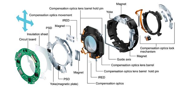

OK, so there is a mechanical device that grips the IS when power is cut off? I know shamefully little considering how many lenses I own that have IS. Interesting that Canon would change their tried and true design.
Yes, there is a mechanism that engages when power is removed. Trust me, I'm right there with you and don't know much more than that about the internal workings of these things. I do recall reading that if you are ever going to ship an EF lens then it is important to ensure the lens is properly "parked" by turning the power off on the body and wait for it to lock before removing the lens.
I don't know why they went away from the old design other than like someone mentions in that linked thread. Weight and cost savings?

Roger Cicala on Dpreview:
There have been other lenses in the past that have been this way. As a repair-centric person I don't like it on the basis of 'no good can come of it'. But we haven't seen astronomically higher damage or anything UNTIL the RF 100-500.
With those, we have no seen the IS glass crack in 4 cases. In all my years I've never seen IS glass crack before. I've seen IS units break, usually from the case or electromagnets coming loose; it's rare but it happens. But never cracked glass in the IS unit.

Before you all get your undies in a bunch, Roger responded to my question about this issue as well and it would appear their FedX guys are rather rough on shipped gear in the first place. I for one am rather gentle on my gear so I'm not losing sleep over all this stuff. It's a superb sharp and well built lens. Here was his response:
No way to park it that I know of. We're going to do some disassembly tomorrow and Wednesday, see if we find anything out.
All of ours happened during FedEx shipping and that's routinely going to get dropped 2-4 feet at various times, so I think a much harsher ride than in the back of your car. We used to put accelerometers in packages and 2-3 Gs was not uncommon.
